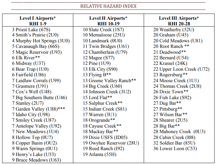

I've had this chart kicking around for a while pretty sure it's from a Boise flying club, over the years I've been working my way from Level I upwards. I've only been in to a few IIIs, and I probably won't get into many more without a CFI or pilot with experience in the right seat. Just not worth trying to cowboy it.
Relative Hazard Index.png (197.83 KiB) Viewed 1906 times
