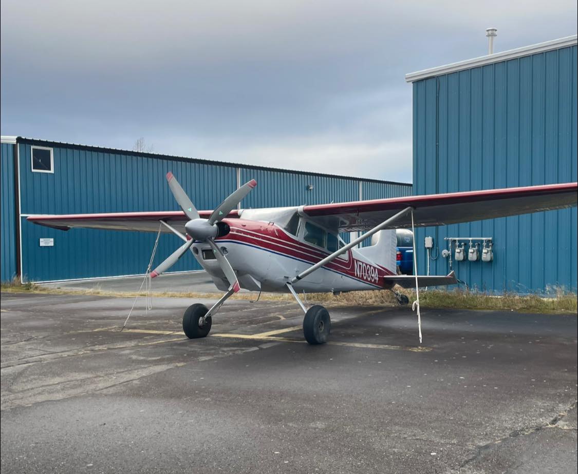

I saved this picture from Facebook I think of an Alaska 185 with TSIO 540. Looks pretty cool to me!!!!!
