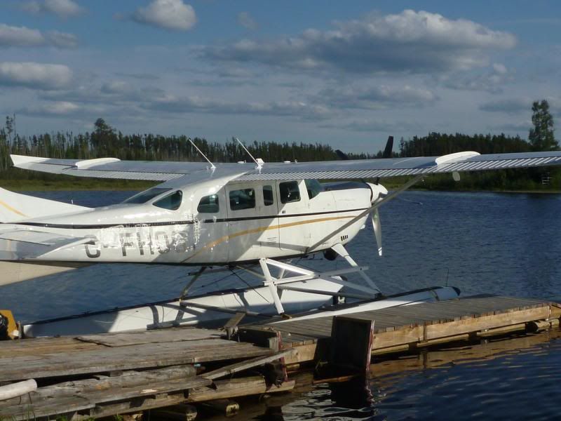

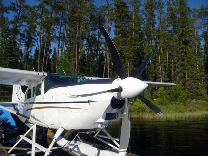

Speaking of slow throttle response I encountered this C206 turbine again at a fishing camp in northern Ontario. The owner had a prop strike when after pushing off from the dock the wind turned the plane back toward the dock before he could spool up the engine and get the prop blades out of flat configuration. It was a minor prop strike, but that's all it takes. He replaced the original three blade prop with a five blade one because the blades are shorter and gives him more ground/water clearance.
Five blade prop.

Hartzell makes a flat pitch lock prop for that application. I do not know if MT does but my next prop for the PT6-206 may be the MT for the weight. That prop in the photos was expensive if I remember, +50K? I have been flying an Amphib 182 on my days off, been a long time since I have been boating and I have litte float plane time but doing ok in good conditions. My fantasy was to have put this plane on floats but I may already be board flying from bar to bar and only drinking water.
