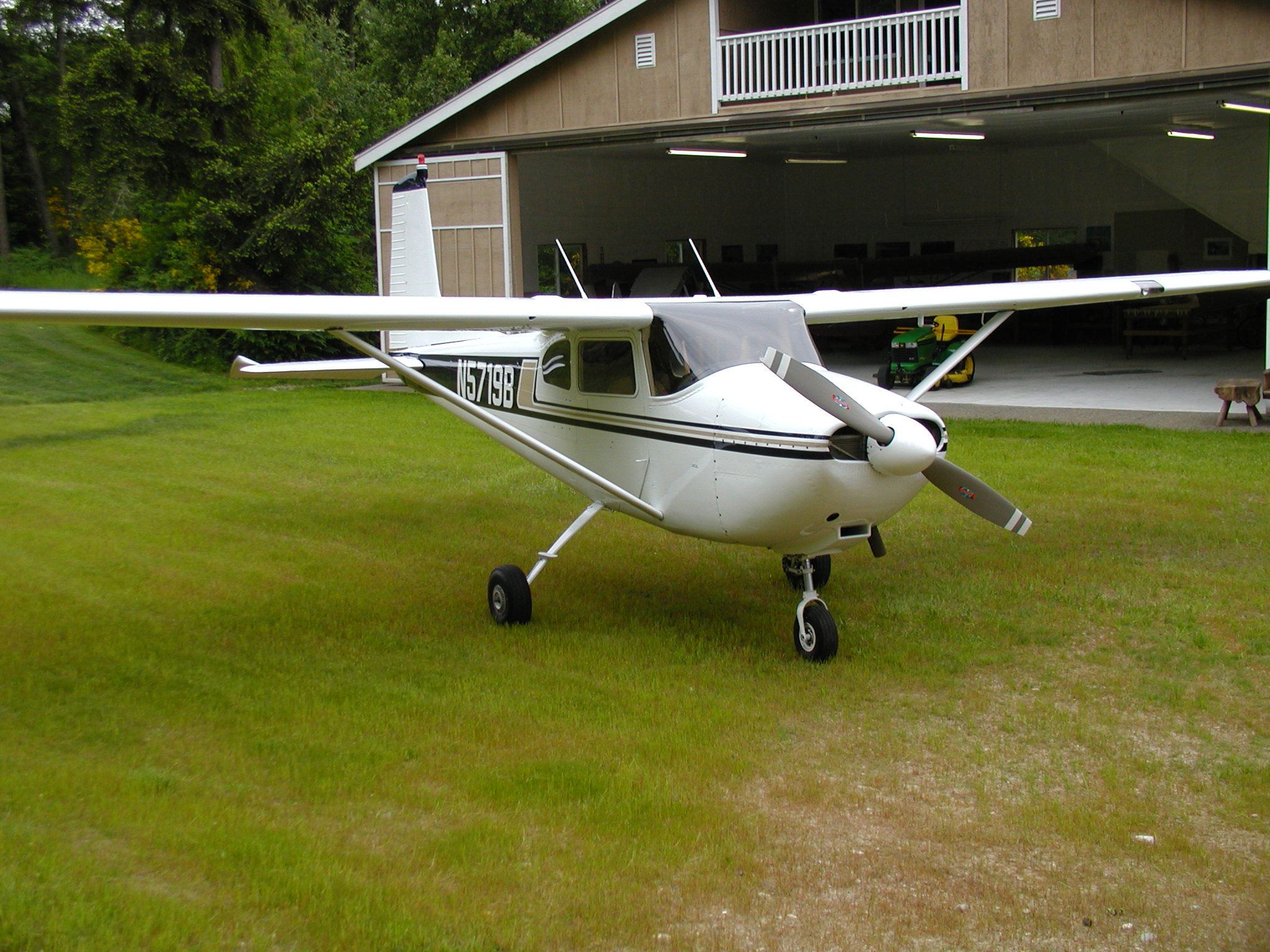

I had a 56 182 for several years - great airplane. I liked the tall gear, never had any issues with the gear being narrower, flew it off grass the whole time. Also no problems with the float style fuel gauges, put a EDM-700 in and watch your time - no problem. The no cowl flaps aren't a problem concerning engine temps or operationally but the large cowl opening is a drag source, so stock it was a 120 MPH airplane if I recall.
Mine had been a jump airplane and had the swing up RH door which I kept as it was a nice loading feature and you could open and close it in flight just for fun.

Nice looking place-- Flying H?
Re: Questions about straight tail 182's
Thanks. Vaughan’s Ranch near Port Orchard. WN13
