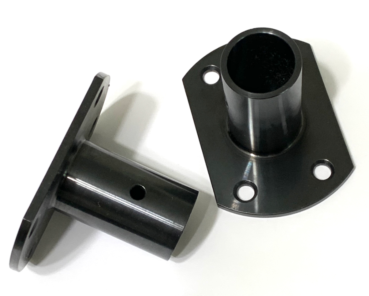

The parts arrived from the machine shop today. They look great! Boxed and shipped the first 5 sets tonight. Unfortunately I'll be leaving for a biz trip shortly and won't get to install/try out until I get back later in February. I'll keep the thread posted with results.

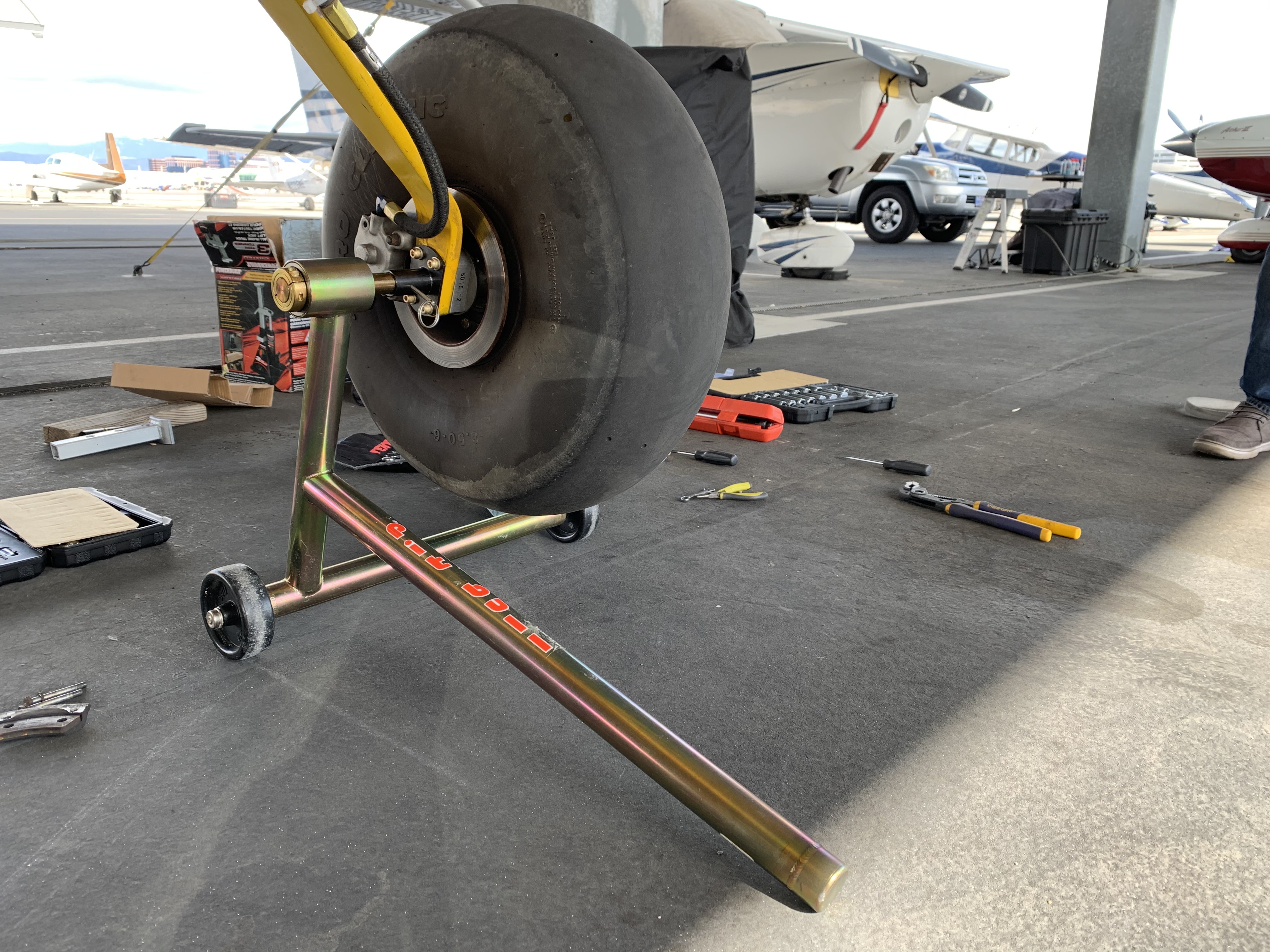

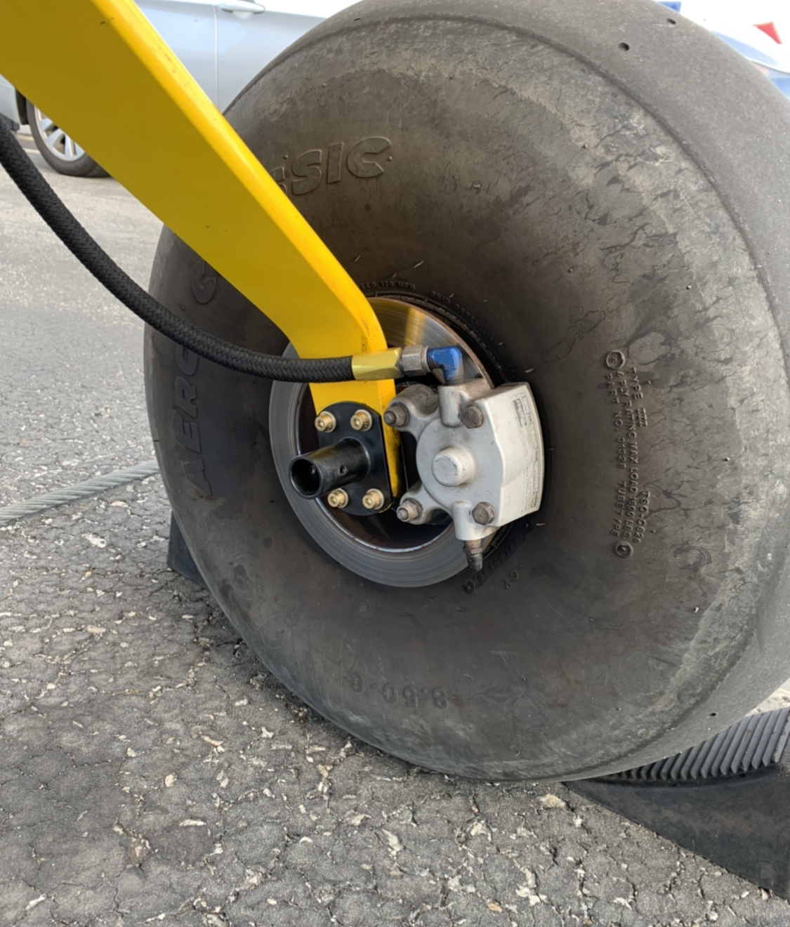

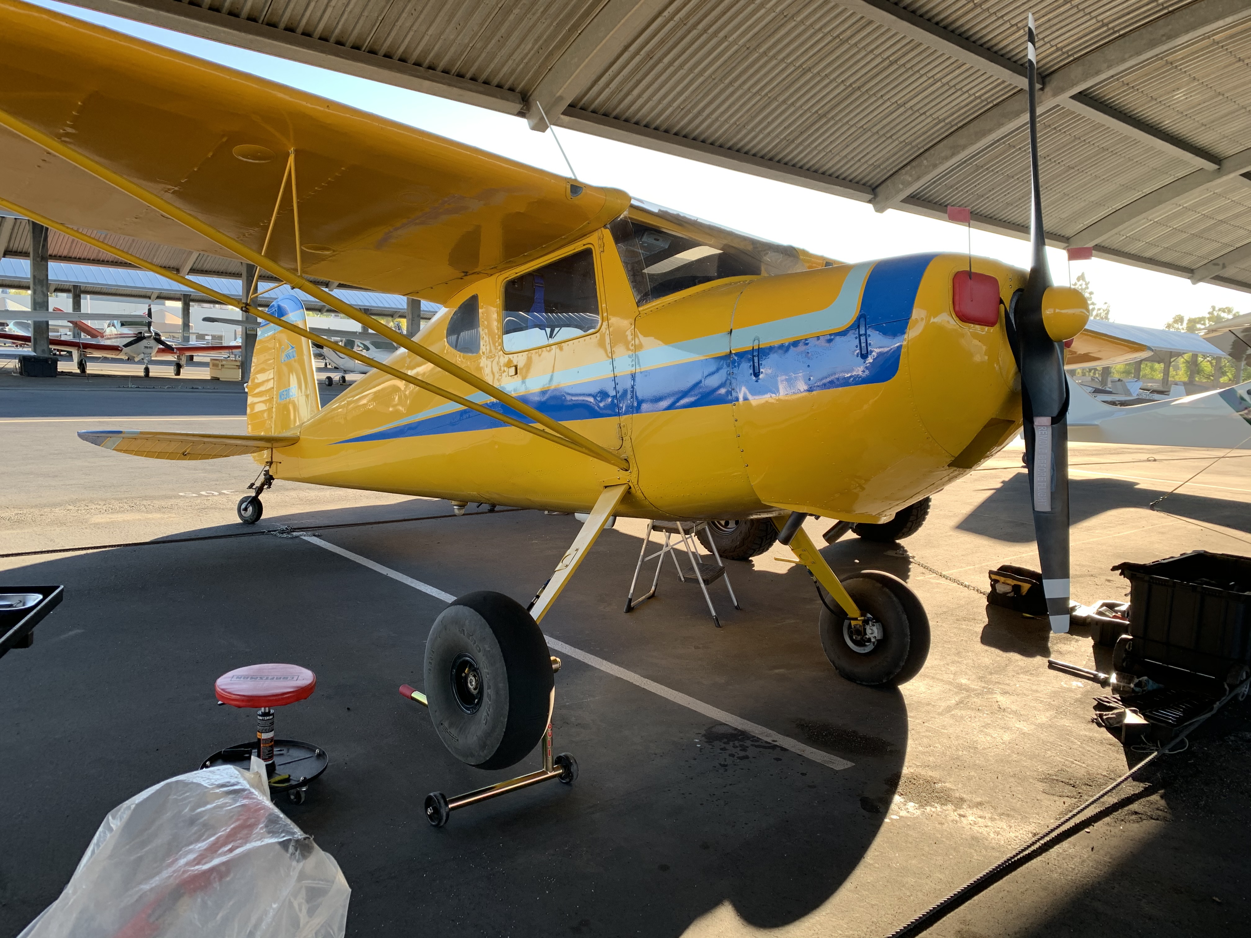

I had a 2 week business trip and wasn’t able to install the parts until this weekend. Everything works great! The motorcycle stand could use a little longer lever arm to get it over and up on the stand, but that’s an easy fix. It does jack it up way higher than I actually need, but I guess that gives me some growing room if I end up with bigger tires.
I have 5 more sets of the plates if anyone else wants a set.

Did you have to use longer axel attachment hardware to compensate for the plate?

Hammer wrote:Did you have to use longer axel attachment hardware to compensate for the plate?
I was using 3 washers before, with the plate I got away with a C4 washer under the head and a standard washer under the nut, with 3-4 threads showing. The bolts are MS20004-28.

I think I'm going to try these wheels out from pro eagle. They make pretty aggressive off road racing jacks.

Anyone else get a chance to install/use these yet? I repacked my wheel bearings the other day, came in very handy!

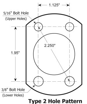

flyer wrote:Do you have any of these plates available? Will it fit my 182B? What is the cost? Thanks Dick
I think I have two or three sets left. This isn't a for sale thread so I'm trying to not get salesy here, PM me if you decide you want a pair, I'm selling at my cost + shipping. Making multiple sets brought my cost down so I'm passing it along.
This is the bolt pattern, except with 1/4" holes. You can drill them out to the correct size if your axles match.
