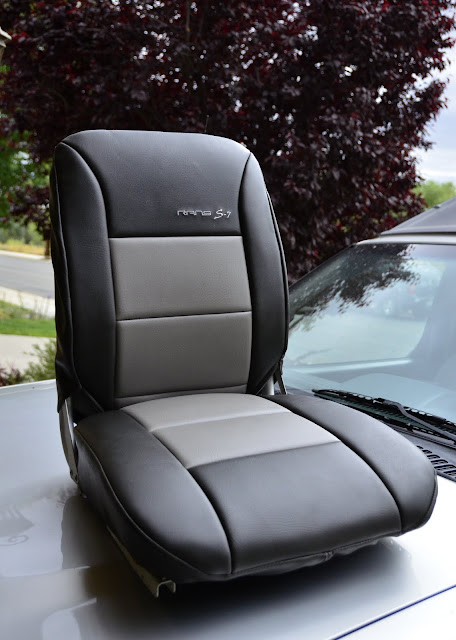

Here's what I did. I have been using the portable Oregon Aero cushions for a while in my S7, but never really liked the look of them sitting on the seats, or of the stock S7 seat for that matter.
I had seen some of the custom seats done by Oregon Aero for the S7 but they expensive. I had already invested in the cushion, so....
I went to a local hot rod upholstery guy and showed him a few pics. The idea was to just take the cushion material (seat and lumbar support) out of the OA pads and just incorporate them into the stock seat with a new "pleather" material. I also had him set up to embroider the the Rans S7 logo.
Here is the result. He essentially made slip covers that tie on the bottom using a similar process as the stock seat material - a plastic coated cable and pins.
It was only $125/seat. Embroidery was $75, 60 of which was the one time set up fee!
I am not sure of what OA uses in the portabel cushion, but they are comfy and there is probably a science behind their specific composition.

Those are sweet Emmet! I really need to do something. My back was hurting after my Hour and a half cruise home from Chico on Saturday. I got my ANR kit today. Hopefully between that and a softer seat I won't be a walking zombie after our 8 hour day to Idaho next month.
