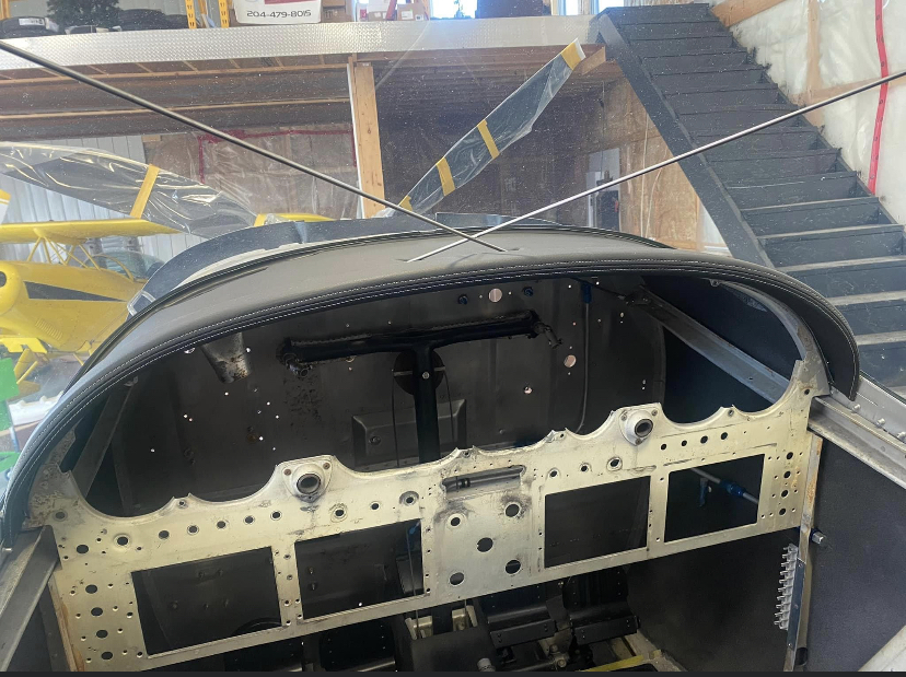

Anyone make a good professional OEM looking under lip light strip for the glare shield?
Posts: 1679
Re: Selkirk EB and Glare Shield Install
Found this pic on another site. Already asked there for the manufacturer...
Anyone here who can provide a vector?
