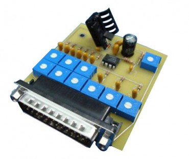

It seems that the FLIGHT DATA SYSTEMS AP-60 AUDIO MIXER from Aircraft Spruce for about $85 dollars solves the problem. For one person no intercom is really needed.
http://www.aircraftspruce.com/catalog/avpages/flightdataAP60audiomixer.php
Flight Data Systems - AP-60 Audio Mixer
Why Spend $1000+ and Precious Panel Space on an Audio Panel when all you need is an AP-60? An Audio Mixer is Required any time there is more than one Audio Source. This unit mixes and amplifies six audio inputs. Mounts behind the instrument panel. Mixes and and Amplifies Six Audio Inputs.
For Example:
Communications Radio Audio
Navigation Radio Audio
EFIS Warning Audio
Music Player Audio
Traffic Warning Audio
