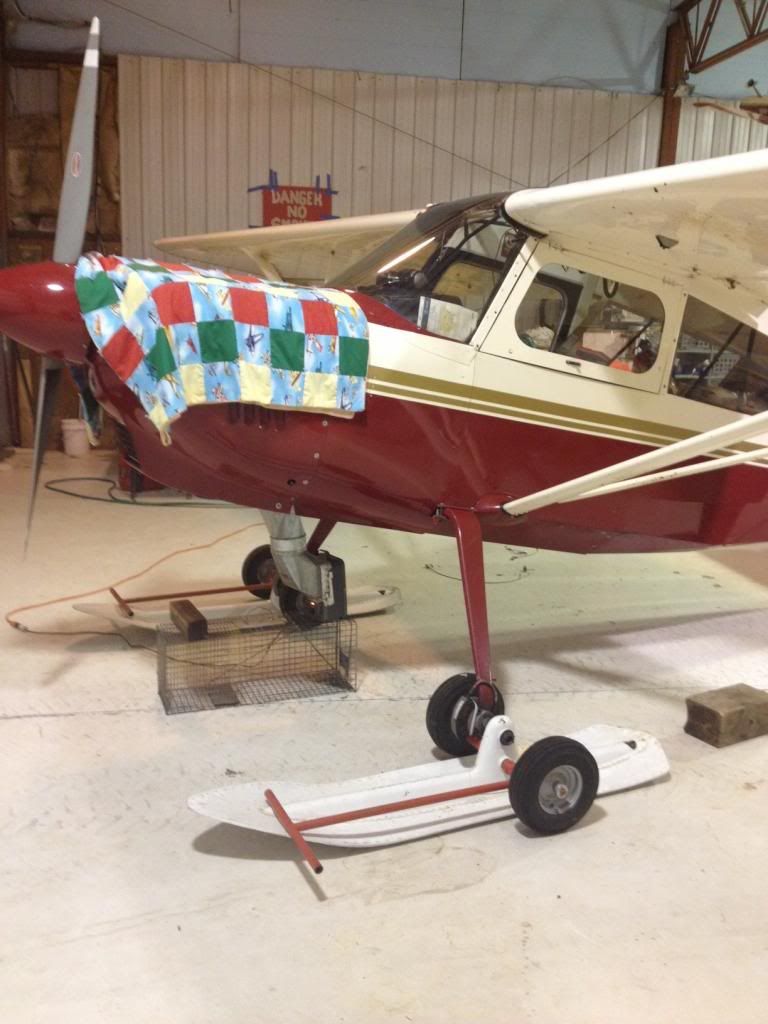

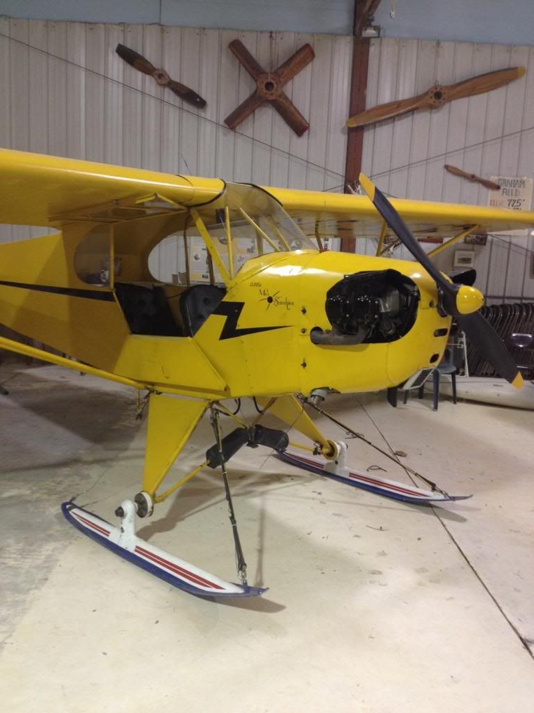

Tom - I have two different sets of dollies. The scout has dual wheels (see picture) and the cub has single wheel dolly. (see photo for the dolly hole). They could be easily made, but borrow a set to copy exactly so the over center part works right.

The dollies I made for the cub used 800x6 tires. I wanted to cam over center to raise the skis off the ground but I also wanted the wheels to lift up high enough to slide in or out easily when the skis were down. This is most easily achieved by not using the lower axel hole with the Aero skis but rather going through the axel itself.
