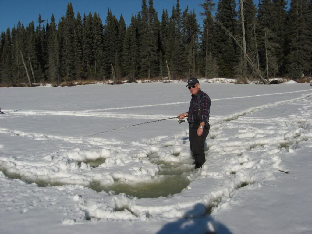

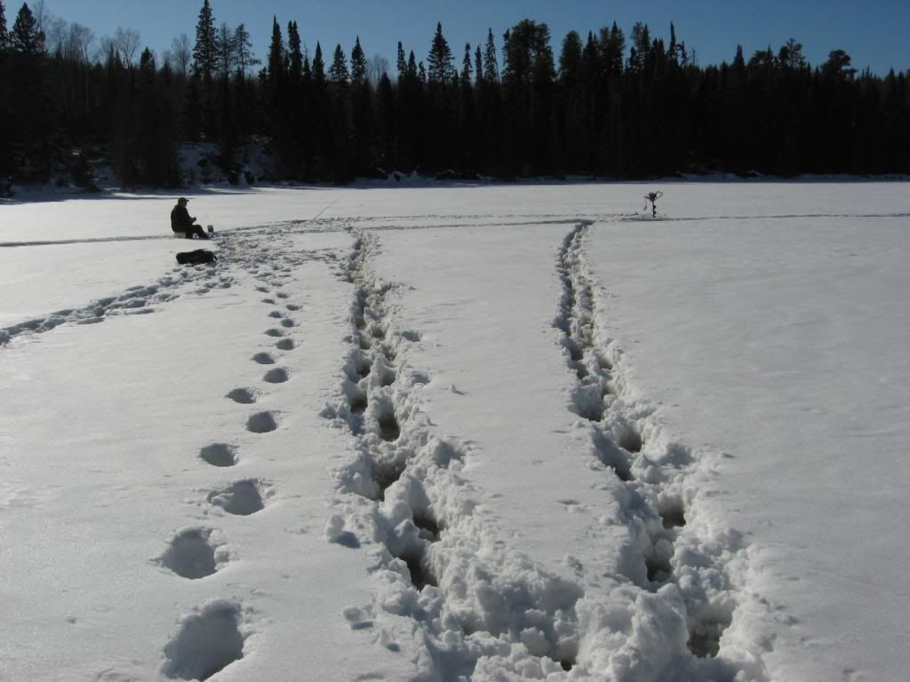

A few more minor overflow examples:
and of course there is always just plain old thin ice and or open water...
