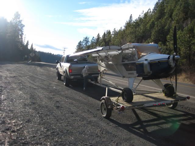

Time to bump an old thread.... this poor airplane still has not flown. I just went to Idaho and rescued it over the Thanksgiving holiday. I towed it 900 miles on a trailer back to Cali. It needs alot of restoration type work to get it going. Is there anybody on the forum that is good with fabric? This thing was covered in Ceconite and painted with cheap paint. It has a bunch of the swirl type cracks in the paint and some holes that need patched. I have ZERO experience with Ceconite. Any help would be great.. I'll be reading my butt off trying to learn.... you gotta start somewhere I guess.
AvidFlyer offline
Posts: 1351
Location: Fairfield
Couple of recent photos...
One it's way home from Idaho
In the garage
