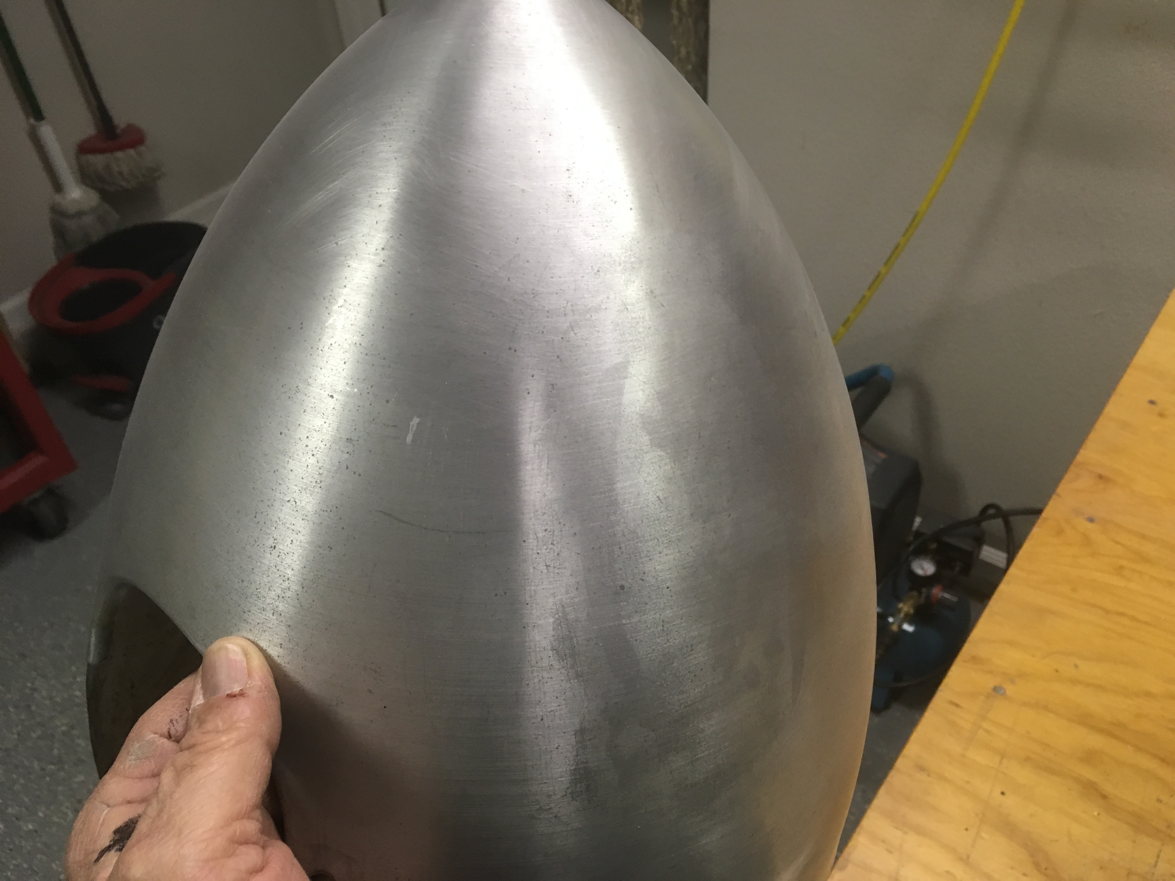

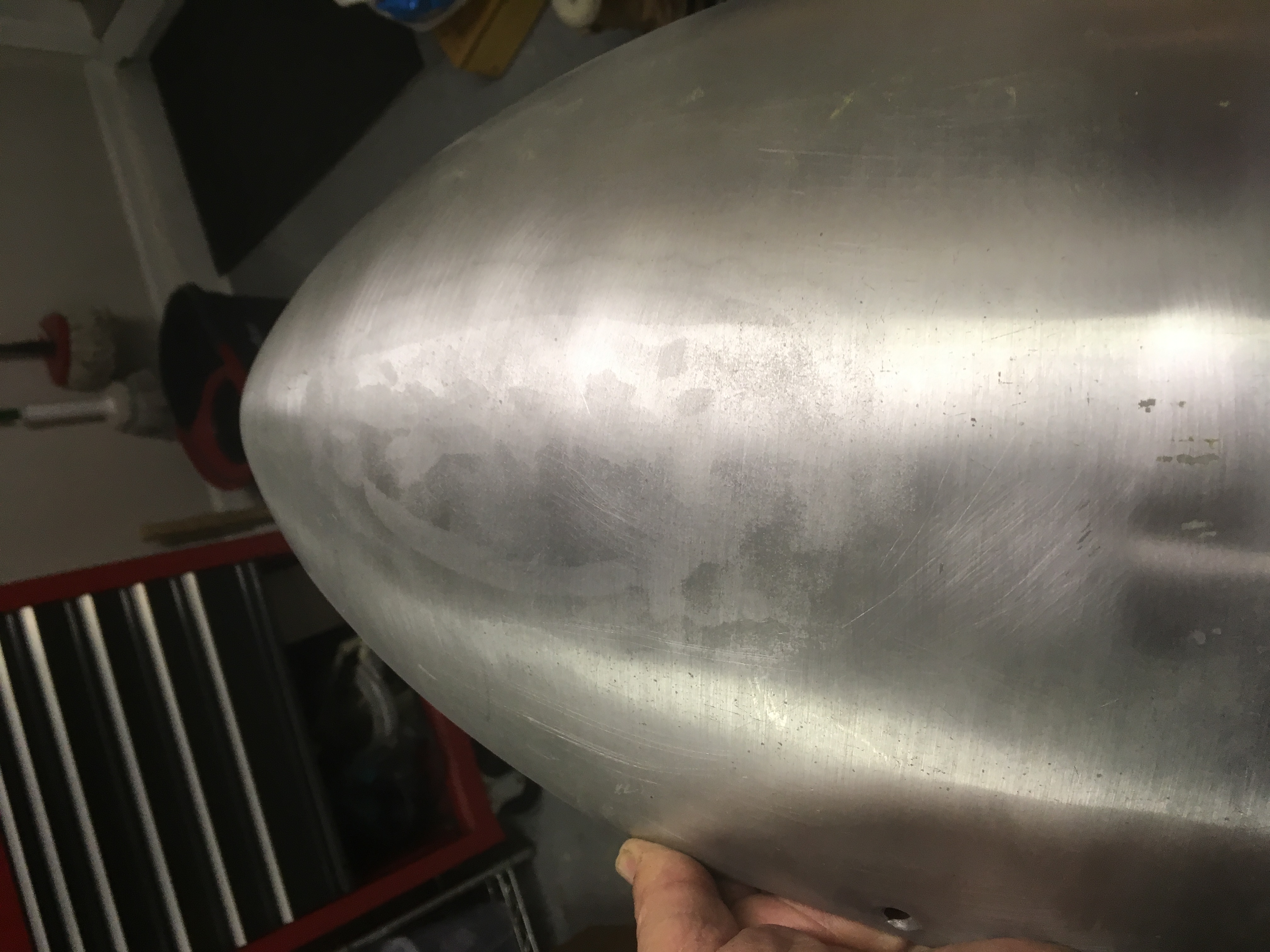

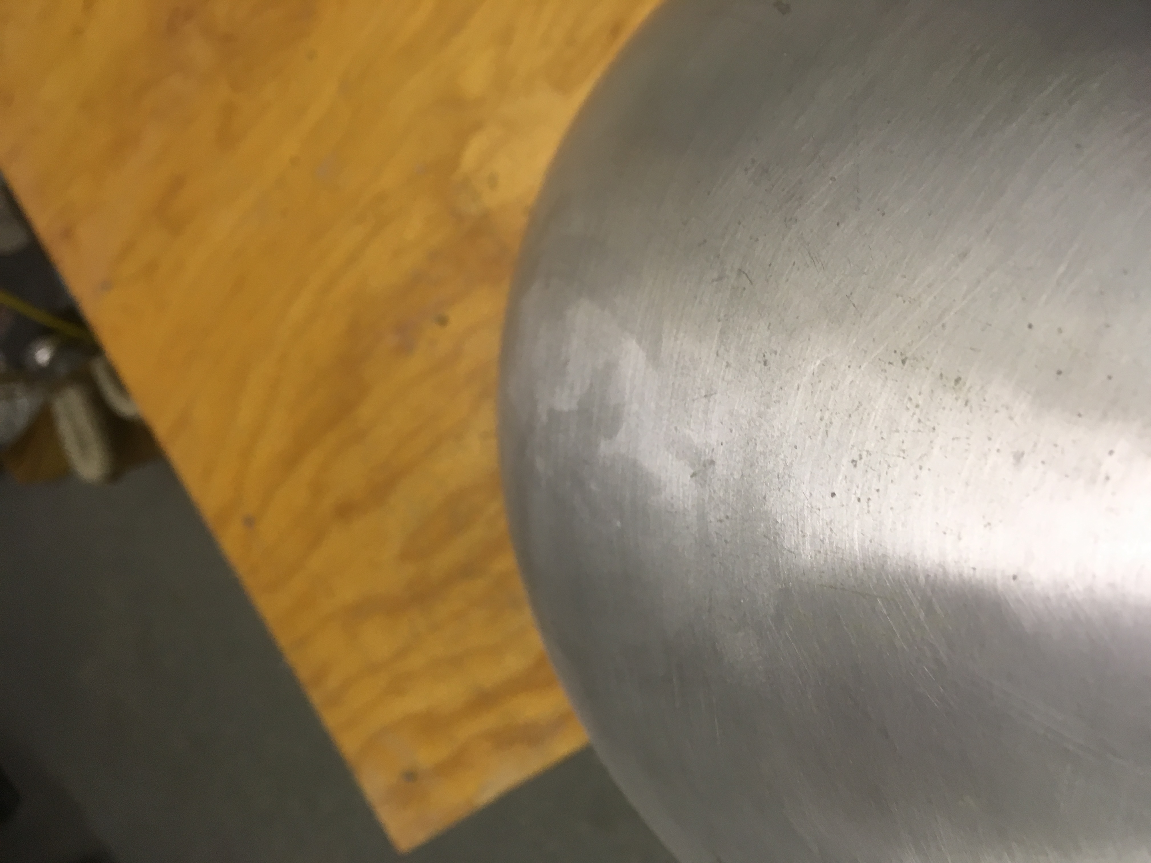

I got my spinner back and they did an awesome job on the repair. They also welded a couple cracks on 2 of the forward holes. Cessna sent it to K&K Precision Welding in East Troy, WI. Highly recommend! Close to you Newbizor!
They only stripped enough paint for the repair. I stripped the rest when it got back. Prime and paint soon.
