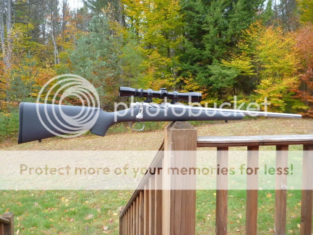

I had a 7-08 complete build done on a Remington M-7 action and a Sako Vixen re-barrelled from .222mag. to 6X45. It must be incredibly satisfying to be able to thread and chamber your own barrels. What barrels and reamers are you using? The .35 Whelen is a classic and one I'd like to own.
Here's the 7-08
I've since changed the scope mounts to Talley Lightweights. It'd be pretty cool to be able to make your own.

Sure does show some promise, pretty impressive for break-in loads. What a great caliber. I'd love to see a full picture of the rifle.

fshaw wrote:Sure does show some promise, pretty impressive for break-in loads. What a great caliber. I'd love to see a full picture of the rifle.
Finally painted and worthy of the full monty:
