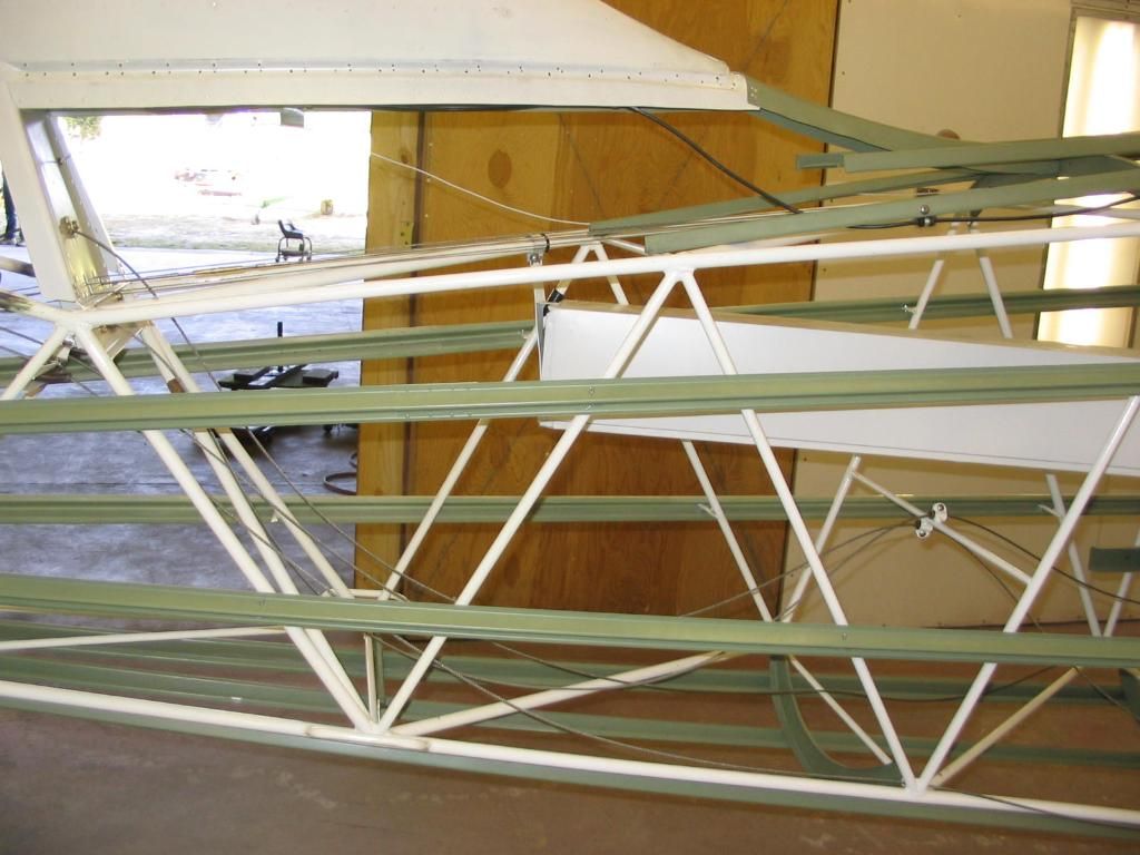

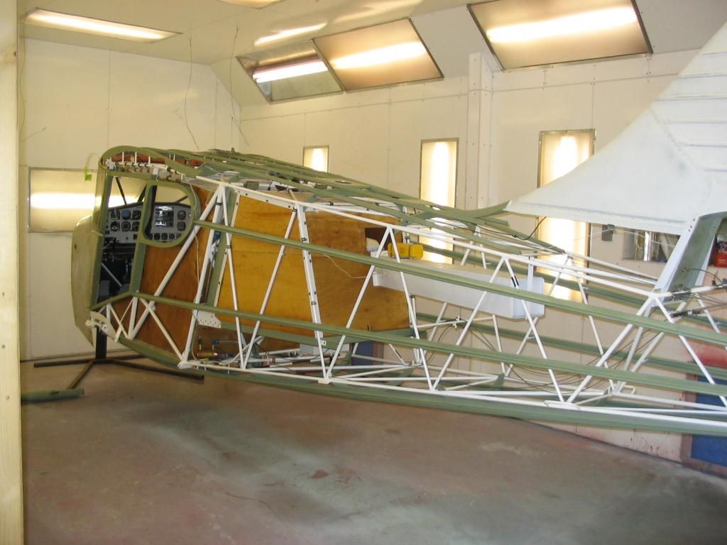

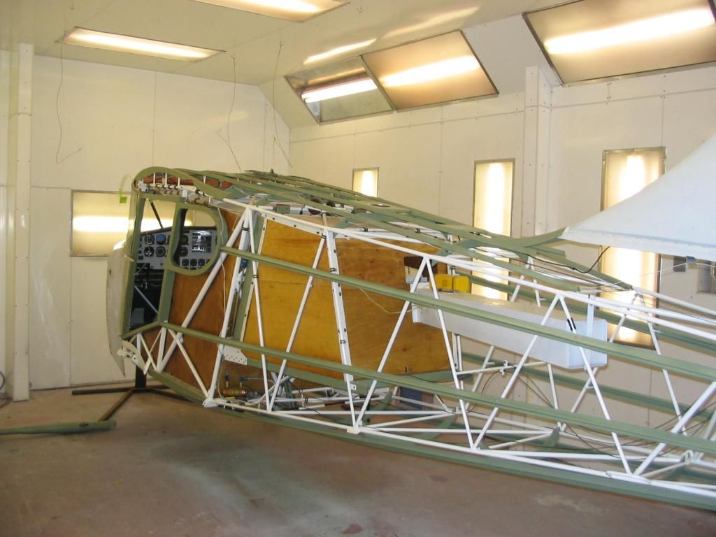

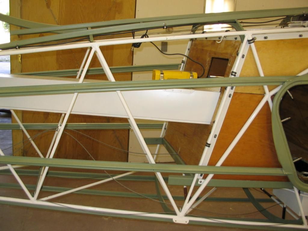

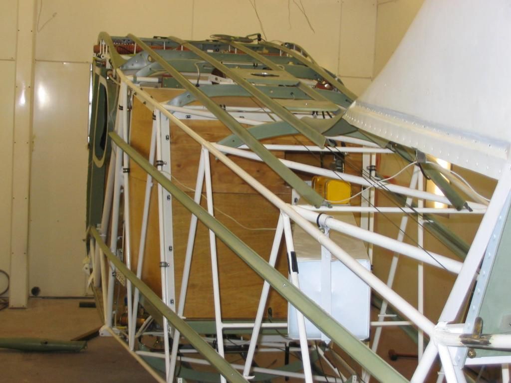

A Stinson I did a while ago....

That's great!! Will help out my efforts ALOT!
