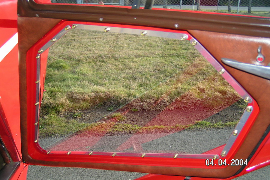

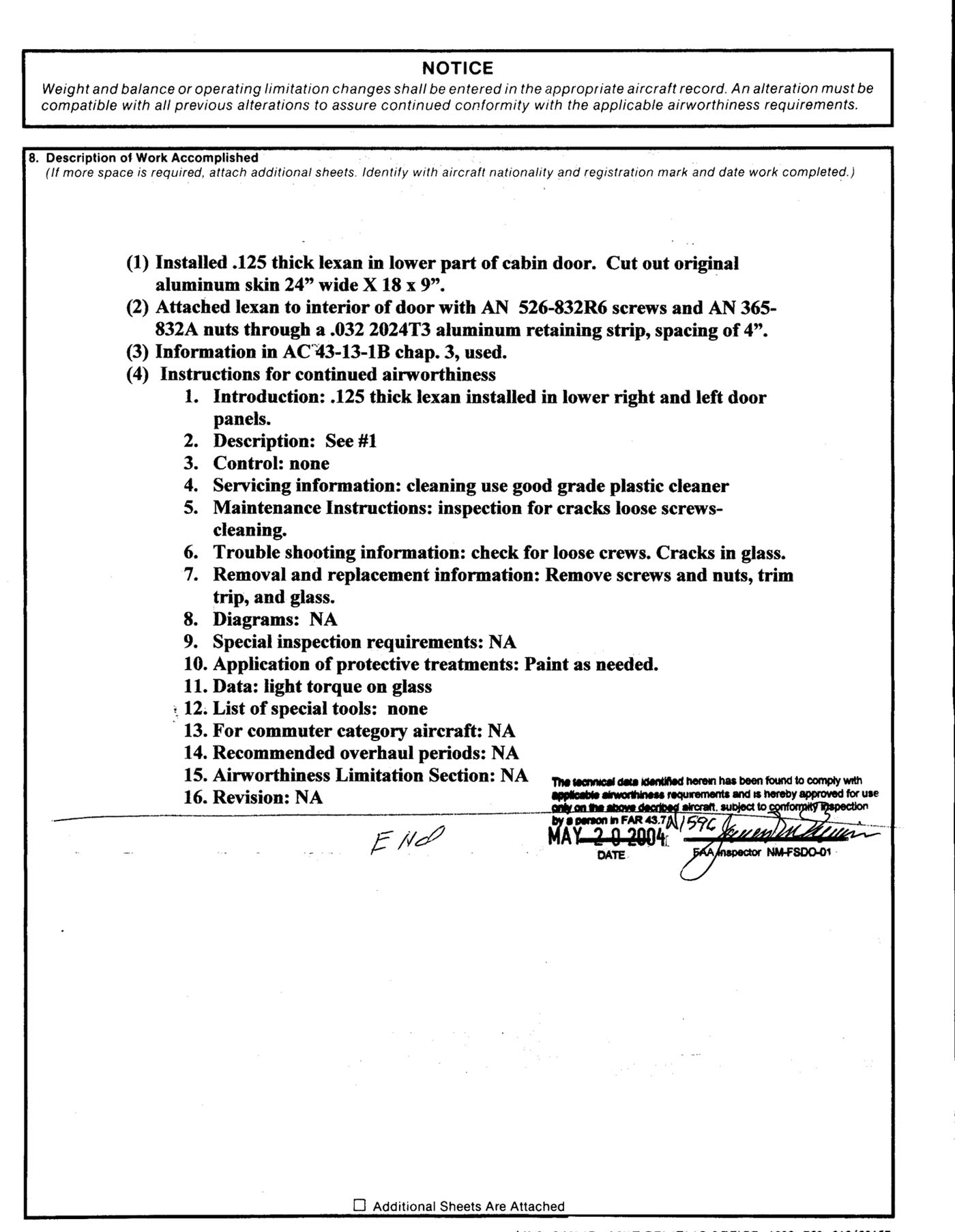

The interweb is replete with pictures of 108's with patroller doors --from the outside. What I'm having a bit of trouble with is finding good detailed drawings or photos from the inside of the door to show some of the finer details of the process. After some digging I did come up with an example 337 from Alan Barnard's plane but I couldn't find any supporting drawing.
Do any of you guys or gals have detailed drawings/pics/337's that you wouldn't mind sharing?

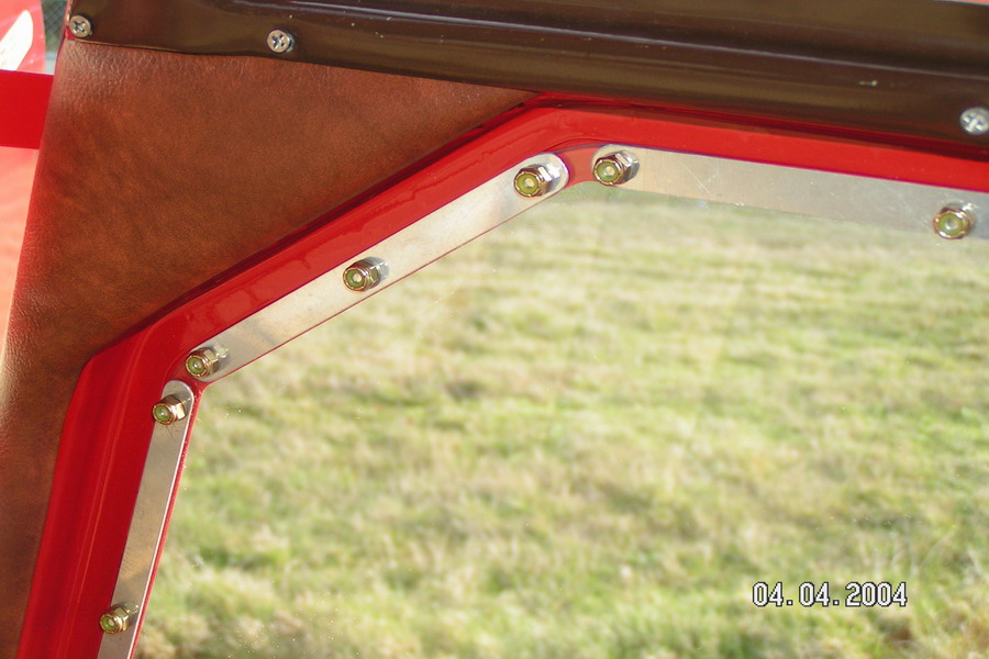

The 337 has some measurements on it. Attached page 2 of the 337 and some photos from the inside. If you need more I can take some pics and stuff from my doors. I've only had the holes cut out so far, haven't done the lexan or any drilling yet.
Re: Stinson Patroller Doors (and other awesome mods?)
Hey thanks Jason. That’s exactly what I was looking for. Sadly it illuminates the fact all Stinson 108 doors are NOT created equal. Seems that the doors like you have and the ones in the pics above didn’t show up until serial no. 108-1990. The earlier doors like mine weren’t reinforced in the same manner thus not nearly as straight forward to cut window holes in. Sooooo I guess my options are to procure $ome later model doors or figure out how to reinforce mine
Anybody seen it done on an early model?
Thanks again for the reply Tadpole!

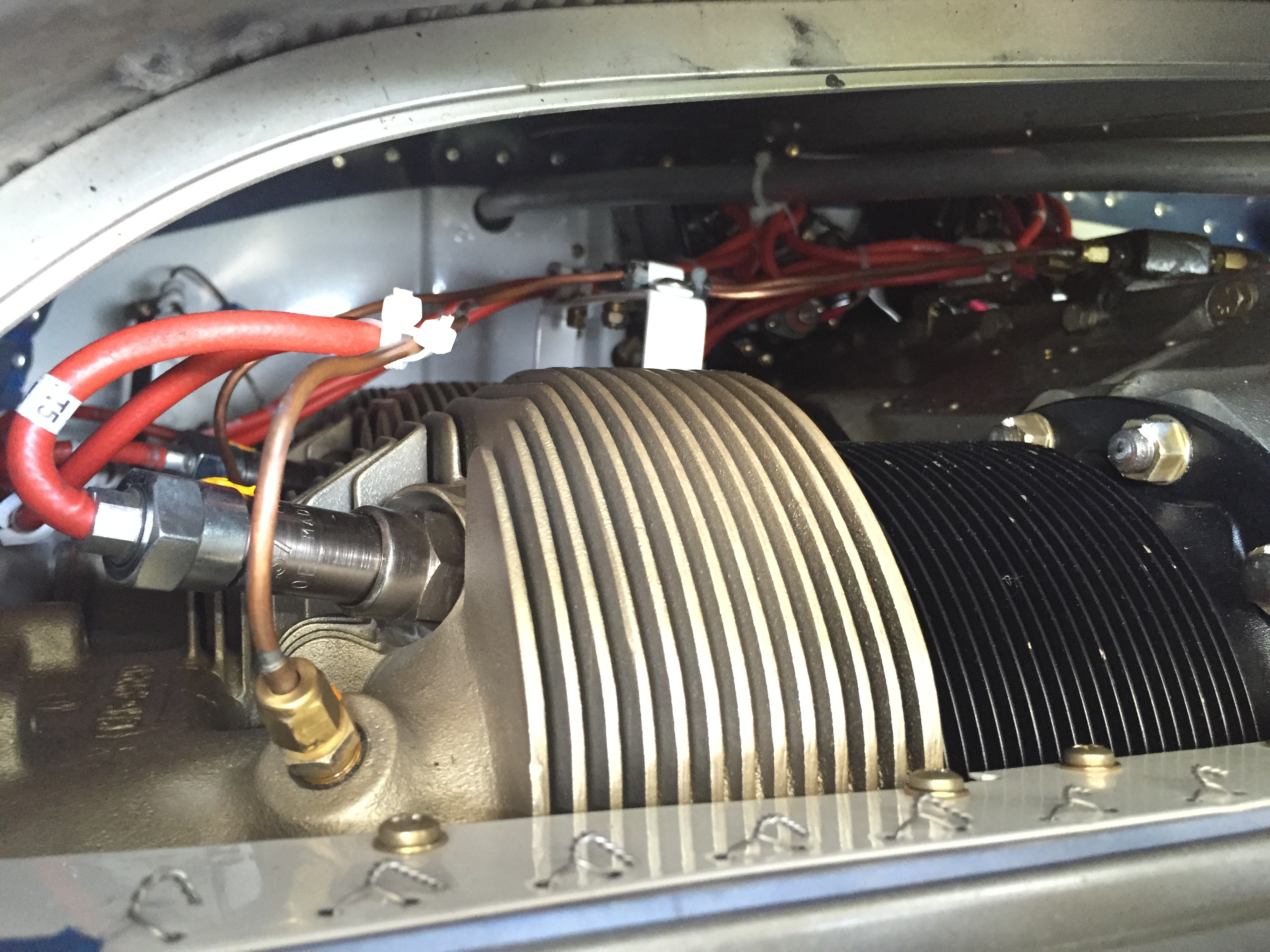

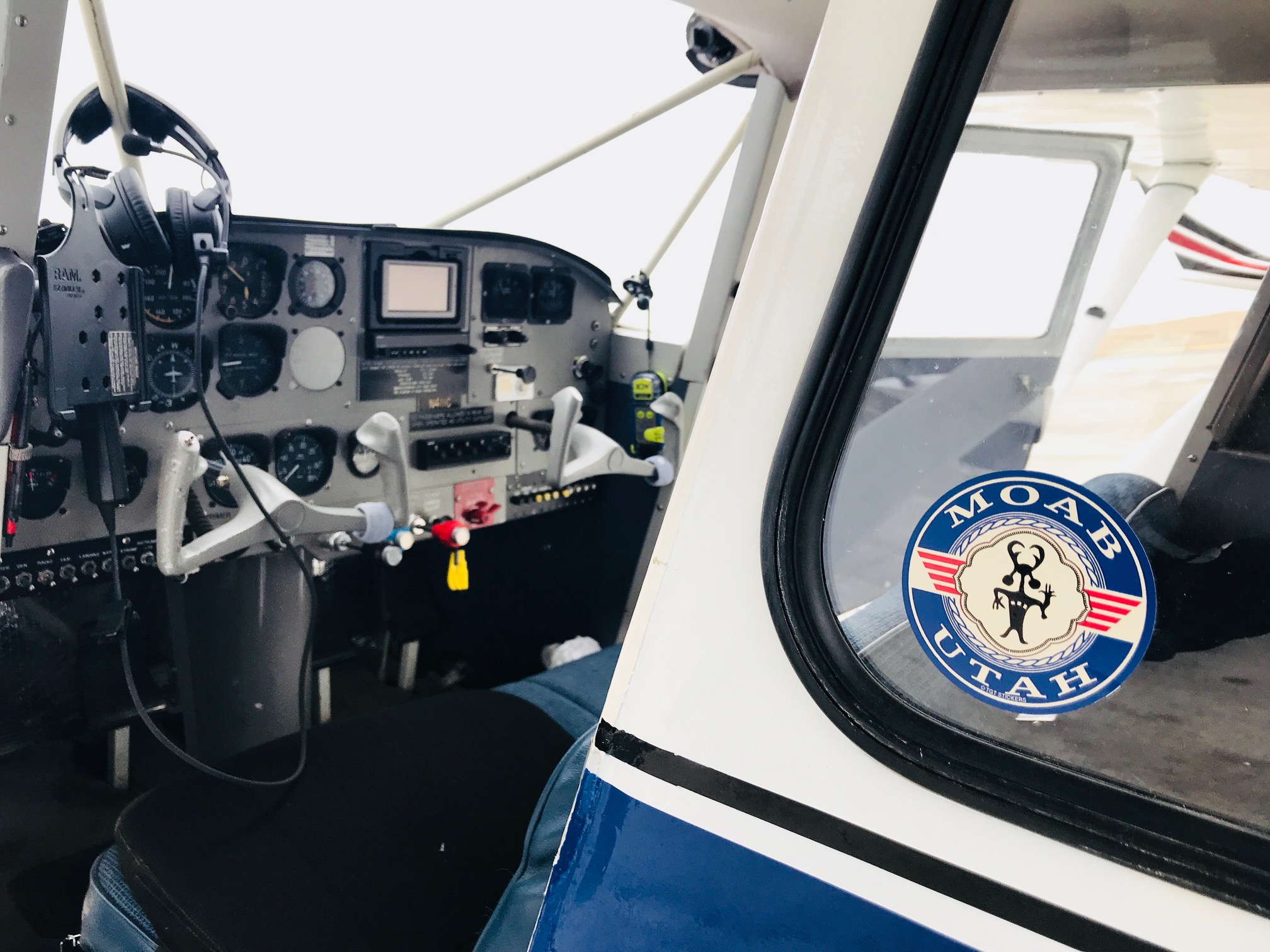

Looks like you have a great airplane.. I just sold my 108-3 with O-470 STC and I miss it already but could not justify keeping it and a 180. The only thing I did to mine was the large engine and tires and could not have been happier.
We had it on 8.50s for a recent trip to Utah but the new owner in AK has it on bushwheels and sent me a photo last week. Said he is seeing 125mph at 23/23.
They are great airplanes! A few photos attached.
Will
