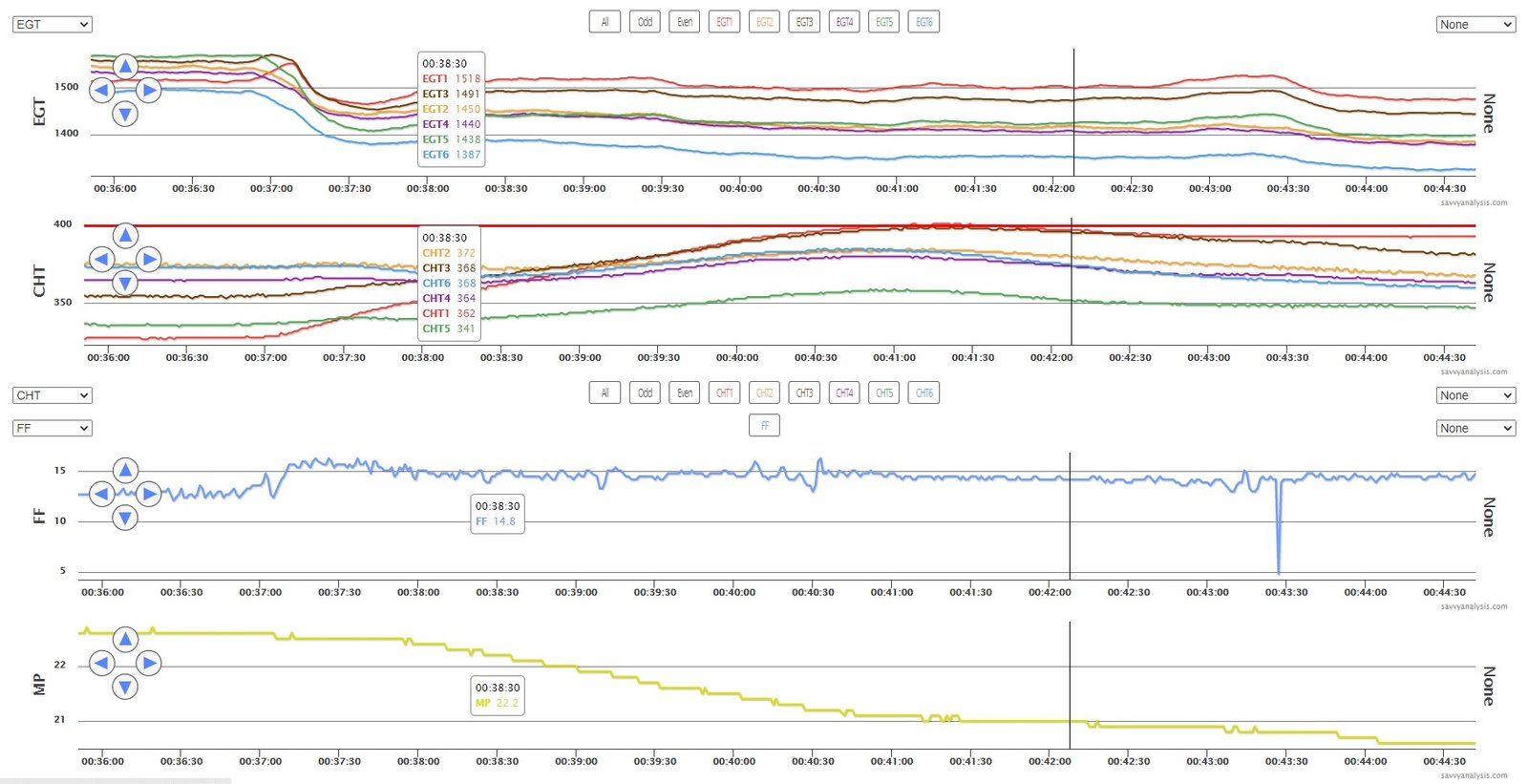

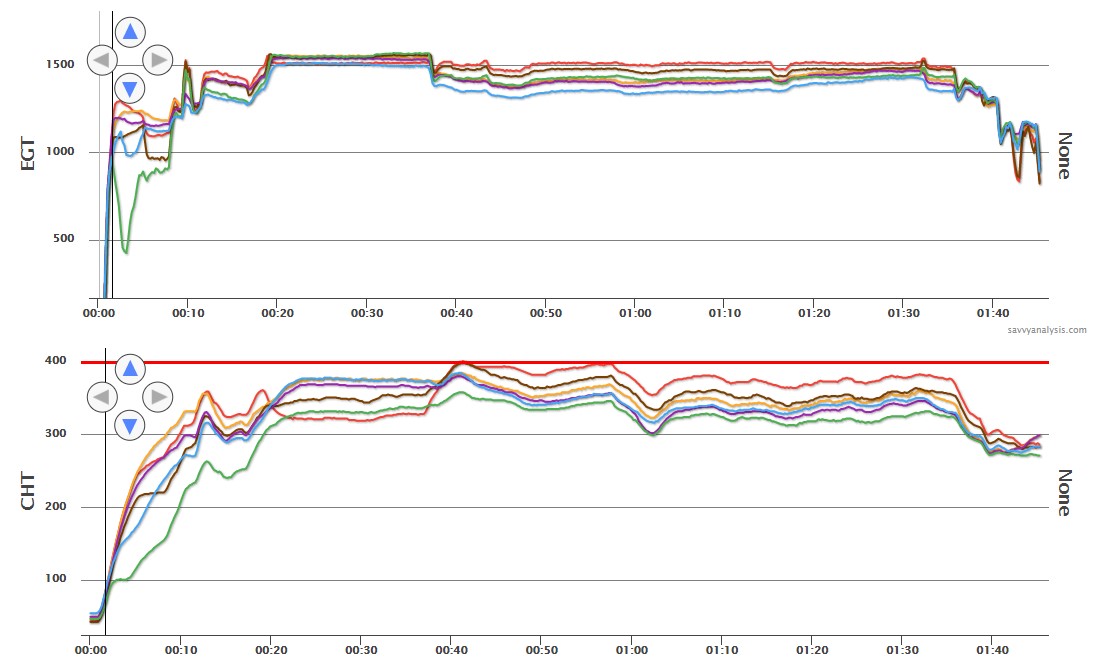

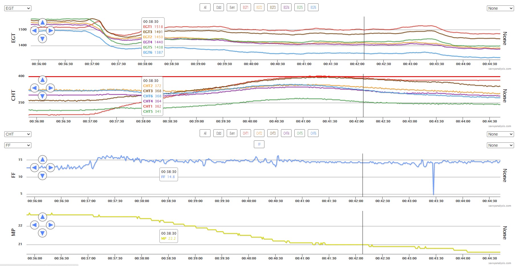

I'm a total dummy, I thought you had to send it in for them to analyze it, I didn't realize there was a tool on the dashboard to run the trends. I just did that, here is what it shows, you can see the event at about 37 minutes:

I'm a big fan of the Savvy service. I put an engine monitor in a year ago and signed up for their QA package. The info I've gleaned from the monitor and their advice has given me great peace of mind running an O-470 that's 2100 SMOH.
Which brings me to your post. I can't help you with the event at 37 minutes, but I'd also ask them and/or your A&P about your #5 (green line). That low, fluctuating EGT on start coupled with the low CHT looks similar to a sticky exhaust valve that I had. I don't think I would have caught that as quickly without the engine monitor, and it would have been way harder to narrow down once I did realize it.

I don't think cylinder one has an issue, per se. Good catch by slowmover on Cylinder 5.
I don't think you mentioned what kind of engine this is - fuel injection or carb? If injection, what sort?
Something interesting is happening about 18 minutes in, looking at the CHT it is obvious that your #1 cylinder has something different to the rest. It gets colder while the rest are still getting hotter for several minutes.
At 37 minutes, it isn't so much overheating, it's coming back up to join the pack.
Perhaps cylinder 1 is the only cylinder running lean of peak - hence the flow test would help.
So if it's running lean, then suddenly getting hotter, that means the fuel flow is increasing and we see this on the trends. All cylinders get hotter, but number 1 gets a lot hotter. So it is probably going to peak EGT. We see this on the trends, the cylinder appears to be at the peak, although we cannot know until the flow test is performed. Do that test at 50% power.
So we know the cause of the issue is not in the lone cylinder, it's affecting all the cylinders. Why does it get richer? Stuffed fuel servo / carb not distributing the fuel evenly.
The alternatives would be airflow is decreasing, or the timing is too early. Could even be pre-ignition if you have lead hotspots or a hot plug.
You aren't leaning the engine when it's running above 75% power output, right? Or leaning to 40* ROP at cruise power above 65%? That might explain damage to cylinder 5, but there are all sorts of reasons for a sticky exhaust valve, overheating is only one. I think it's worth considering, but that is not the whole story.
Overall, I think the fuel controller is having a problem, all the trends point to those. It needs to be investigated.
Also, your fuel flows to each cylinder are not matched as cylinder 1 certainly appears to be running lean of peak when the rest are rich of peak in the cruise. Running this close to peak EGT will give you hot cylinders and can place a lot of stress on the engine, including the possibility of detonation. It may even explain the damage to cylinder 5.

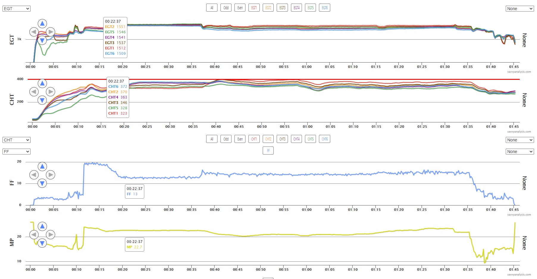

I hope you get it fixed. Here's a recent flight on my O-470. Maybe it'll help you analyze yours better.
