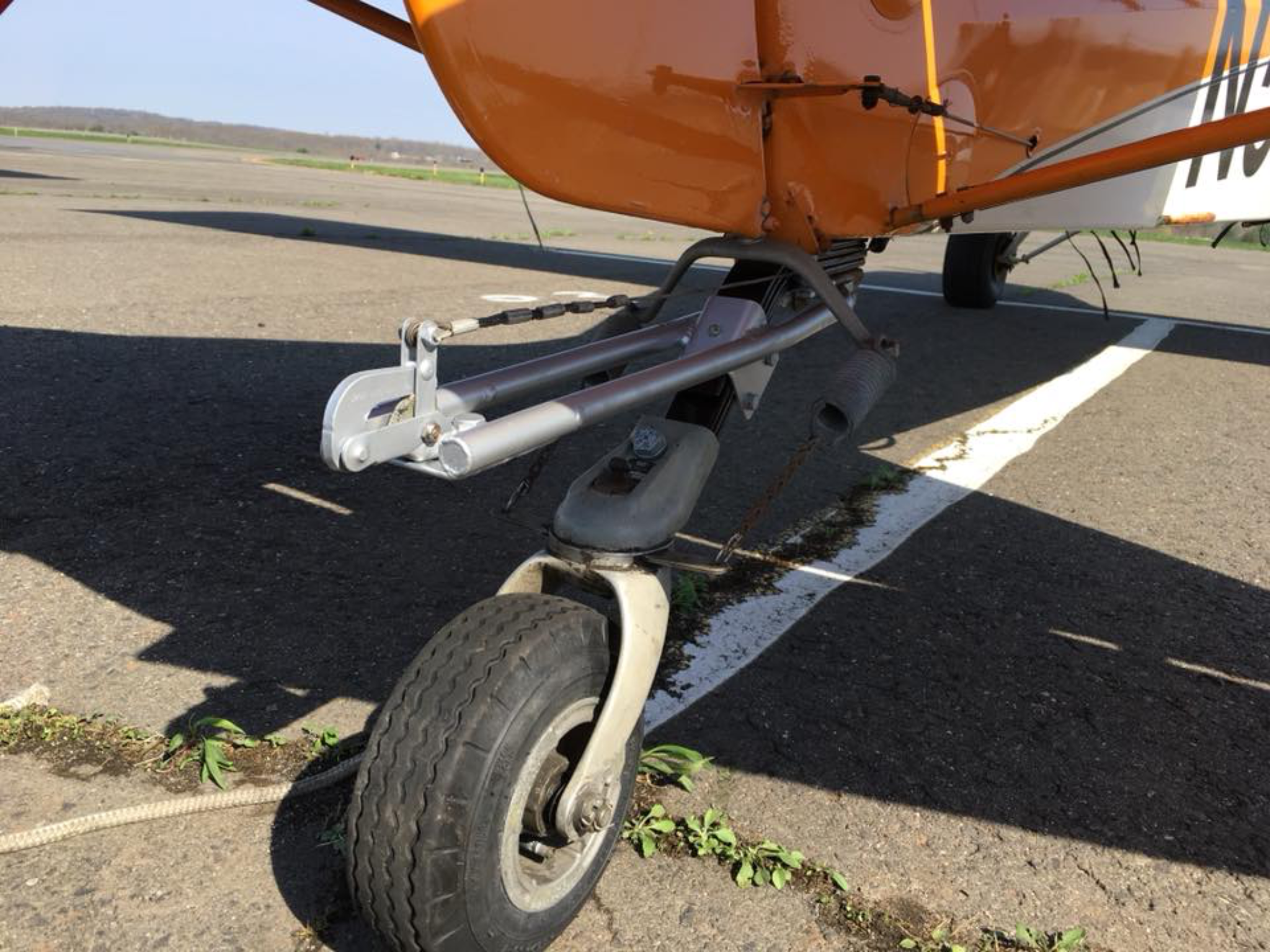

Here is the mount for a Schweizer hook on my Maule. If you need the drawings I should be able to help. If you made the hook you should be able to make the mount. Not sure if you’re experimental or have flat tailwheel leaf springs but it’s a simple attachment.

Yes, flat spring (J-3 type), and exp. Thanks for the pic, I will put that info into the mental mix of whatever design I dream up. I like the dual arms, hmmmm, got me thinking.

Since it's not clear in the picture and I can't take another one right now I'll describe how it attaches. There is a U shaped bracket that attaches under the forward leaf springs and main fuselage attach bolt. The tow hook arms each have a hole on the forward ends that bolts to the U bracket and acts as a pivot point when the leaf springs flex. There is another smaller gauge bracket that you can see that sits on top of the leaf springs and keeps the hook arms and U bracket from pivoting side to side.

And....finished! Thanks for the tip gdflys, your mention of the drag links (my term, sounds about right) having to be able to pivot made the entire thing crystalize, everything fell right into place and best of all I had everything needed already, even though I had to scab together both drag links out of several short lengths) 3 lbs 12 ozs. all up weight. My projected load on this "system" will be 10 to 100 lbs at most. So I engineered it accordingly (half ass). Just need paint and some nylon tubing to run the 1/16" stainless pull cable (I have a whole roll of the 1/16", left over from the ultralight days) through. No fairleads, the trigger forces should be low enough to be able to keep it real simple. I have a plastic buffer on the tail spring capture bracket, to allow for up and down movement, and side shims to keep it solid side to side. The drag links work off the main tail spring bolt of course, I just had to turn it around, nut down. Once operational, it should just take about 20-30 minutes to re-install/take off. I just need paint and the tubing, out of pocket cost will be those two items, less then 20 bucks.Image
Re: Tail release
Looks like a factory install. Just make sure the release cable can't get fouled in the rudder if the tail springs are compressed. It looks like if you run it under the mid bracket then it should be fine. Nice work!
