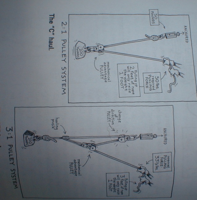

Here are a couple pulley-rig examples:

GroundLooper wrote:Once again, BCP.org shows it's worth every penny of it's membership fee, heck, double the membership fee!
Monthly invoices are in the mail. :D
I've seen some block-and-tackle set-ups on sale before pretty cheap-- usually something pretty light-duty intended for hanging up a buck in the meat tree. Oughta work OK for pulling an airplane into the hangar, unless it's a Twin Beech or something like that.
I wouldn't imagine that pulling the plane into a hangar by the tail tiedown loop would damage it but you should consider that the loop was designed to be pulled down on, not sideways. Even though wind will change and the tiedown ropes won't be pulling in a direct downward direction the majority of the force will be downward. Even so, loading the tiedown point axially shouldn't hurt anything if nothing is hindering the plane from moving.
GroundLooper,
What book are those diagrams from? They look like systems I was taught to use in a swift-water rescue course I took once. I drug my VW bus across a parking lot with a "pig rig" to demonstrate that one person could do it. They are kind of a pain to use though.
Jon
whee wrote:What book are those diagrams from? They look like systems I was taught to use in a swift-water rescue course I took once. I drug my VW bus across a parking lot with a "pig rig" to demonstrate that one person could do it. They are kind of a pain to use though.
Jon
"The Illustrated Guide to Glacier Travel and Crevasse Rescue" by Andy Tyson and Mike Clelland, Climbing Magazine, copyright 2000. One of my recommended mountaineering books along with "Freedom of the Hills". Somewhere I have a Mountaineers handout with a pretty good pulley diagram as well.
