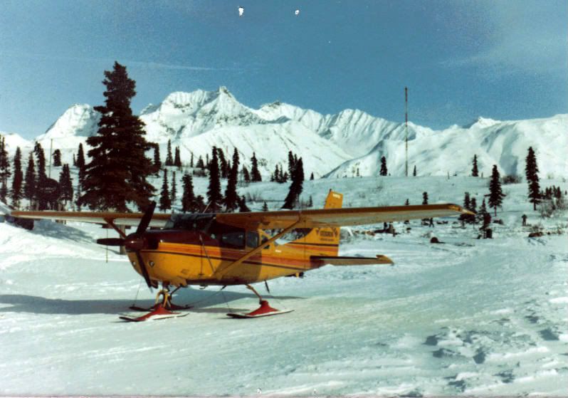

I would suggest they haven't caught on yet. Wheel skis suck straight skis are great on a 206. Worked for me for years. I agree with MTV on 206's except on skis. Landis 3500 mains and 2500 on the nose will keep up 8) with any C185. More floatation is the answer.
