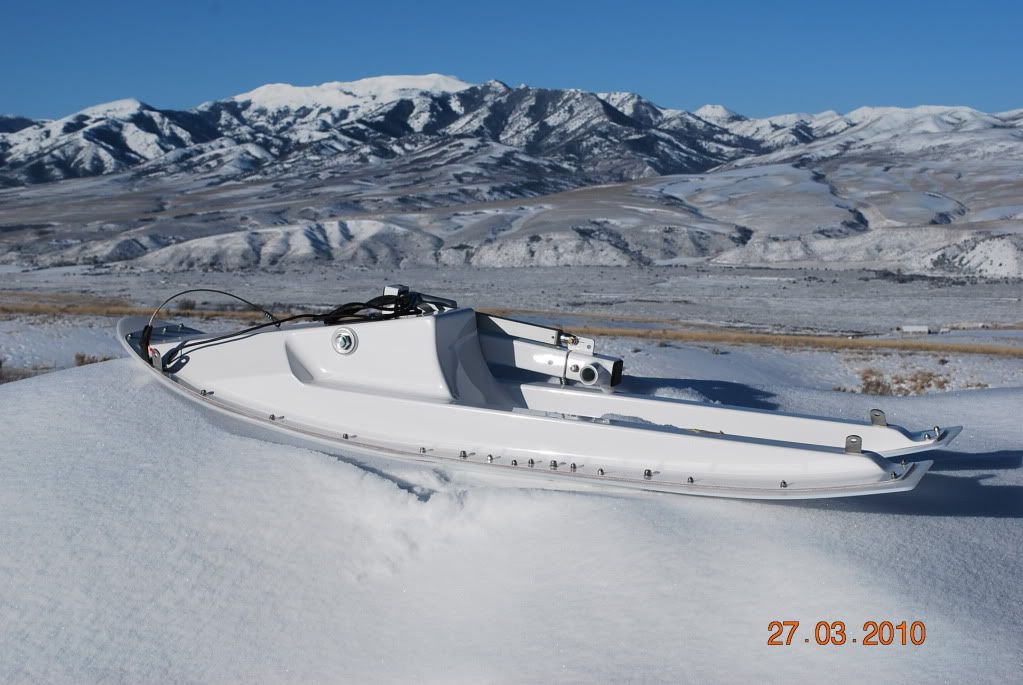

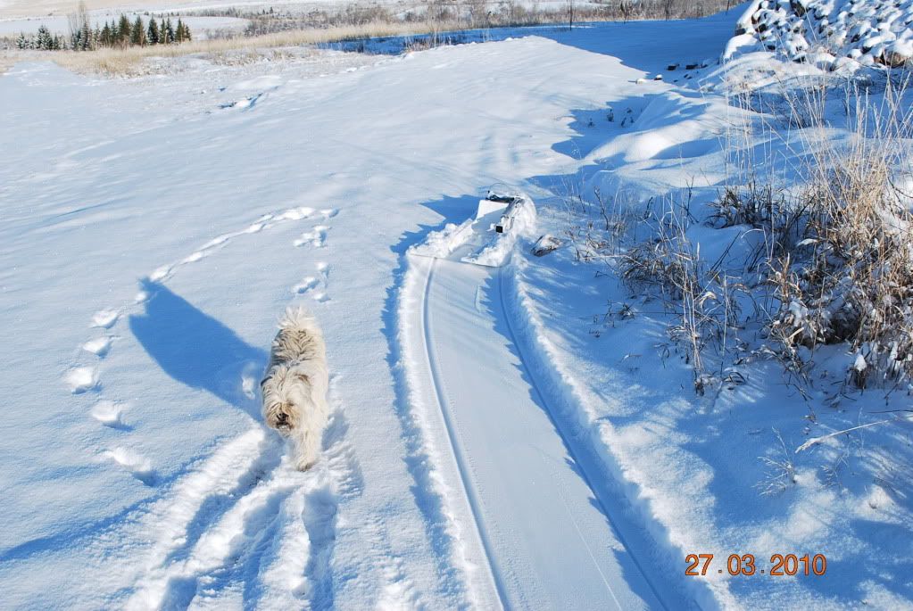

We got several inches of fresh snow overnight, so right before I headed up to the ski area I just had to push the new skis around a bit. Their first time in the white stuff, pretty exciting! It was immediately evident that the skegs on the bottom (one on the inboard aluminum, the other on the outboard nylon) are canted in order to provide what amounts to toe in.
They slid REAL easy, and as they slowed they would curve to the direction the skegs are canted. The picture shows the left ski...., I am assuming this is all as it is supposed to be, a design feature in other words. They both perform and are built exactly the same, only difference being one is left and the other right. Anyone know is this standard procedure for airplane skis, the canting of the skegs to provide "toe in"?
