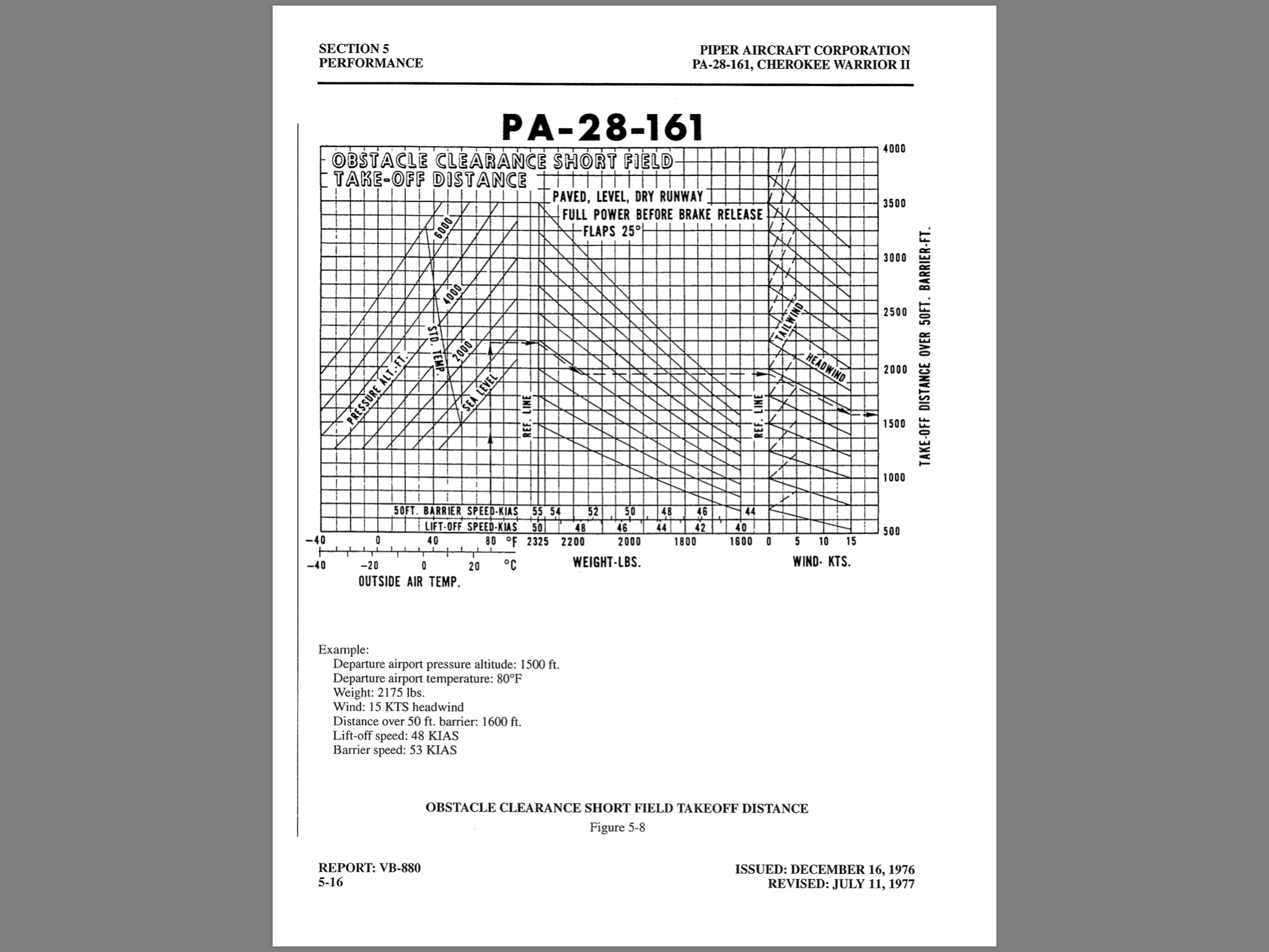

I have a Warrior with Horton wing tips and gap seals - I haven’t tested against POH/AFM but don’t think it shortens take off dramatically. It does however deliver 120KTAS.
It earns its keep at a flying club.

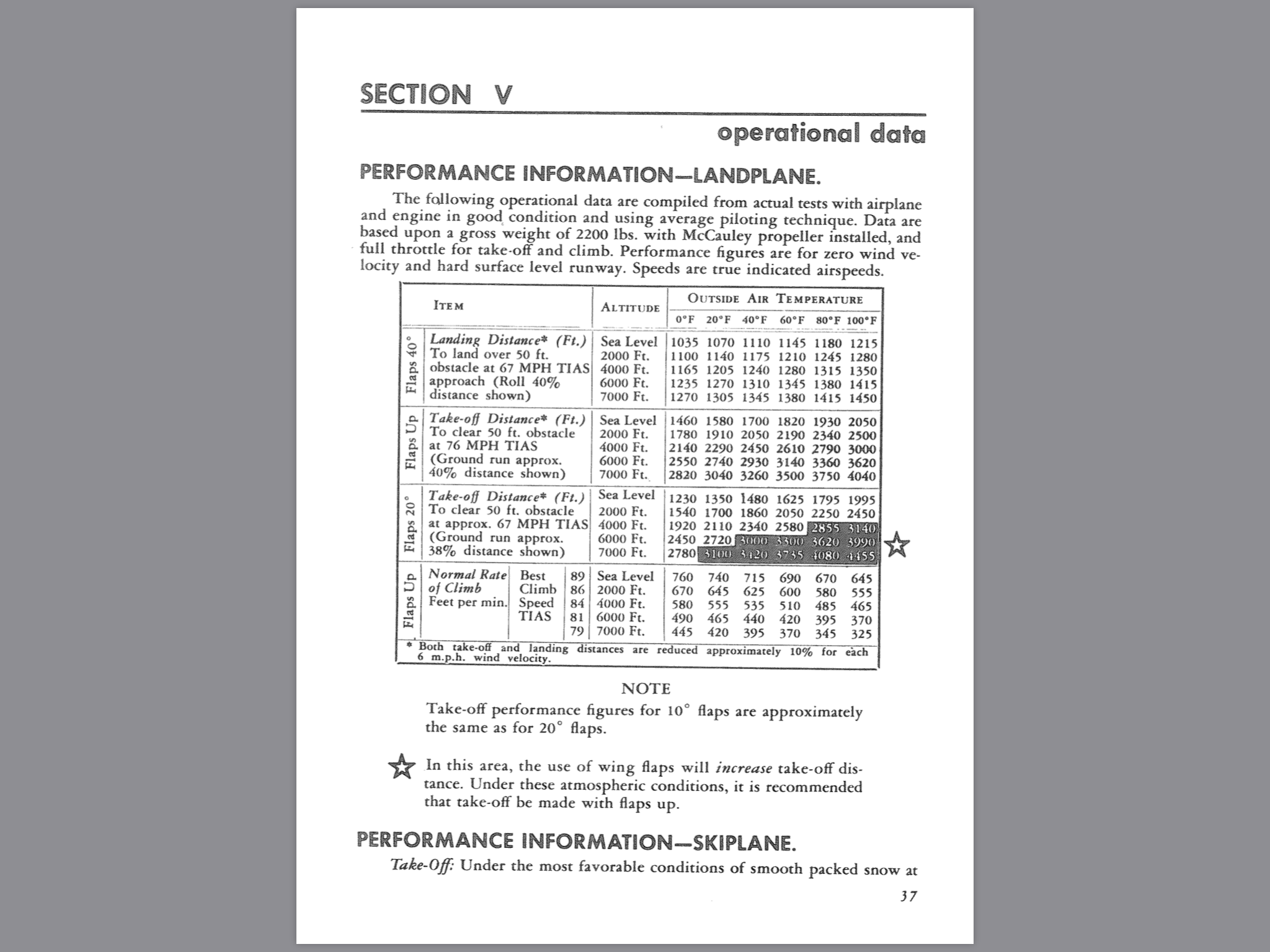

In comparing book performance I was intrigued that a 1955 Cessna 170B POH has a take off distance required of 1625 feet (2200 lbs ISA Sea Level No wind).
The prosaic taper wing Warrior shows 1500 feet similar conditions (2325 lbs).
