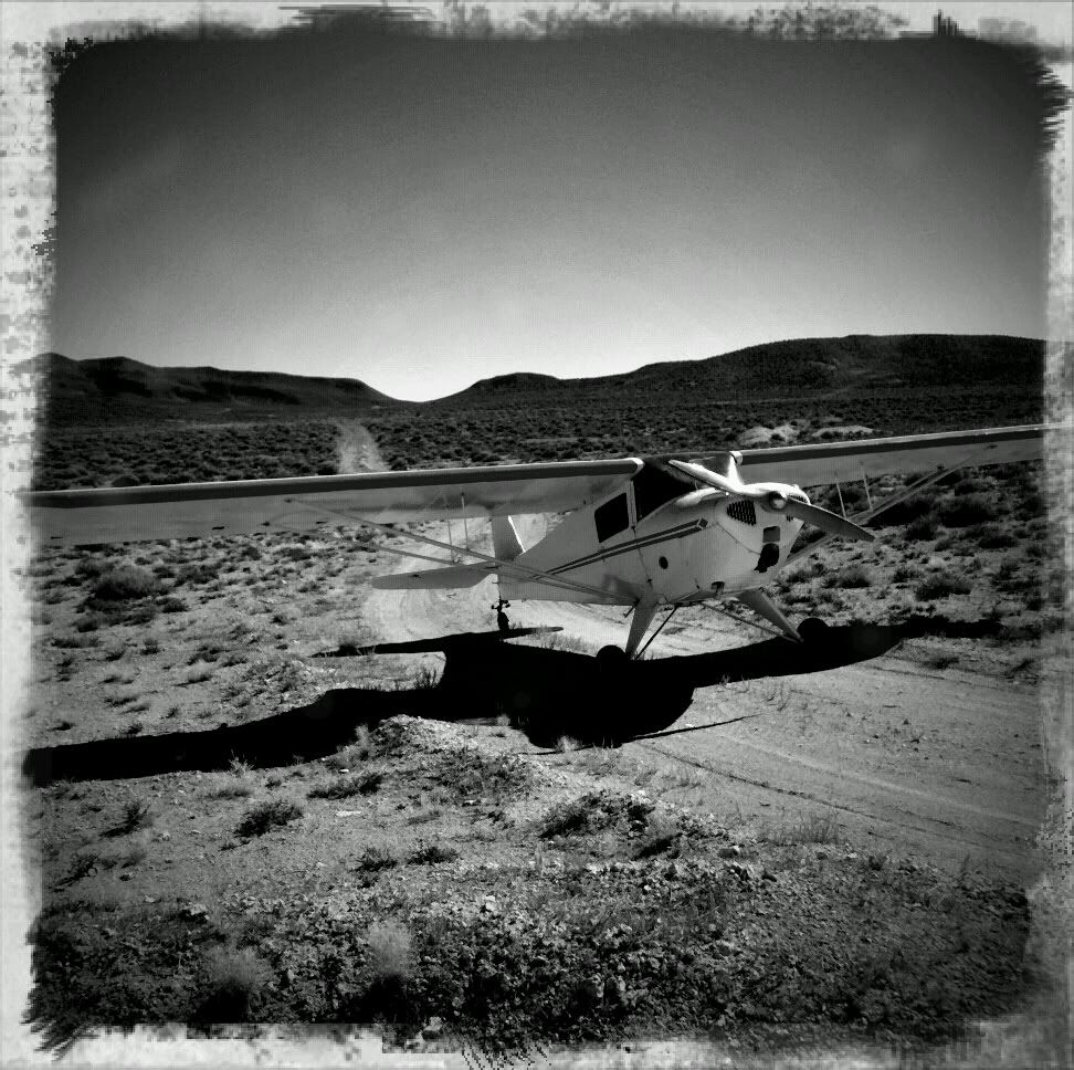

I've been having an absolute blast with the T cart I just bought.. Had to fix quite a few little bugs, but seriously it's fun. I'd love to put some vg's on to see if it would break ground just a bit sooner, but gas is much more important.. It will land short, but with the cruise prop and 65hp, it runs a bit to get off, especially with the Mrs., 24 gallons of fuel and a bunch of groceries in the back. I flew for two hours exactly the other day, and put 6.1 gal in it to fill up tho. That's 8hrs range..
It's cool tho to go back to lookin for thermals or ridge lift to get over the mts., and when ya cut the throttle, there's just not much difference, it glides like crazy. No worries about radio not working, or generators or dead batteries or stuck starter or burned out lights. Who needs headsets, intercoms, gps', or flaps... All frivolus fluff. Side by side, is really great with the Mrs., we can talk and laugh and point. I can see her face to see if she's really serious about knocking off whatever.. ha ha
I cut a piece of pvc to jam against the seat and hold the brake down while ya prop it, then stick in a couple ear plugs, and yer off for adventure. I'll take it to Johnson Creek this summer, it will do fine, I bet better than the old texas taildragger 150 we had years ago.
I doubt it will make it through the notch on takeoff tho.. ha ha
