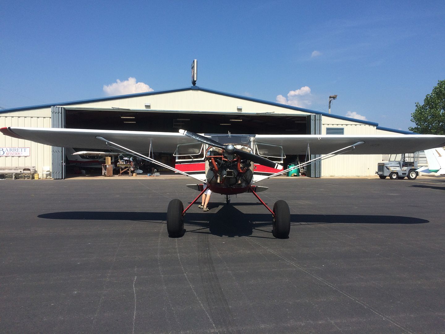

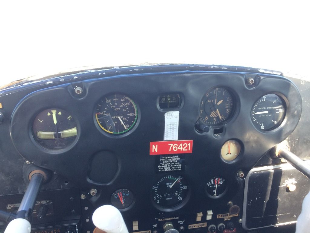

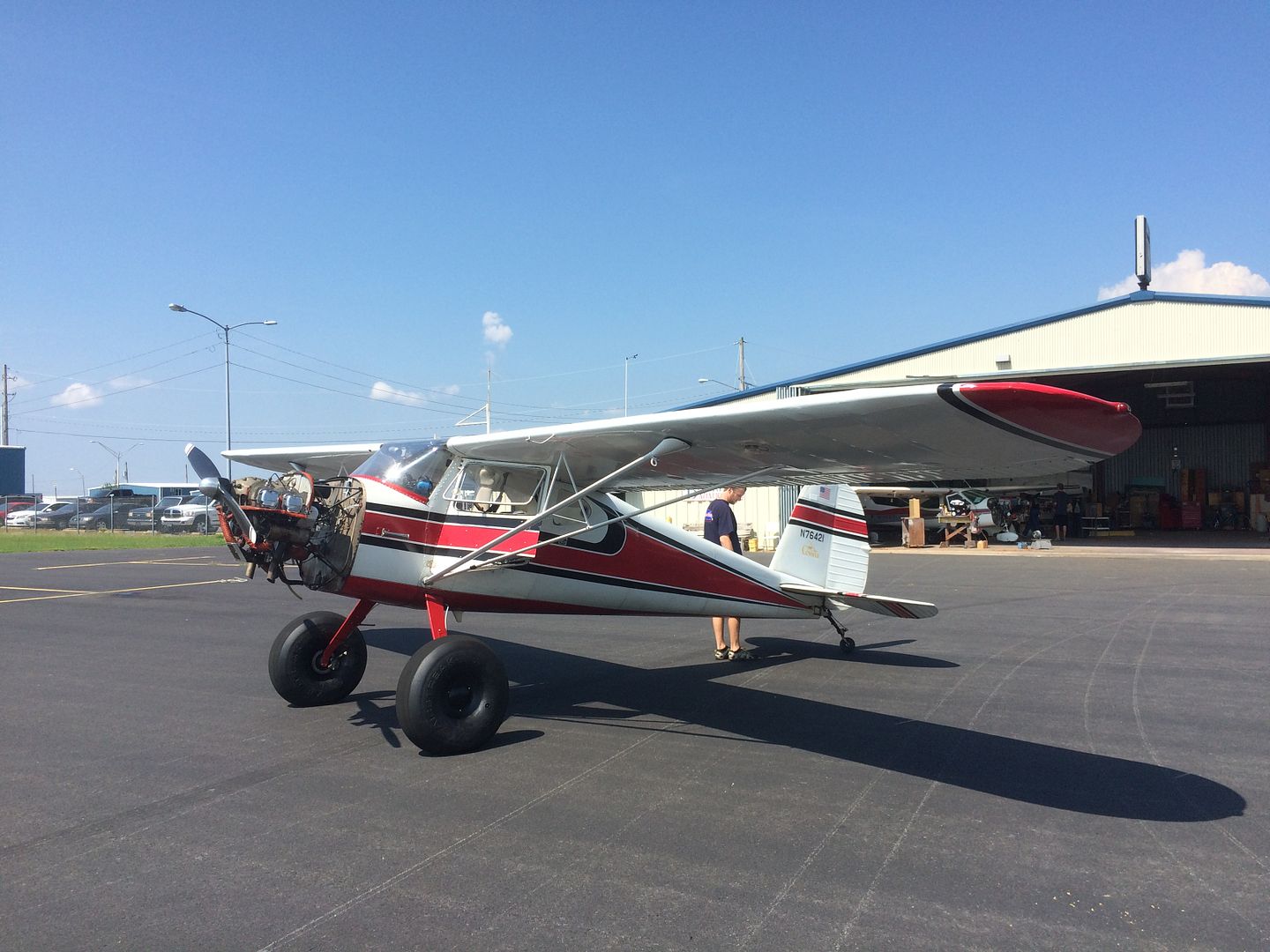

Here's a few more from a while back as some mx was getting taken care of. I will be flying it out west here next week so I'll get some photos of her in action. And if anyone knows anywhere worth checking out between Little Rock and Albuquerque let me know, no real plans, just looking to enjoy the ride and a few days off from work.

That's an awesome 140, mighty indeed!

That looks great! Can I ask who or whom supplies the STC for the bigger mains? I thought 800's were all that could be used on the 140. Sweet setup for sure.

rcwflyer wrote:That looks great! Can I ask who or whom supplies the STC for the bigger mains? I thought 800's were all that could be used on the 140. Sweet setup for sure.
8.00x6 is the largest tire that can be installed per the TCDS. Anything else needs to be STC'd. Looks like he's running 29" Airstreaks which are a little lighter than true Alaskan Bushwheels, they have a max gross weight of 1700lbs. Airframes Alaska now holds the STC.
