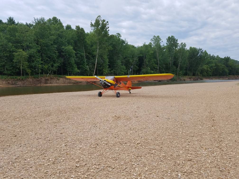

Hair less then 10 psi smoothed things out considerably. Found a pretty nice gravel bar this morning.
