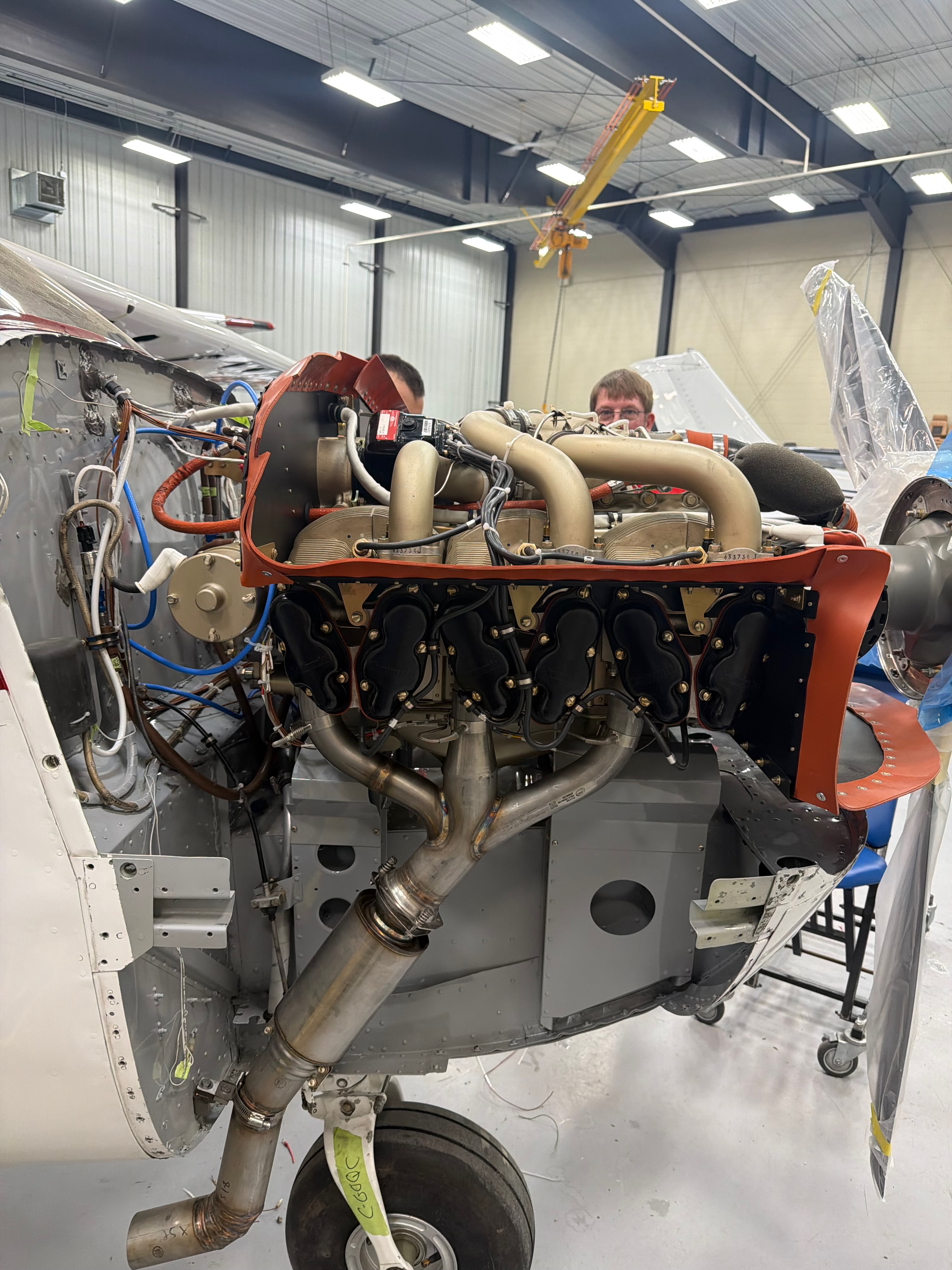

Having had lots of 206's Legacy, turbos, H models, and Soloy's I can confirm that every one of Mikes comments above are reality. Other than use more fuel running ROP everything about a 550 is simply a better engine for the 206. If you run light on wheels then the 520 is fine. If your running at 3600 or 3800 gw with the Flint tips or on floats 206's are seriously underpowered. Same engine as a 185 with 250 lbs more gross and a wider fuselage profile so no magic there as far as take off performance. Used 206's with 550's command top dollar for good reason.
The guys a Park Rapids MN will have a N conversion ready to go for us next week.
