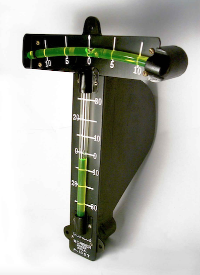

Here's another video I thought some might find interesting. It shows how I converted the inclinometer to read in sync with my AOA/AOS Indicator. https://youtu.be/5Zfrhz3Q3ew
I wanted the inclinometer "the ball" to be consistent with the Sideslip Angle Indicator I developed (see original video). With my Sideslip Indicator, the red tip of the beam represents the nose of the airplane. Move it with your rudder pedals to keep in coordinated, into the relative wind. The answer for the inclinometer was to invert it and read the air bubble instead of the ball. Now the bubble can be thought of as the nose of the airplane too. No "stepping on the ball". Move the bubble with your rudder pedals. Very intuitive. Attached is a photo of the inclinometer Lindbergh chose, the Rieker P-1057, for the "Spirit of St. Luis" and his transatlantic flight.
