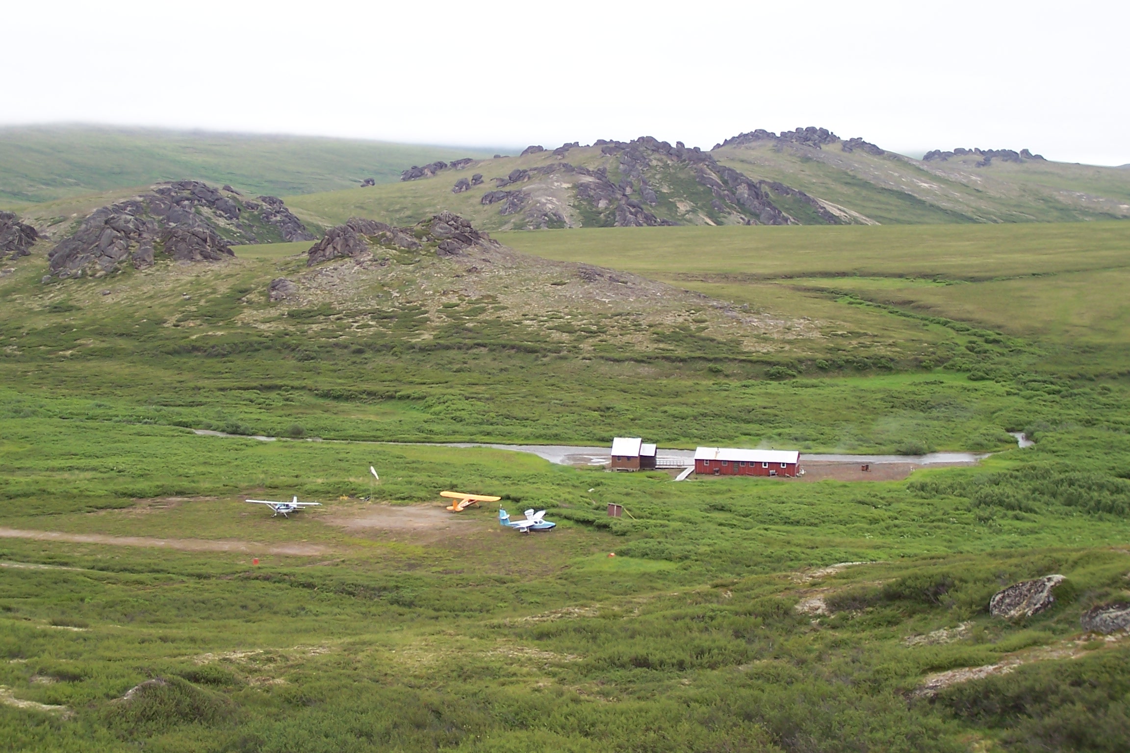

I ran across a Lake at Serpentine Hot Springs awhile back. The airstrip was in decent shape, it was just the sight of an amphib there that was odd. I did not see the pilot land or take off, but I would imagine he did just fine on both accounts. He was by himself, but he had enough gear to comfortably camp wherever he wanted to. If I remember, Ed (the pilot of the Lake) was from the seaplane paradise of Colorado.
The landing gear does look rugged.

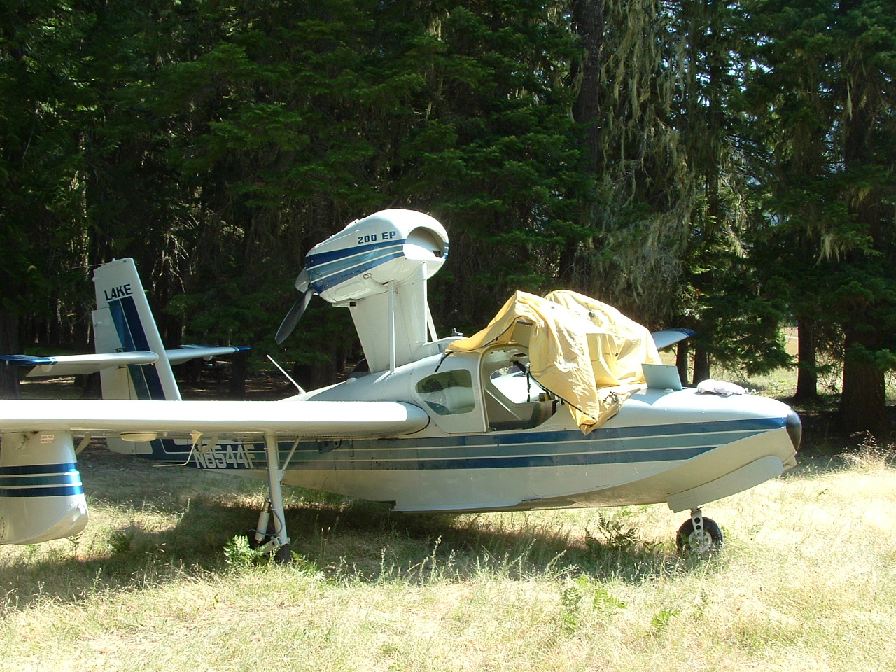

This was a Moose Creek quite a while ago. I didn't talk to him, see him land, or see him leave, but was enjoying the area in his ride.
