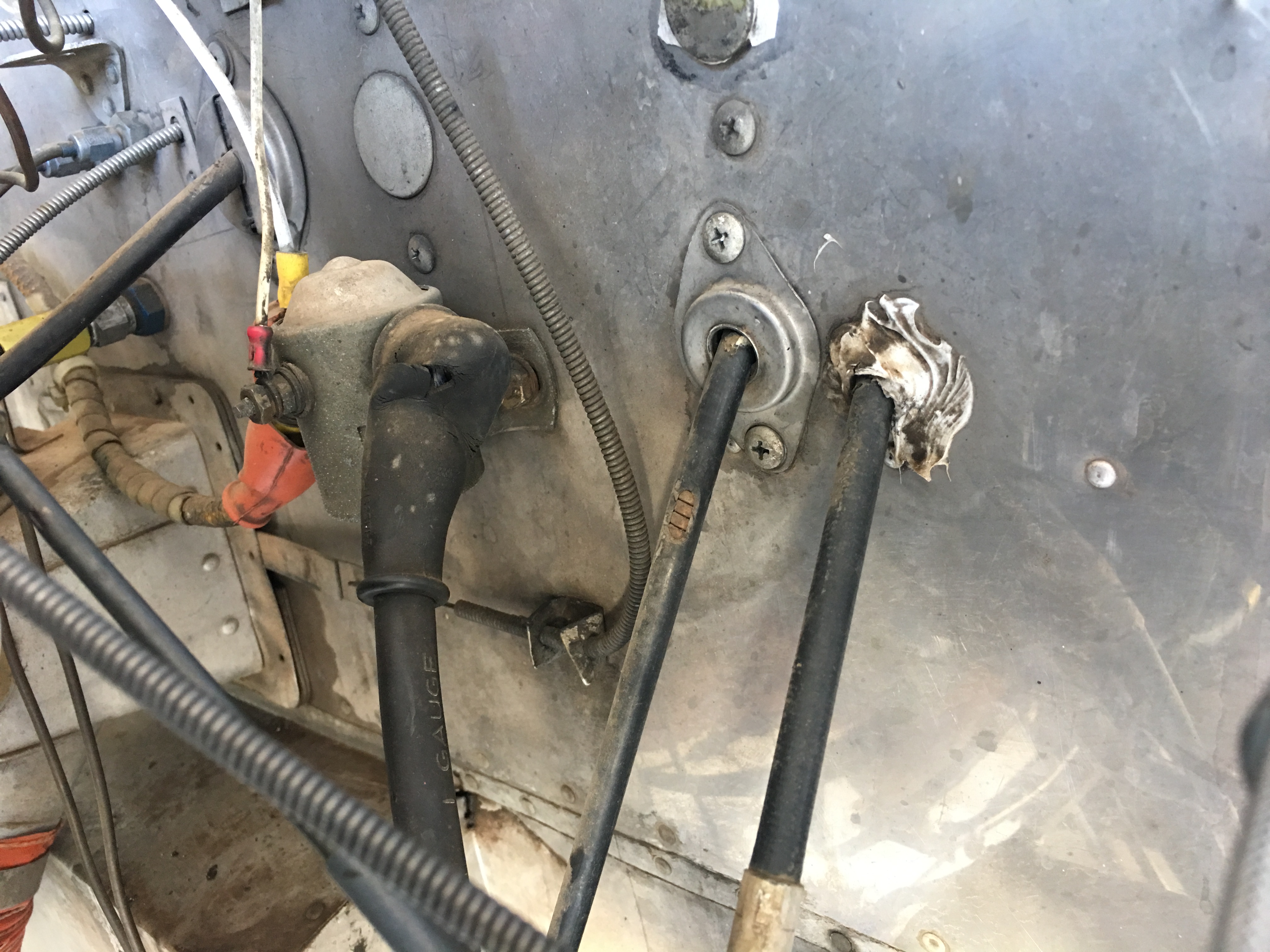

I have been unable to talk to Bob Williams. All I need for my C-175 with a Lycoming Avcon conversion, is a part number for a support bracket or clamp or whatever that supports the constant speed prop control cable
There is no bracket or clamp or support on the cable that goes from from the engine side to instrument panel

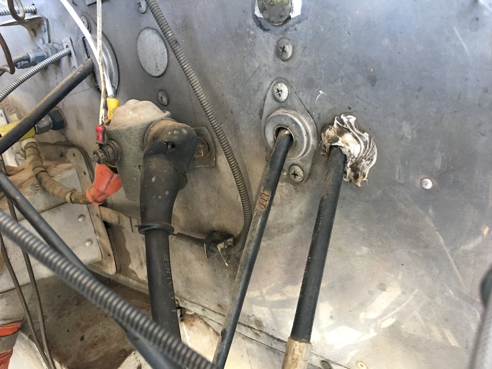

Can you provide a part # or a photo for the part my C-175 Avcon conversion is missing? It's a bracket or sleeve or clamp or something like that that supports the constant speed control cable see photo
You see what is missing on the right cable
