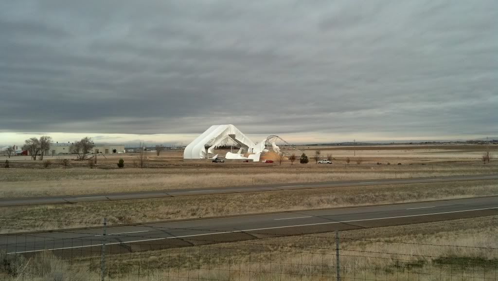

Zepplin crash near KPIH (Pocatello)
Don't know what happened, nobody hurt anyway.Image
Re: Zepplin crash near KPIH (Pocatello)
Hold on... closer inspections shows it was a very large fabric tensioned struture (VLFTS) that collapsed, AGAIN. It partially went down last year, at a different location about a 1/2 mile away. They took it down and relocated it, both locations about 1/4 mile from KPIH tower. This thing is huge, maybe 250' span. There is an identical one across town, used for a riding arena. No problems with so far, the big difference is it has closed in ends, this one is open ended, and when the wind comes howling out of the Arbon valley who knows what aerodynamic forces are exerted. I know a lot of peple with clipboards and cameras (lawyers maybe) were examining it very closely....I could save them all time time:it's too damn big and too windy in that location, end of story.

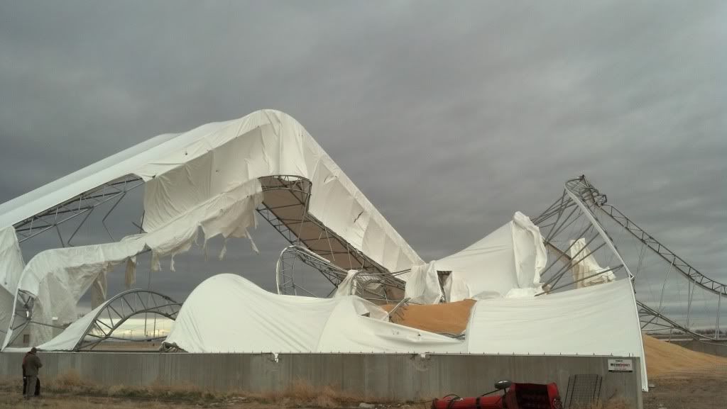

This is going to one crane job I am passing on, lots of unknown forces in that torqued iron, they better just pull it down with front end loaders from a long distance away, once they get the grain out.Image
Not cheap, but usually they stay up. This sized one, at this site, was a colossal poor choice in retrospect, the family farm biz that put it up (twice) are real good folk, and not known for making poor business decisions. Doubt they'll try 3 times, we'll see.
And a crashed Zeppelin is what it looked like to this air minded ex carpenter, it's very close proximity to the airport heightened this impression.....a better story anyway then "grain storage structure collapses!"
