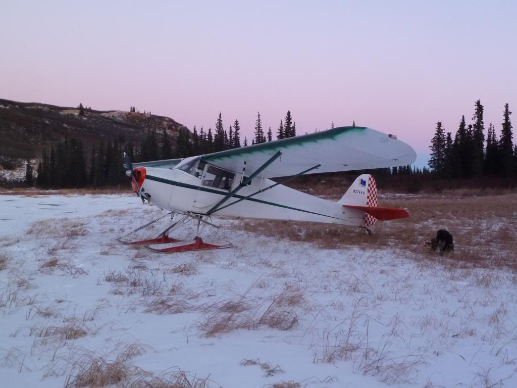

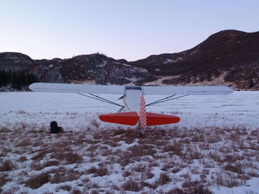

oh if anyone in ak wants to go out flying let me know. kinda like going with another bird for the next 20 hrs while i can before i make a decision to pull the motor or not. who's a good company for oil anylasis? do you send them the oil from right out of the sump or the oil that comes out from around the screen in the back? and no i dont have an oil filter. should i get one? i know they really help filter out small particles that my screen will miss. here's some pics of the new tail on my lake at my cabin right after my anual in early december. anyones is invited im always looking for an excuse to get out and up cruising around:)
btw, have a beer while mesuring out and taping off the checkers on your rudder.....it makes the 5 hrs process a little less painful:)
