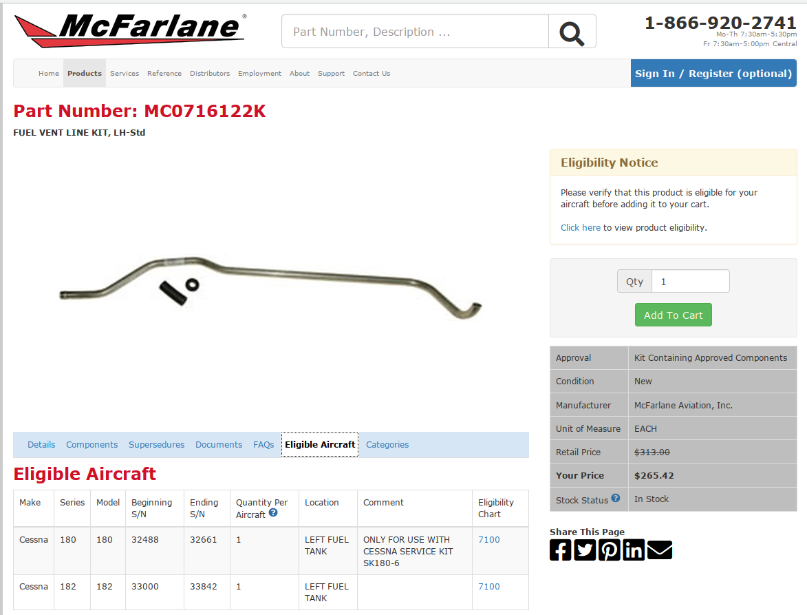

I think this is what you need but you can do more research on their website. I think they formed the line to go right up to the top skin so that there it is less likely to leak fuel.

180Marty wrote:I think this is what you need but you can do more research on their website. I think they formed the line to go right up to the top skin so that there it is less likely to leak fuel.
So my SN is before the applicability of this MacFarlane part (mine is a 1955). I contacted Yingling and they said "don't have the part, but here's some drawings, make it from scratch". Does anyone know if this McFarlane part is close enough to fit a 1955? I'd rather start with something close than make something from scratch.

I don’t believe that you need or want the mcfarlane part. Get the fuel valve for the left bladder, cut the new inspection hole, and then there will be a small bit of fuel line that goes from the left side bladder vent to the under wing vent. I did mine and haven't had any problems. I have the drawings somewhere, I think I got my parts from the wagon junkyard in canada, skywagon city. DM me with questions
