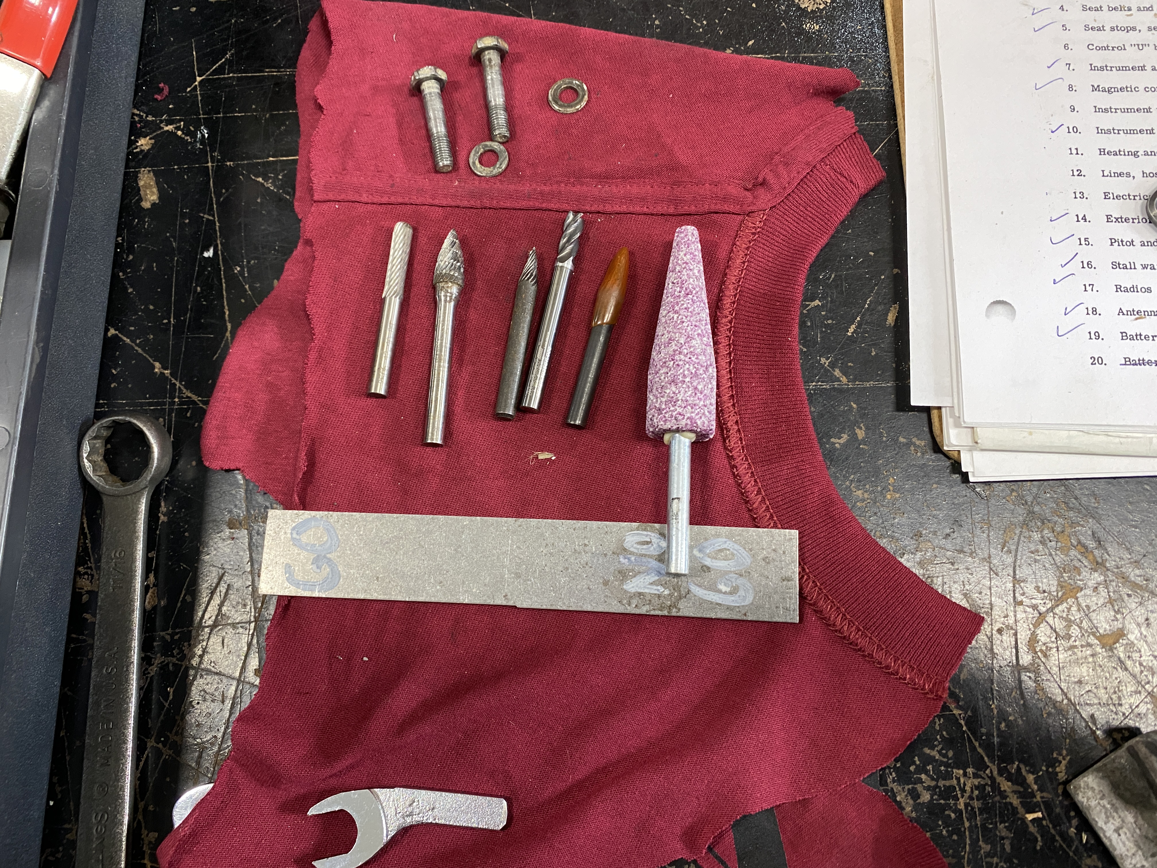

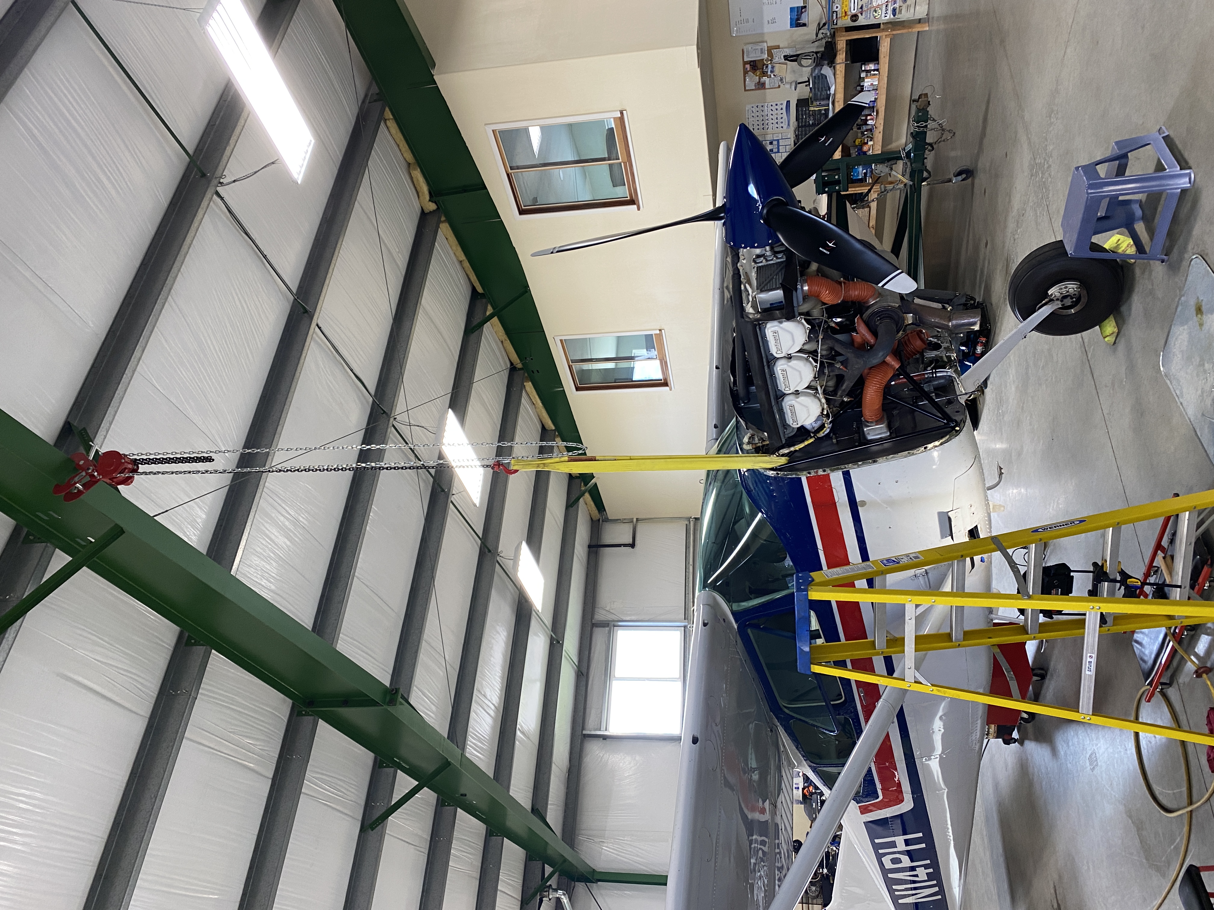

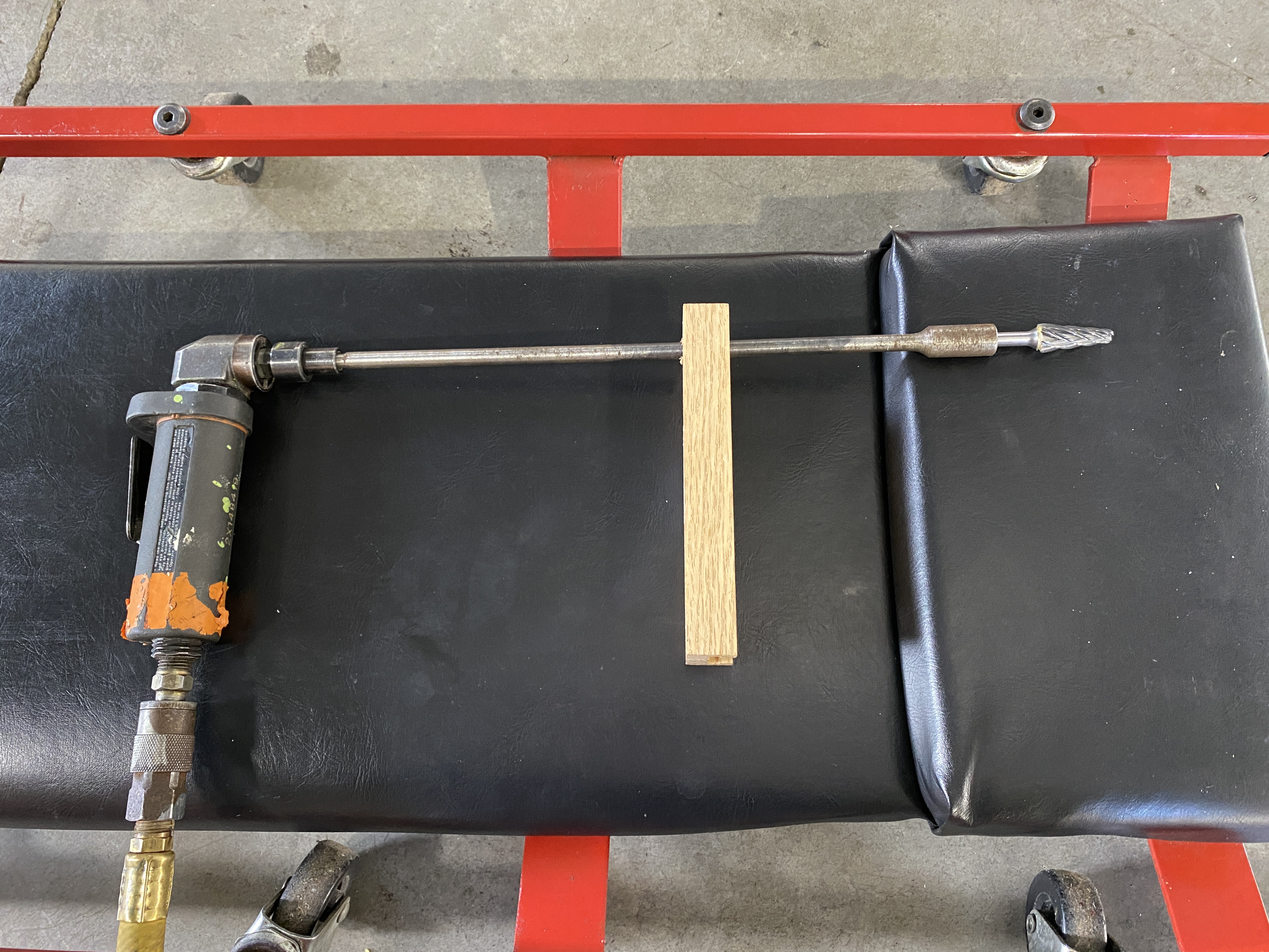

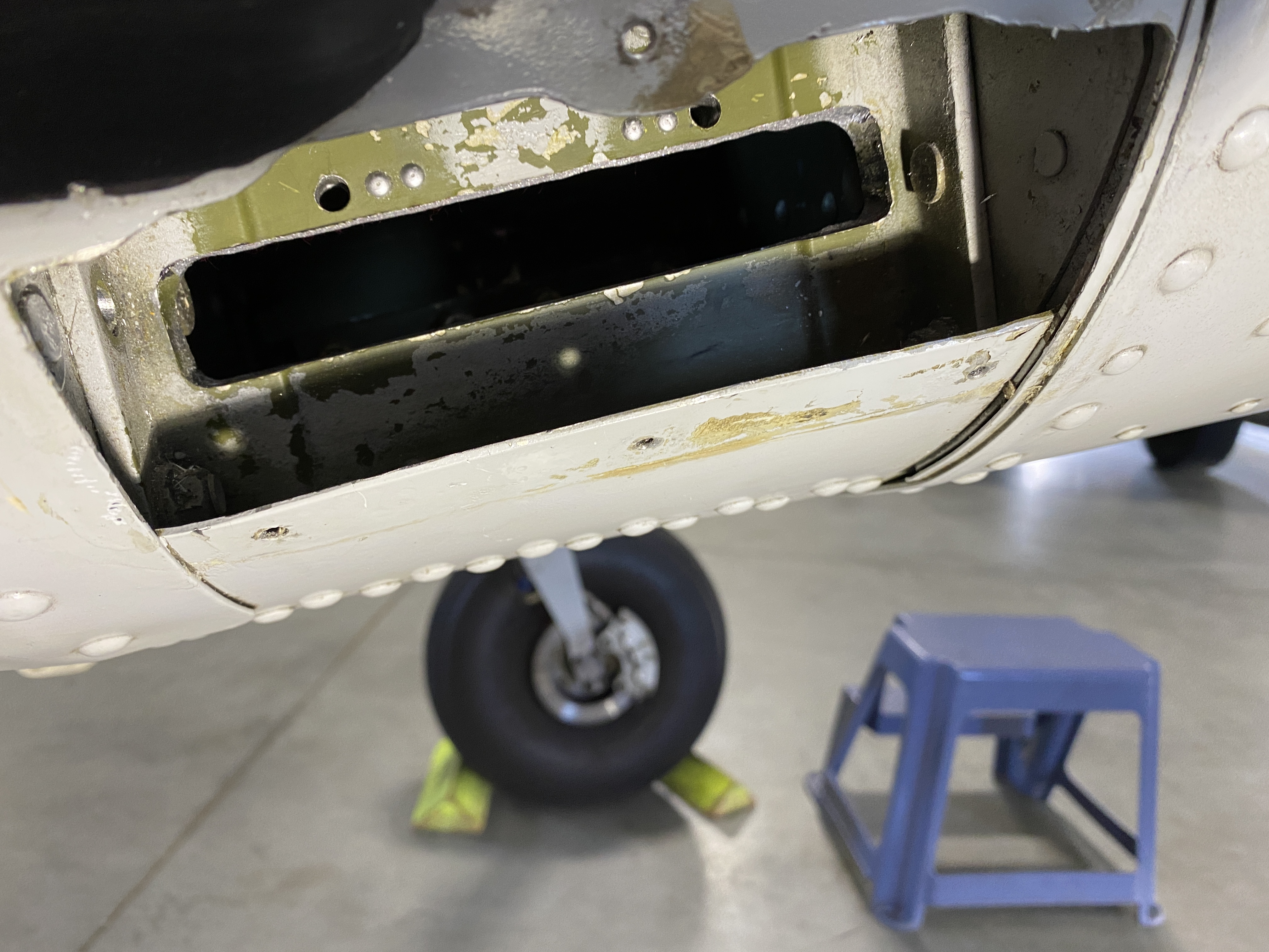

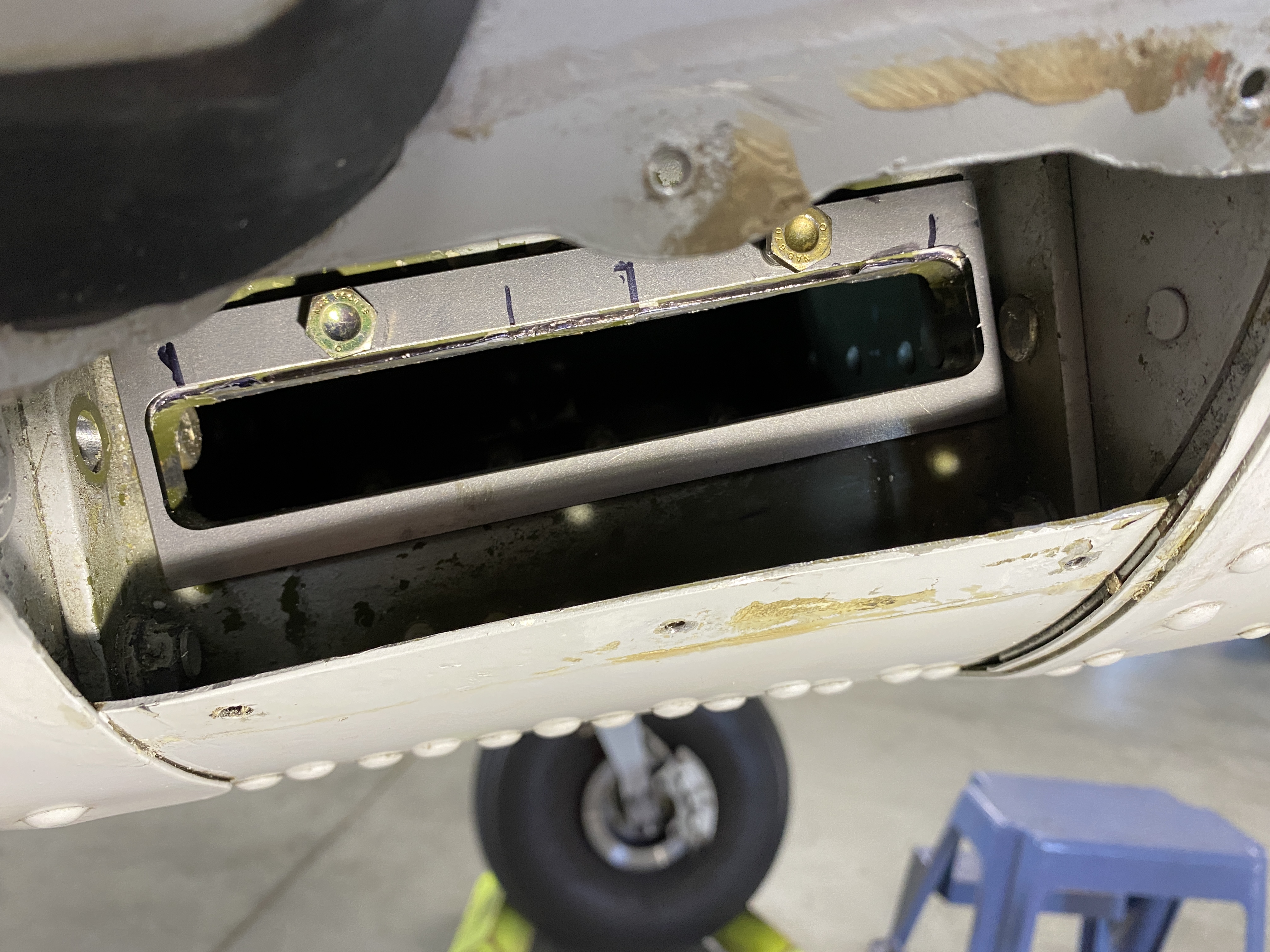

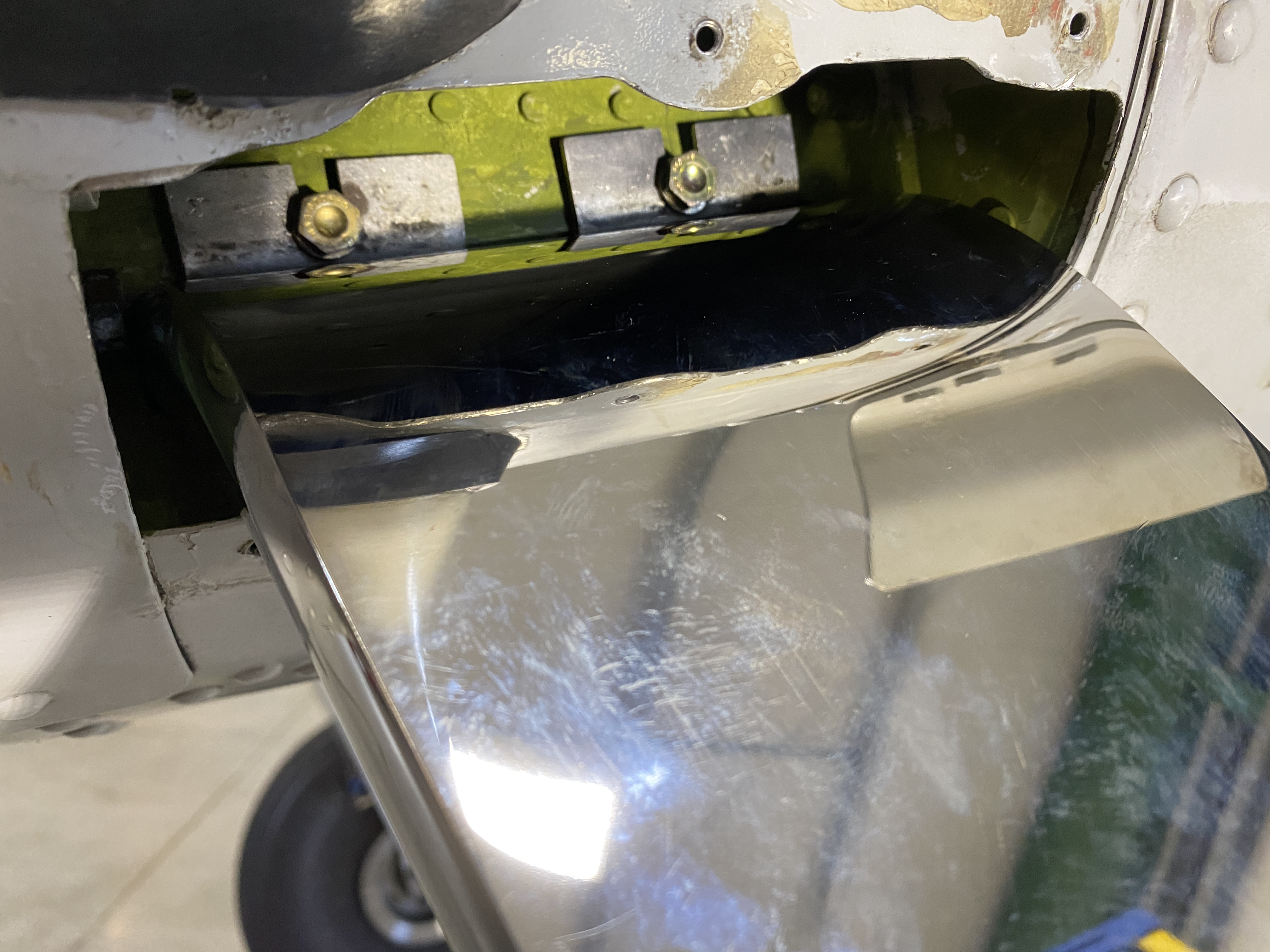

LH gear installed, then work called and I had to leave town - but I'll pick up where I left off on my return. I was able to use a 90' die grinder and a tapered bit on an extension to get into the gearbox area and remove about .070" from the top of the gear cut out. I added a hardwood block to the bit extension tool to give me stability while grinding away. I then used a tapered stone to clean up the grinding marks, finally sandpaper and zinc chromate touch up.
As per the STC instructions I also had to remove about .020" from the wedges, and I did not re-install shims under the wedges. The IPC says the quantity for the shims is AR (as required) which I take to mean zero to as many as needed. These are not the shims used to level the wings, those shims go under the attaching bolt head and are again qty: AR. On the LH side gear there were no shims installed as removed so everything went back together the same way.
Once I get the RH gear installed I'll check wing level and tire alignments before I close all up.
The pics are of the gearbox cutout with the STC template installed showing the material to be removed, the same area after rough grinding, the die grinder setup, collection of bits/stones available to me, the method used to suspend the airplane while doing this work, and the LH gear with wedges in place.

I'm sure you are, but I'd be VERY careful lifting a 185 by the engine mount....

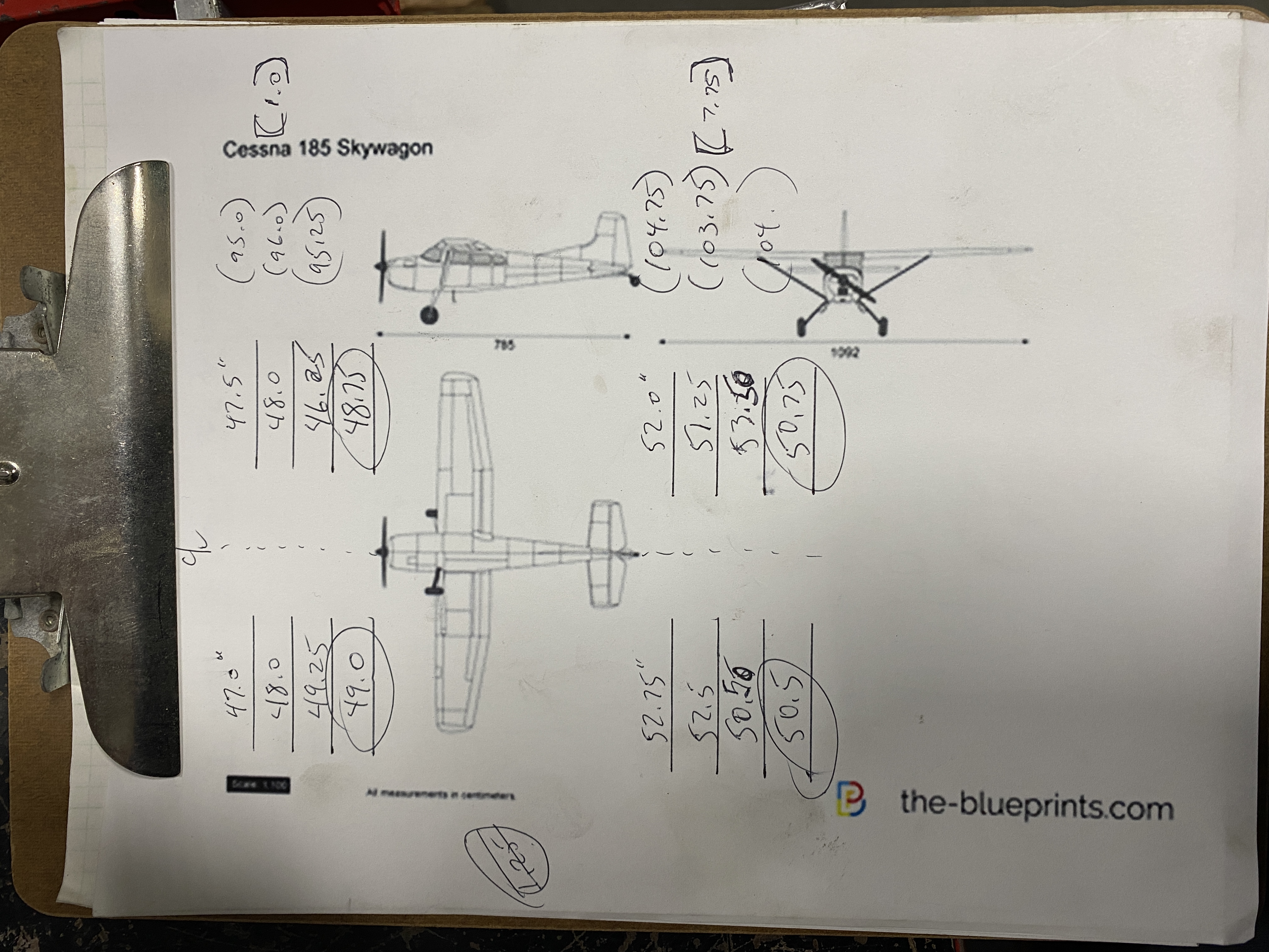

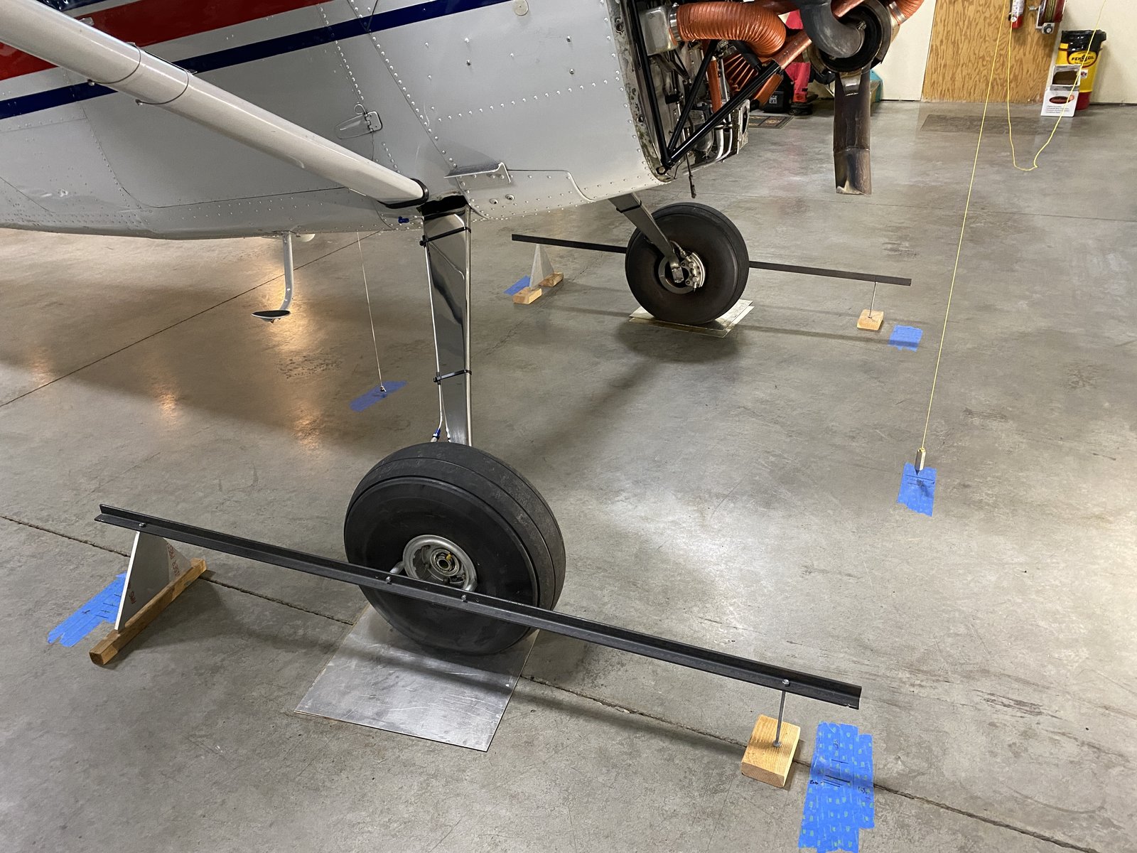

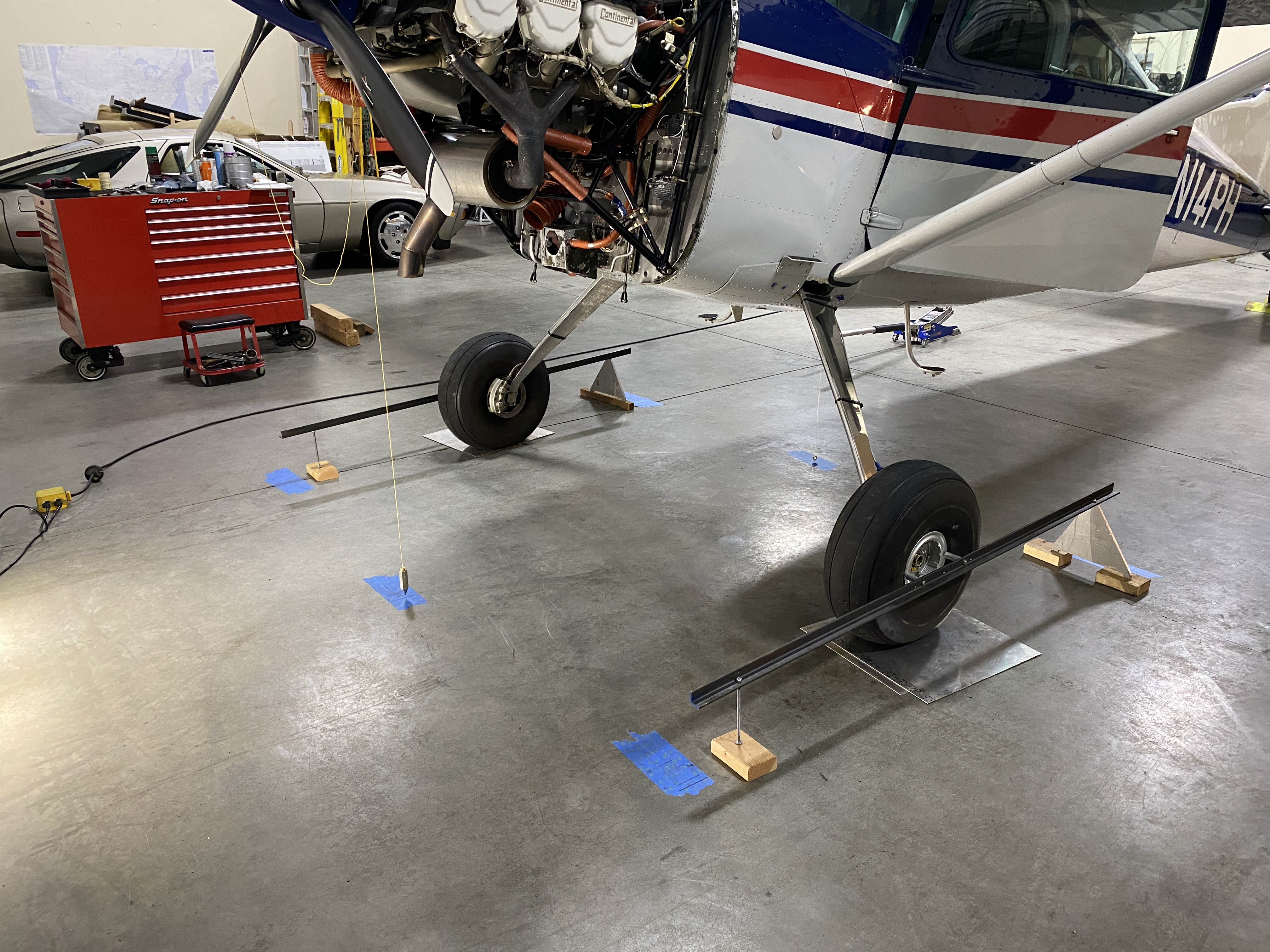

Finally had a window to finish the gear install, the process went pretty much the same on the LH gear, about 4 hrs to finish. Found the wheel alignment way off, very toed in so followed the manual a bit but improvised further. I was aiming for zero toe in and slight camber. I used a long set of trammel bars and a couple of plumb bobs to make the measurements. It took 4 tries with shim combinations to get slight toe in and slight camber. Taxi/flight test today if the winds die down.

Laser works great for an alignment aid. But gear alignment on Cessnas is arguably the biggest PITA there’s is. And the most important.
