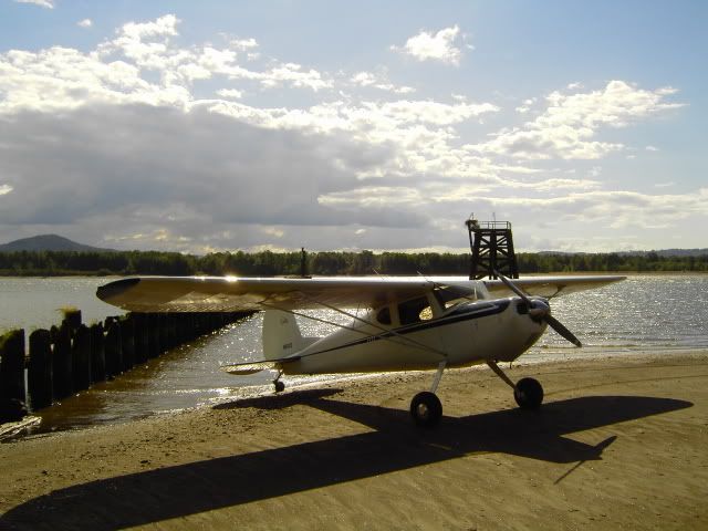

Well have been lurking here for a few months now and this one hits close to home just bought a c-140 and now have a total of 15 hrs and loving ever second best of luck
