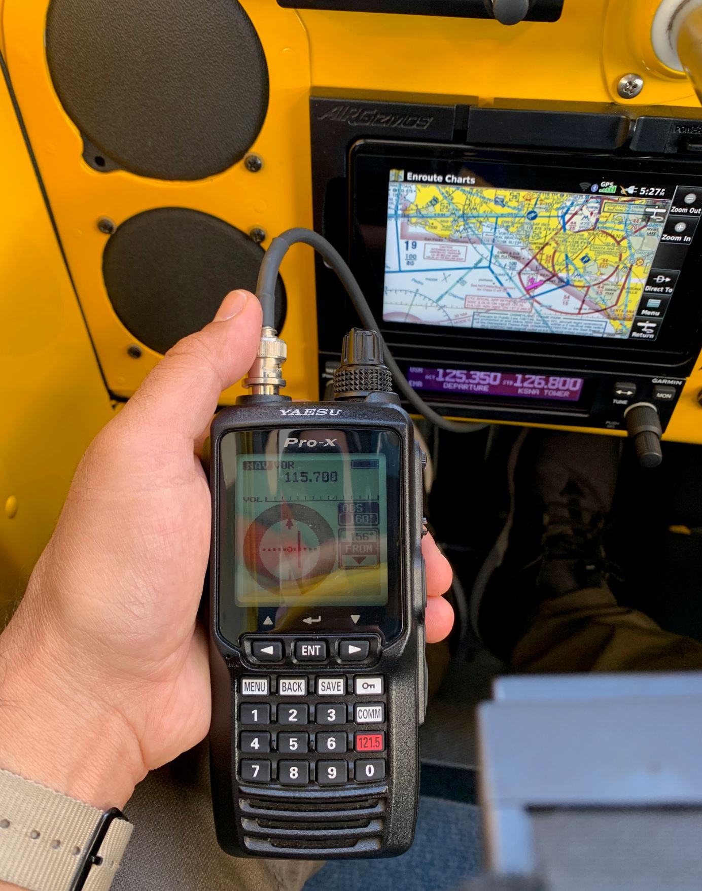

I removed my Narco Nav/Com and replaced it with the GTR200 and Aera 660 GPS. I do missing having a nav capability some times, but my airplane was never IFR, so I'd never be flying IMC, just practicing. When I removed the Narco I kept the Nav antenna because I didn't have anything to plug it with. Yesterday I plugged it into my handheld and was surprised how well it worked.
