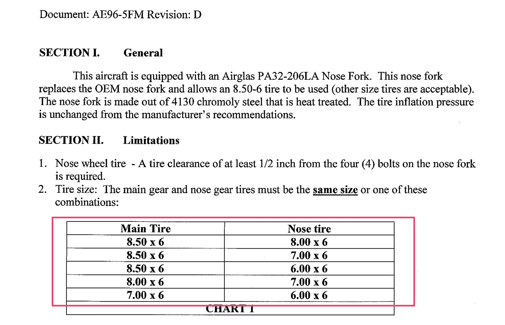

I know this is an older post but I found it when wondering what tires to put on my 206.
I don't think a field approval is required to run 8.50’s on the mains and 800 on the nose for any of the 206 models below that are equipped with the AIRGLAS PA32-206LA NOSE FORK.
206, P206, P206A, P206B, P206C, P206D, P206E, U206, U206A, U206B, U206C, U206D, U206E, U206F, U206G, TP206A, TP206B, TP206C, TP206D, TP206E, TU206A, TU206B, TU206C, TU206D, TU206E, TU206F, TU206G, 206H, T206H
The Supplement Flight Manual that accompanies the Airglas SA02069AK STC was revised on Feb, 9 2015 to include these tire combinations:
One caveat is that on U206F, TU206F, U206G and TU206G if you have Flint Aero tip tanks then the 3 tires must be the same.
STC: https://drs.faa.gov/browse/excelExterna ... 276EE.0001
Supplement Flight Manual: http://www.airglas.com/Portals/6/NWDS_S ... 206%20.pdf
It's possible I am misinterpreting this and a field approval still is necessary to run 8.50s and 800s, lmk if I'm missing something.

Re: 206 Annual and 8.50 tire upgrade
Nope, you're correct. Easiest way to upsize tires on a 206, legally.
