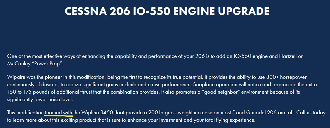

mtv wrote:
Wipaire's IO-550 engine modification and float kit increases gross weight to 3800 as well, on both floats and wheels
Ah, ok I thought that only worked with floats... if the gross weight increase also applies to wheels then that would be the solution I was looking for. Thanks MTV
I had been confused by the wording on their website, I'll chat with them.

Amy from Wipaire has confirmed that the aircraft must be on floats to take advantage of the gross weight increase.

Re: 206 to 3800 gross
CParker wrote:Amy from Wipaire has confirmed that the aircraft must be on floats to take advantage of the gross weight increase.
Interesting! Thanks for the research.
So, that leaves the Flint tanks as the only legal 3800 pound GW conversion on wheels.....
