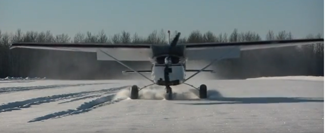

Found this guy running 6.50x10's with an 8.50x6 on the nose....looks like an option as well. Anyone know of any drawbacks of 6.50x10's? Looks a hair bigger than 8.50x6's and would save a ton a weight on each wheel compared to the 29's.
Sure looks fun playing in the snow!

Re: 29"x11-10 down to 8.50x10 question
MDHF15 wrote:.....Found this guy running 6.50x10's with an 8.50x6 on the nose...
You sure those are 650-10's?
Posts: 10611
Yeah I was wondering same at first. He answered someone in comments and said he was running 6.50/10's on main and 8.50x6's on front.
So I dug around on aircraft spruce and sure enough 6.50's are 21 inches (same as the 8.50x6 up front). Says the 6.50's are 16 lbs where the 8.5010's are 22-25lbs. This is just one of them things you hem and haw on for a while and finally make a decision. ](*,)

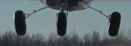

Man, those tires looks a lot bigger than the nose wheel. They sure look like 8.60x10s to me.
A few months ago I looked up 650x10s in the GoodYear spec manual. They are real close to the same size as 850x6s. They’d be a great option if you only had 10” wheels but wanted smaller tires.
whee wrote:Man, those tires looks a lot bigger than the nose wheel. They sure look like 8.60x10s to me.
Yeah they seem really close to same size when I looked em up too. The ones in the video look bigger than the nose wheel for sure.
I would bet they are 8.50x10s on the mains in that video. There is no STC for 6.50x10s, and in Canada most mechanics are pretty sticky about sticking to the rules... For grass landings like you say you are doing, you really don't need anything bigger then 8.50x6s. I'm actually considering going back down to 8.00x6 on the mains and 6.00x6 on the nose to pick up a bit more speed and just have cheaper and more available tires.
