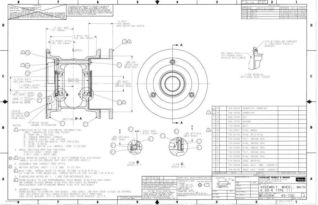

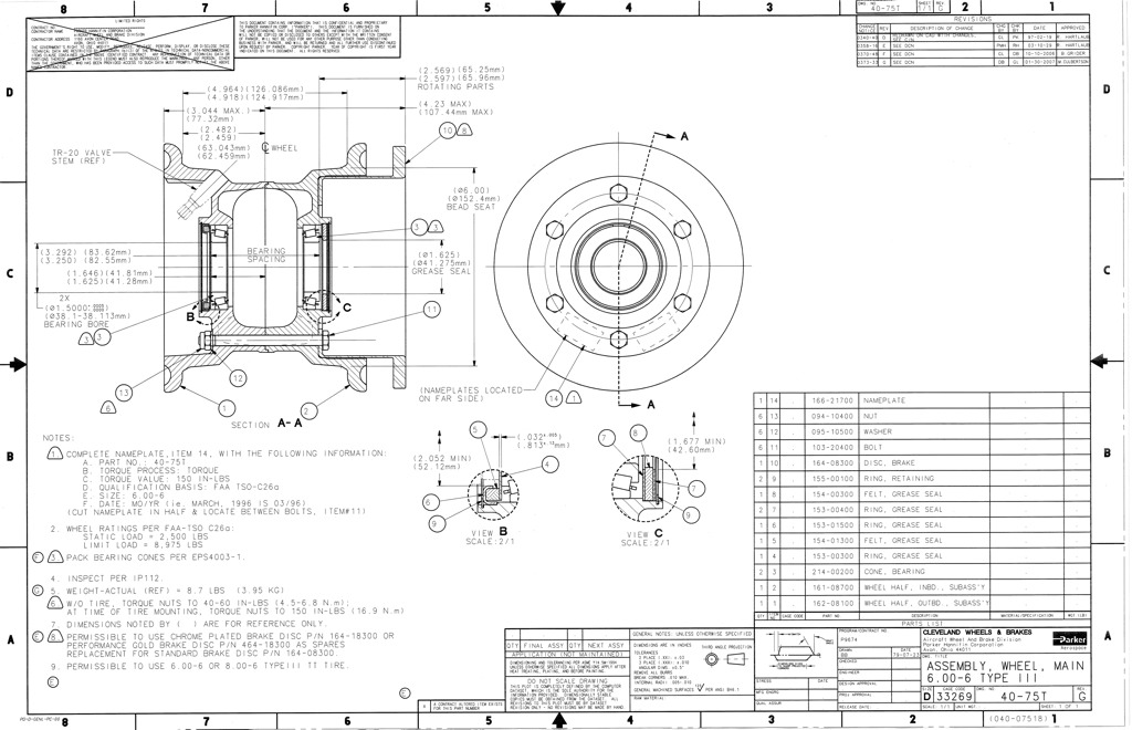

Just wondering if there are any other copies of 337 using 3 bolt wheels, Cleveland p/n 40-75D? The 337 PDF's I got from bcdpilot both are for 6 bolt wheels, Cleveland p/n 40-75T.

I recently talked with a guy at Cleveland Wheel & Brakes tech support. He told me that the load rating on the 3 bolt 40-75D is the same as the load rating on the 6 bolt 40-75T. He then sent me proof. Drawings of both wheels. Their ratings are on each drawing.
Marty
This is for the 3 bolt 40-75D
This is for the 6 bolt 40-75T
