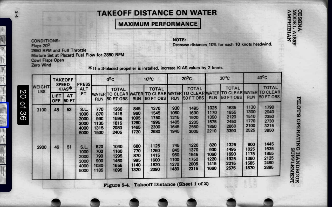

stinsoner wrote:Would a Maule make it?
I’d be hesitant to do it in my 185F not even fully loaded, especially if it was not wide enough to get some speed in the turn on the water
All admit I do have some long floats
