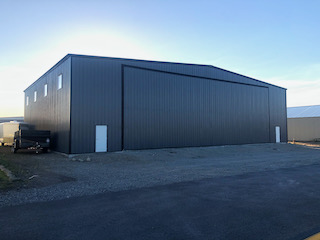

I just finished a 75x100 hangar. Didn't really need anything that big but figured for long term use, other future airplane desires and knowing that you can never have too much room I did it. I think a hangar is a terrible from an investment standpoint, especially built on land that I don't own, with the associated airport restrictions. But leaving an airplane outside seems even worse.
A few things I wish I did differently:
1) Maybe less of an issue during covid times, but I wish I had ordered everything earlier, took 3 months to get a roll up garage door that I didn't realize I needed until after the building was delivered.
2) I don't care for a bi-fold door. My neighbor has a hydraulic door that opens up twice as fast.
3) I haven't built any sort of bathroom yet but I wish I had planned that out before hand. It was a total after thought.
I did get remotes for my hangar door, and after using hangars for years where you had to "hold the button" to open it, it's so nice.
** Whatever you do I would not do business with RM Steel of Caldwell, ID ever **
