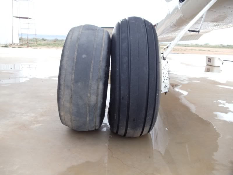

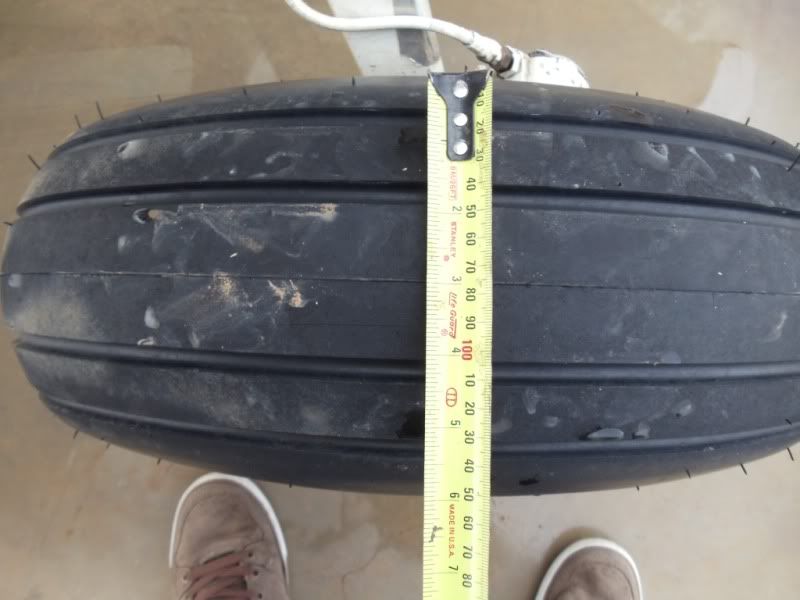

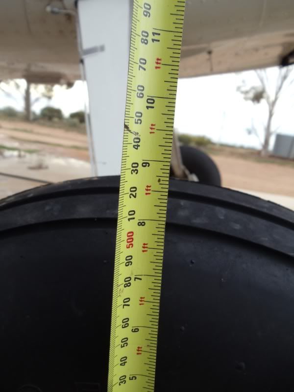

Hey all, finally got the new rubber, ended up going with the super hawks. What a difference! Thought it was worthy of a few photos..
22 inches in diameter
800x6.00 vs 850x6.00
Happy with the results
