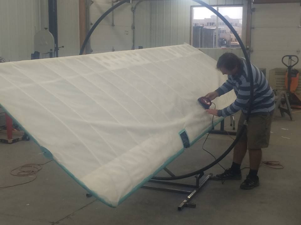

Ok...more than a day or so, but I've got a few minutes so figured I'd post a few more.
One of the nicest things about Stewarts System is the glue! You have time to work it, unlike the MEK based glues used in other systems, and it also is much much stronger. The added time is really nice when you're doing the window channels and edges! You also have a built in "tack" system as the adhesive is brushed on and let tack up before you mess with putting fabric on....really handy!
You're never going to have a problem with fabric separation on these window channels!

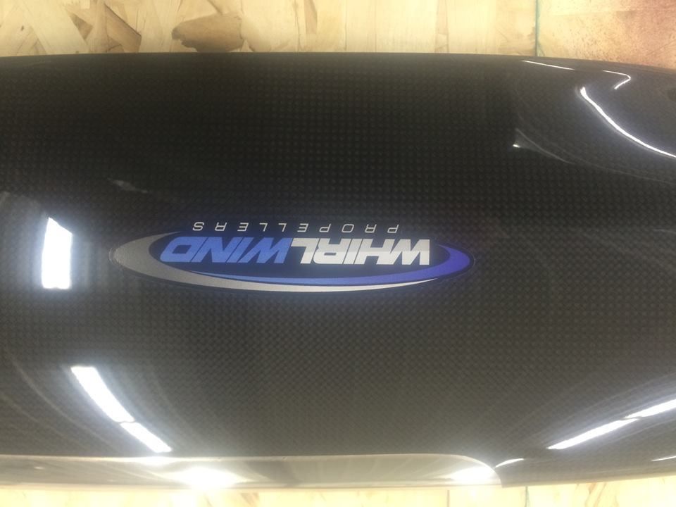

And in continuing with the lightweight build...here's his prop that arrived while I was there.....NICE!

A little PS on my posts above....
I've been covering airplanes for over 30 years. A few years ago, one of my students in a covering class, suggested using a "ski wax" iron to me, when I was explaining the importance of close tolerance temperatures for fabric shrinking. I thought about it, but just couldn't pull the trigger on buying one of the $70+ irons that I kept seeing, as my old "Black and Decker Classic" was doing an ok job....or so I thought. When I was talking to the owner of this airplane, I was telling him about the ski wax irons, so he went out and bought a cheapie. It is AWESOME!! When you set it to 350* it's THERE!!! It's not wandering from 340 to 355 or anything...it's within just a couple degrees of what you have it calibrated to!! I'm totally impressed and am buying one for myself!! The "classic" style irons still have a place, and that's getting into a tight corner with a metal panel behind, as your small detail irons just don't have enough "punch" to carry the heat to that spot...but I'm not wasting any time shrinking with them other than that. The ski wax irons are light, have a great sole, are very precise, and worth every penny!!
