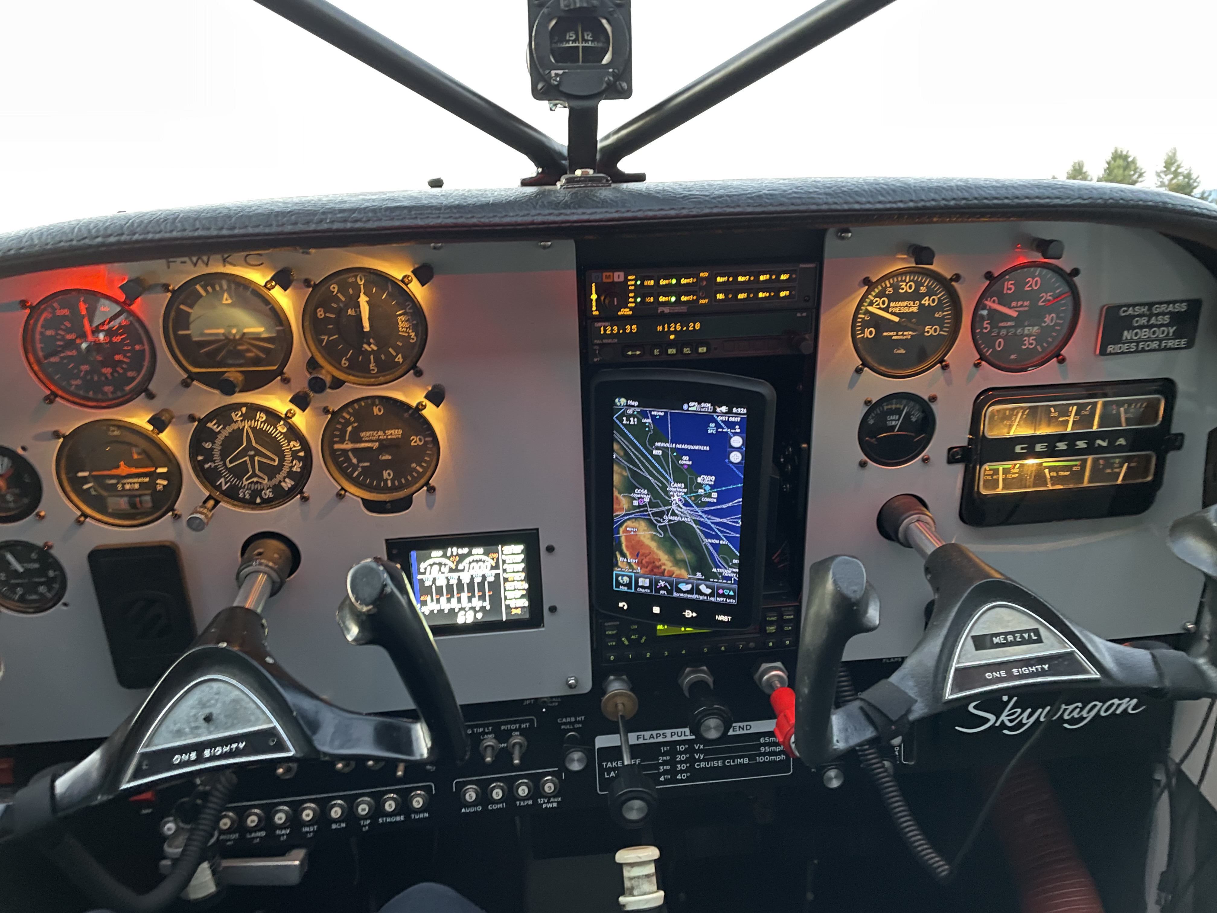

I’m trying to add a com 2 and will need to free up a radio slot space. I have a Garmin 796 in the middle of my stack and like it there. Ideally removing my transponder and making it remote. But I am only aware of the AV30 option for remote ADS B. Any suggestions?

A lot of dudes are removing the heavy vacuum systems and adding the AV-30C and TailbeaconX. Some have dual AV30’s. Pretty slick. UAvionix are coming out soon with a WiFi connection that allows Bluetooth traffic and wireless software upgrades.

You have lots of space without the old “portable” GPS on your panel, replacing it with a iPhone or iPad with foreflight that you could stow when not needed. I did read you wanted to keep it, but just sayin’
I’d limit your search to 978 units with an anon mode for 1200 if you really need to go ADSB out. But for remote don’t think there are any/many 978s
There is also this, but it’s 1090 so you’ll have the safety and security problems inherent to that system
If you installed a GTN650 as your second radio you could go with a remote mount GTX345
https://www.kitplanes.com/garmin-unveil ... nsponders/

If you can, replace the existing transponder with a GTX 3X5 and be done. If you want remote, do as has been suggested and go G3X or 650 with either the 335 or 345 in the tail. FWIW… all though its “frowned upon” by the Man, there is no reason you cant remotely control a 3X5… You dont “need” an “R.” Garmin makes it so easy now… just one HSDB (ethernet) cable, power and ground. You also get a side benefit of a txp antenna in the tail that isnt shadowed by bushwheels.
And if cash is a factor, than just go TailBeaconX and AV30. If your VFR only and understand that none of the info is reliable, than it checks the “official” boxes to get you in the air.

I have 2 AV30s and a TailbeaconX in my 185 VFR panel for a couple of years now. The DG was terrible, the attitude display was not up to snuff for IFR confidence. Notice I used “was,” not “is.” Via firmware updates and a magnetometer, the DG “is” rock solid and the attitude “is” basically perfect. I have absolute confidence in the AV30s for the transition to an IFR installation when I install the GNC 355 and the AV-HSI. The TailbeaconX has been flawless. Uavionix is innovating at a good pace, as they said they would, this is nice to see. It’s not Garmin, and I’m thankful for that because Garmin has monopolized the market which is never good for competition. I have plenty of Garmin in my life and I really like all of it, it’s just nice to see somebody else entering the fight. Regarding the AV30s and TailbeaconX, a previous post said that “none of the info is reliable,”. Wow, really? This is an observation that I disagree with.
