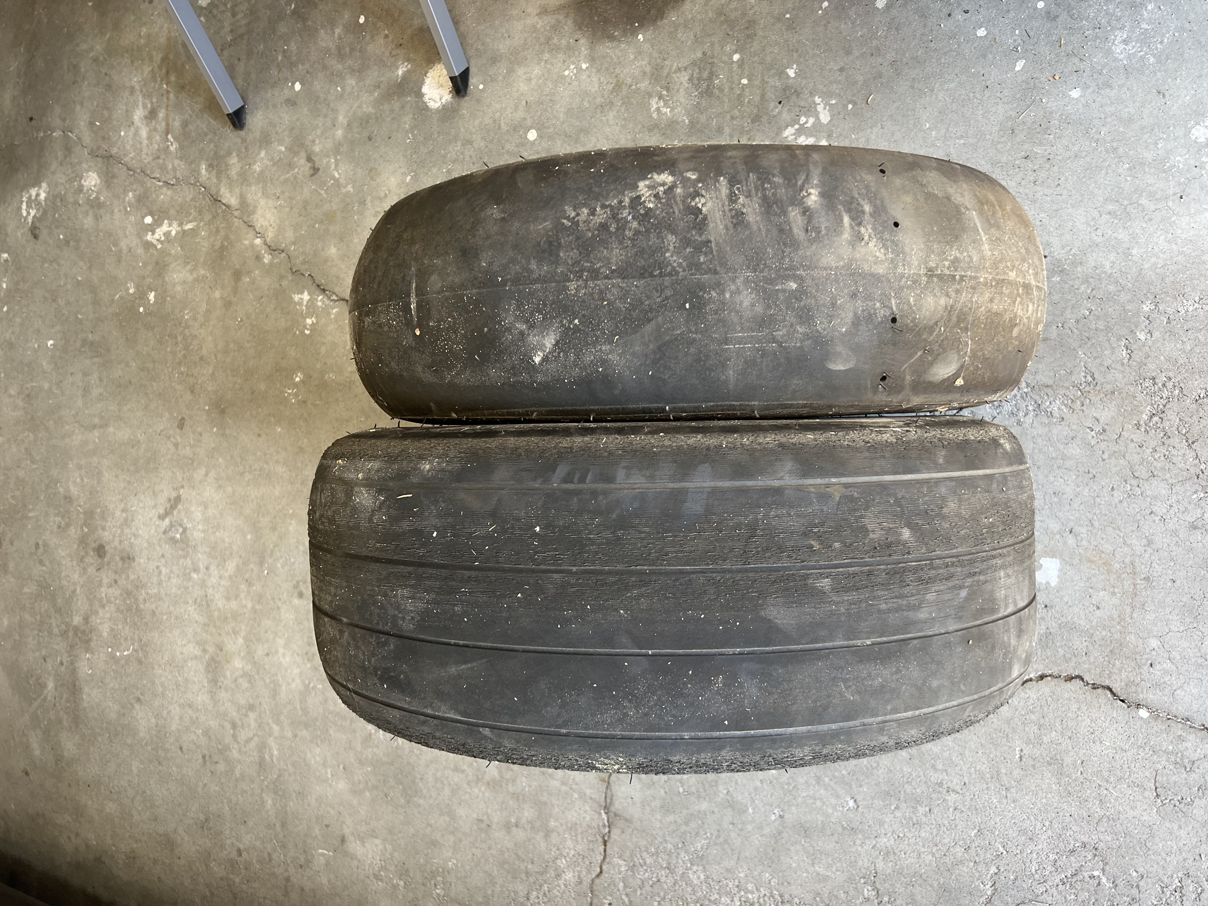

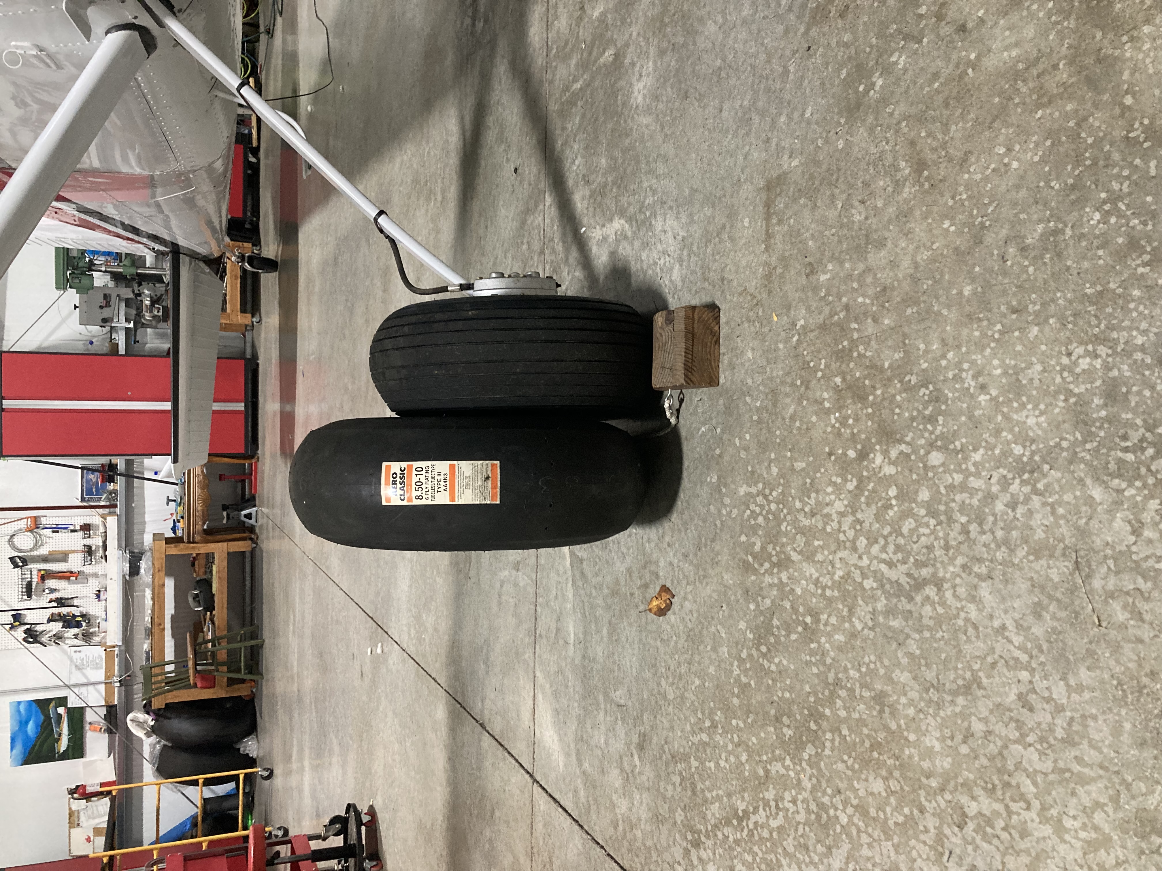

Re: Aero classic 8.50x10 tundra
My tires aren't the smooth Dessers, they are the standard 8.50 X 10 treaded tire. But, here is a comparison photo of that tire, mounted on the Airframes Alaska 10 X 10 wheel, next to an inflated and mounted Goodyear 8.50 X 6 tire. As you can see, there is a substantial difference in diameter and width.
The Desser smooth 8.50 X 10 tires cost more than twice as much as these tires do....$475 each last I checked, and they state they are approved on 8.50 X 10 wheels. Doesn't say only, but.....
I really like the 10 x 10 wheel with these tires, it spreads them out for more contact patch.
In any case, I don't know where the numbers came from in that tire reference, but you can see that these are quite a bit larger in diameter than Goodyear 8.50 x 6 tires.
mtv wrote:My tires aren't the smooth Dessers, they are the standard 8.50 X 10 treaded tire. But, here is a comparison photo of that tire, mounted on the Airframes Alaska 10 X 10 wheel, next to an inflated and mounted Goodyear 8.50 X 6 tire. As you can see, there is a substantial difference in diameter and width.
Thank you, this is helpful. I’ve also got the airframes Alaska 10x10, but it’s currently got 29 air hawks on it. I really want to like the air hawks, but it took 3 tires and 700 dollars in labor for them to get it right, and I’m still not totally happy about the situation. On the first set one tire was perfectly balanced, and the other one needed over a pound of weight to balance it. The warranty replacement was worse than the first, and required about a pound and half of weight to balance. The third only needed 5oz of weight, so to me that was acceptable, but the tire still vibrates my plane on takeoff like it’s out of round or something. I’m aware that some of this is because that wheel/tire setup is heavy as hell, but at this point it’s hard for me to trust that it’s normal after having gone through 2 warranty replacements within a few weeks of purchasing them.
mtv wrote: My tires aren't the smooth Dessers, they are the standard 8.50 X 10 treaded tire. But, here is a comparison photo of that tire, mounted on the Airframes Alaska 10 X 10 wheel, next to an inflated and mounted Goodyear 8.50 X 6 tire. As you can see, there is a substantial difference in diameter and width. .....
Those 850x10's look like a great tire for the 180, I'm curious as to the outside diameter of one when mounted.
FWIW 850x6 GY's seems to come in around 22" or a bit more, & 850x6 Airtracs seem to come in at about 21-1/2" or a bit less.
These are about 25 to 26 inches diameter inflated. I’ve been impressed at how much “softer” they feel than the 8.50 x 6 tires. Certainly not Bushwheel soft, but it’s noticeable, especially on my landings.

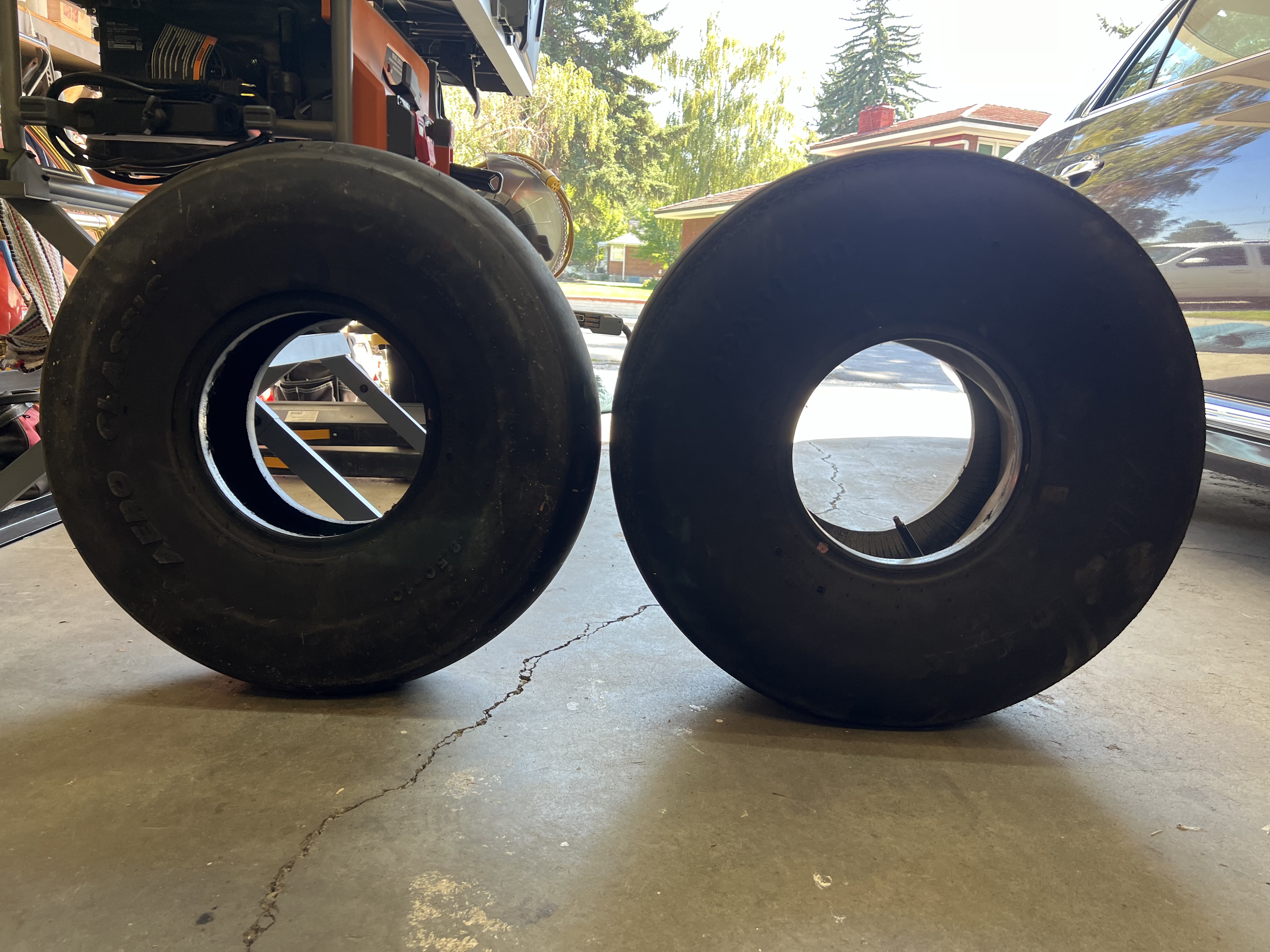

I had 850x10 Dessers on for a bit. I really like the size. Unfortunately the rubber failed and Desser wouldn’t warranty them. Said I was running them at an “extremely low” air pressure and that they must be inflated according to the TSO. I can’t remember now but I had 20-25 psi in them and the TSO calls out 42psi or something crazy.
I’m on AirHawk 29s now and like them so far. Height is pretty similar but the AirHawks are much wider.
Have Grove 10” wheels and brakes on both my Bearhawk Patrol and Cessna 185. The Bearhawk has smooth desser 31s which have been wearing like iron for 4-5 years now. I just put the desser 8.50-10s on my185 about 8 months ago. So far, so good. No loss of speed that I can tell (had 8.50-6s). They were affordable at $375/tire. Again…so far, so good. I really like the 8.50-10 size for a Skywagon. They’re considerably larger than 8.50-6. For me, it’s perfect.

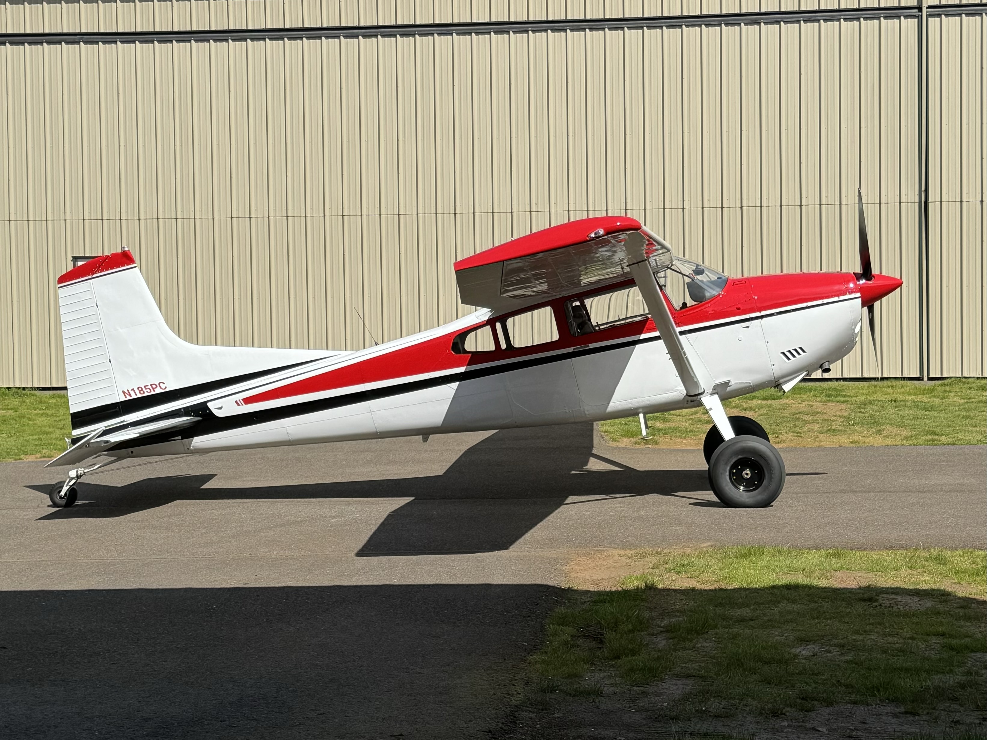

Here’s my 185 with the Desser aero classic 8.50-10s
