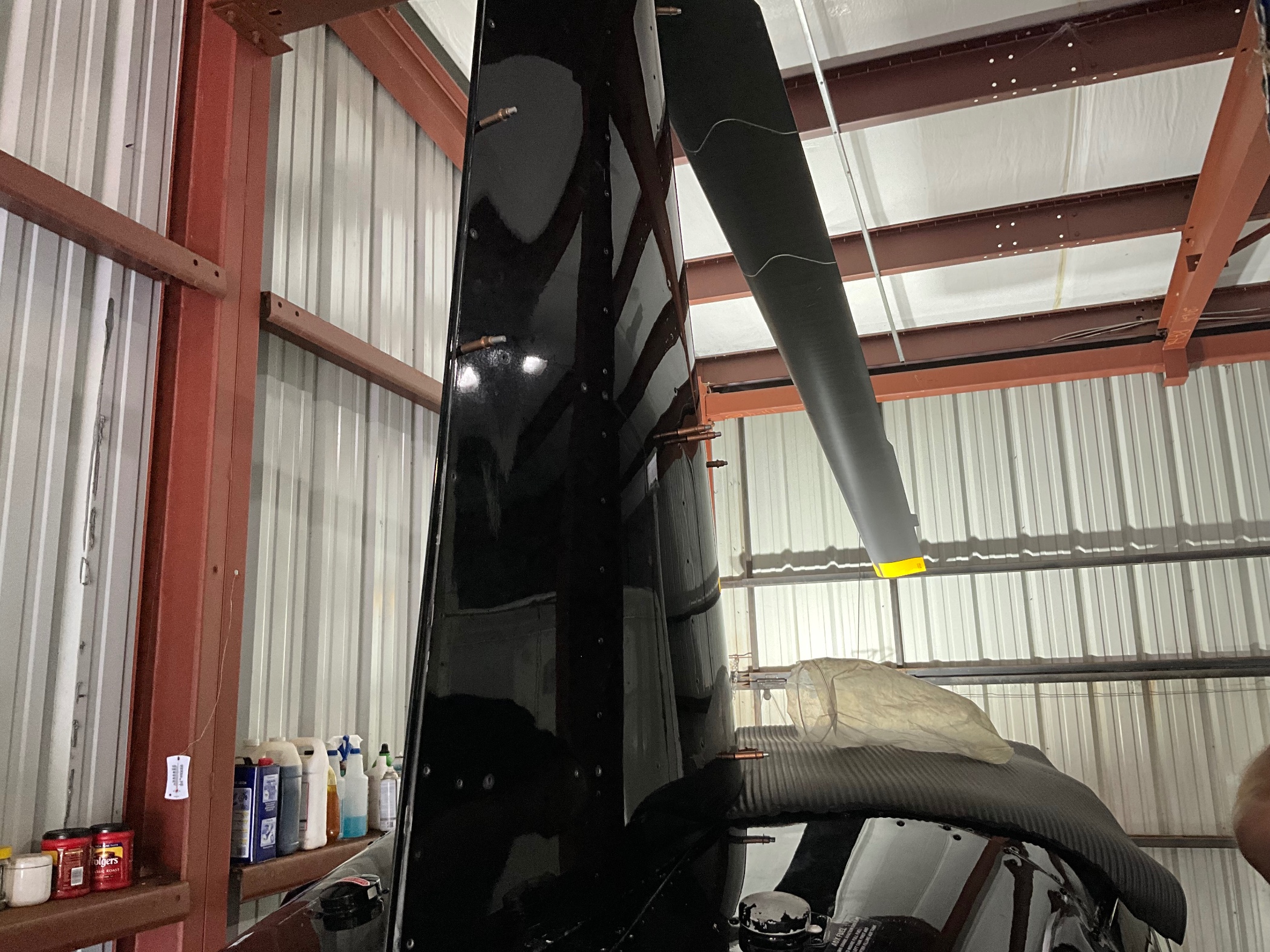

The aluminum mast fairing (2024T3 Alclad) has quite amount of “preloading “ . The fairing can snap open (during inspections) which could damage the helicopter or hurt someone if removed incorrectly.
Luckily, one of the primary mechanics who assisted Frank Robinson assemble R44 serial #1 circa 1990 (almost 36 years ago at Torrance Airport) is here visiting me this weekend and assisting with various inspections. Great guy to have help with the nuances of the ship.
I learned a little trick today: use clecos (interlaced with the primary machine screws) when removing and or installing the mast fairing.
Copper colored clecos 1/8” :

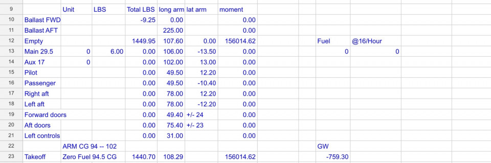

Revised W/B to be entered in cabin POH and Maintenance Records 2026.05.22:

Note: the reason the W/B was revised is because we removed fixed ballast (9.25 lbs) in the nose which was no longer needed.
