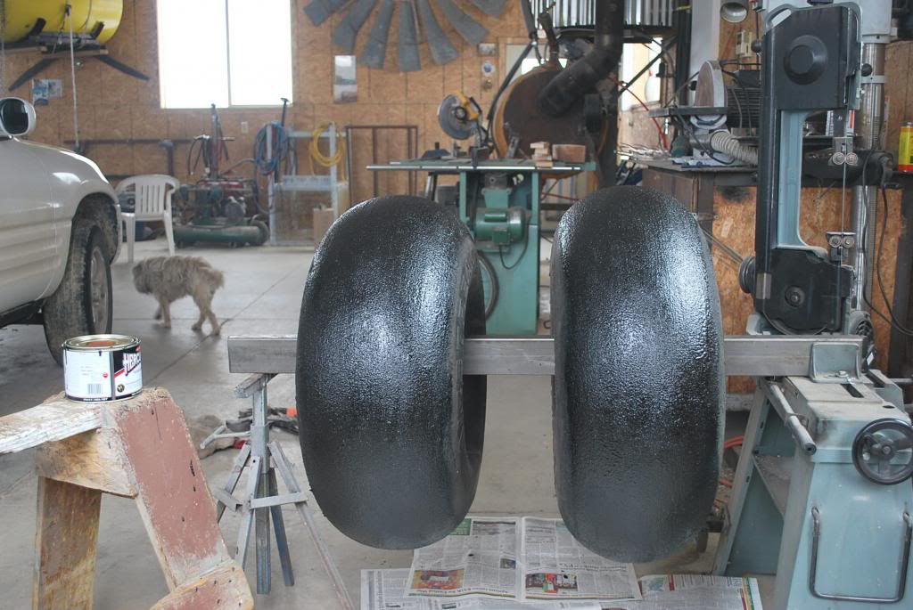

I am not complaining, first off, it costs 40 bucks and the tires are off anyway, with the skis on. My third coat, HERCULINER being the brand of choice (fuller bodied then other brands it seems, available anywhere) Two coats a couple days apart, uses up the can, which is the idea, the stuff doesn't store well once opened, I have a feeling. I don't bother with putting it where the worst wear isn't, way down on the sidewalls. I also, after the initial application, don't bother anymore with the whole Zylene cleaning process, just soap and water and a rinse. This stuff is real sticky, especially to itself.
Not for certified aircraft of course, or for those worried about their insurance company seizing on an unimproved mod to dodge a claim.
I seem to be getting about 100 hrs between coats, and I don't reapply until most of it is worn off. That's with less then 10 asphalt or concrete landings last year, even at airports I almost always land on the median or the gravel alongside the runway lights :shock: and of course as slow as possible. A bigger faster plane landing on hard surfaces all the time would no doubt have different wear patterns. I also give a lot of thought as to how and where I am going to taxi when at an airport, as little as possible is the goal. Kind of like protecting some expensive gloves with some cheap ones, I plan to continue this, there is no downside other then the 40 bucks every 100 hrs., and the tires definitely are protected a bit better. Most important , it makes me FEEL better when landing in rocky shale, like I'm doing all I can to save the tires. This glop and as low as pressure as possible short of the tire folding half on sidehills (been there) seems to be the way to go for me anyway. When and if I do wear out the tires or get a flat, I'll then limit my flying to only paved and towered airports. Ha ha.Image

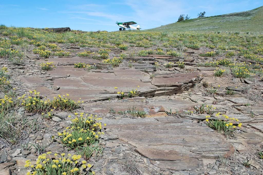

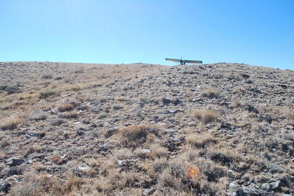

A takeoff area Image
A landing area, I made a point (pun intended) of missing the big ledge, but smaller ones were present, not a problem aired down. Image
