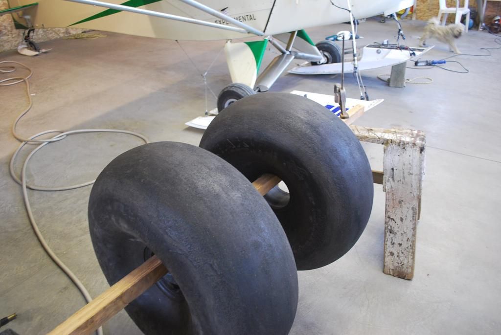

My third or fourth? Been doing it it for several hundred hours now. Not for you certified guys worried about your insurance company looking for a reason to call BS on you, experimental only. I get about 75 to 125 hrs out of a $35.00 can. I don't try and store it once opened, I use it all up. First coat light, (the brush kept in the freezer between coats, then thrown away when done) then 2 or 3 more heavy coats till the can is empty. I haphazardly try and apply it evenly but I don't get obsessed about it, the balance seems to be close enough for the speeds I spin them up at.
When the tires lose that Herculiner look, start looking like regular tires, it's time for a recoat.Image

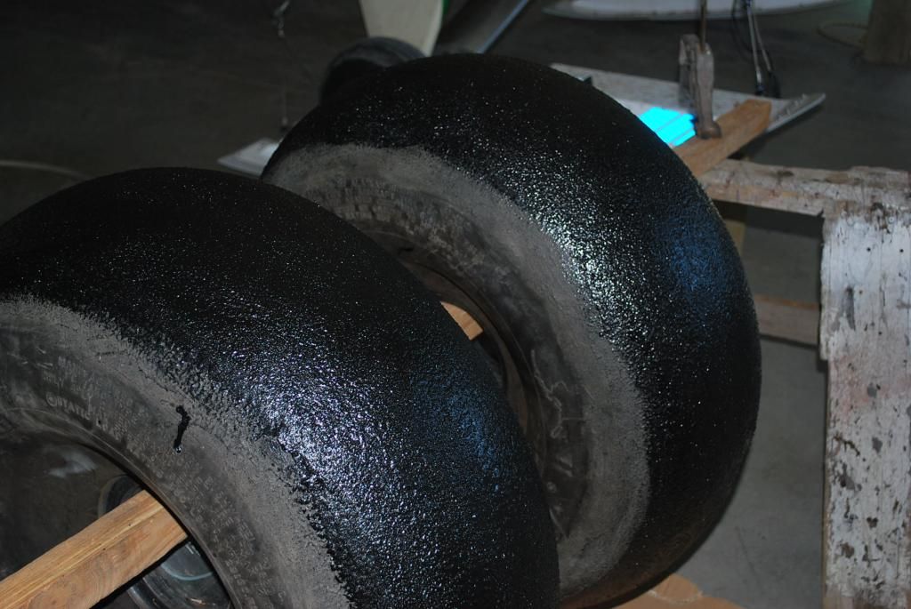

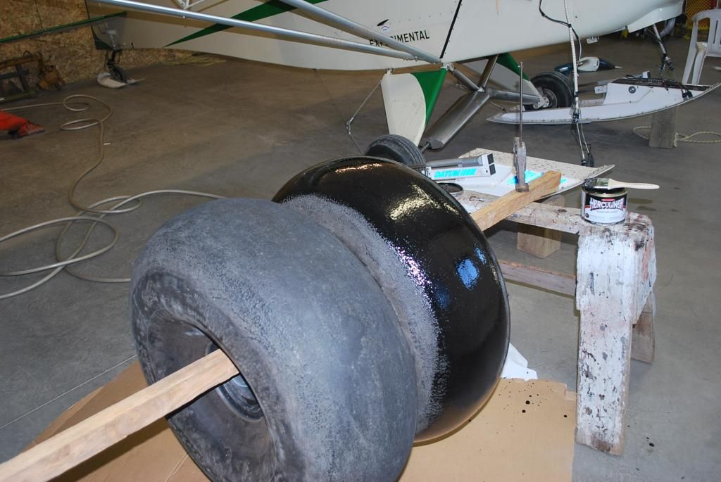

I don't bother with the sidewalls, I just hit the part that touch the ground the most. Once in use, dirty that is, any extra work keeping it perfectly lined up along the edges is just wasted effort, I've never had anyone tell me my tires look like crap anyway :shock: This is the thin fiImagerst coat, after of course a soap and water brush clean. I'll post a picture in a few days with them both finished out. I got tired of wishing for snow, screw it, I'm getting ready for summer even though it's early Febuary #-o
