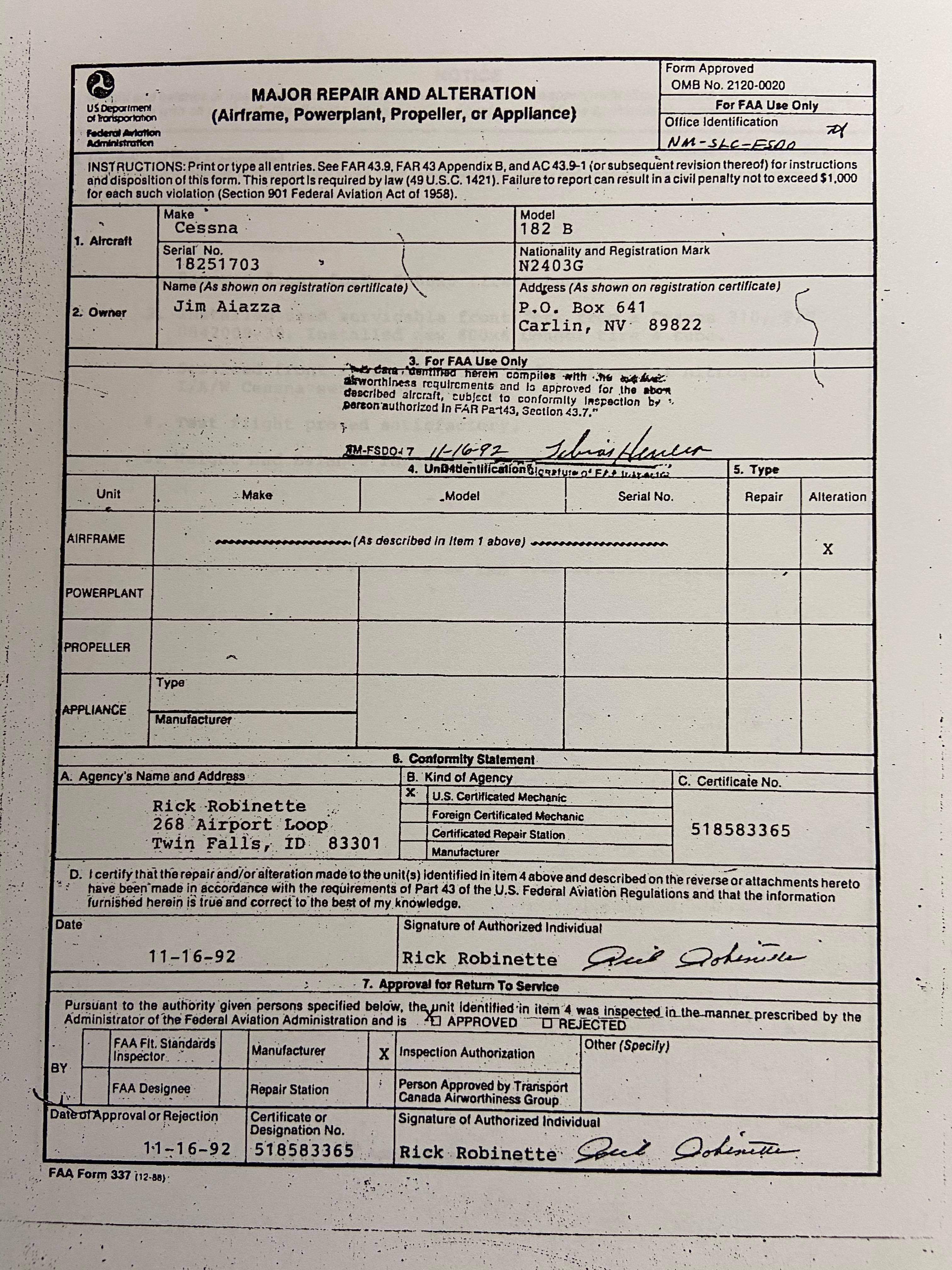

Anyone, 337 form for heavy duty nose fork on early 182?
I am looking for someone willing to share there 337 form for installing the heavy duty nose fork on an early 182. Mine is a 1960 182C. But even the form for a 182A or B would be helpfull. I think if I have something to go off of; I can get this sorted out locally with my IA. I know Airglass has an STC'd product for this. I would like to do the factory heavy duty fork if possible. I have searched all over for this info and could not find anyone to share there 337 form yet. Thank You, Ken

I have a 337 for my B. Still need one?

Attached

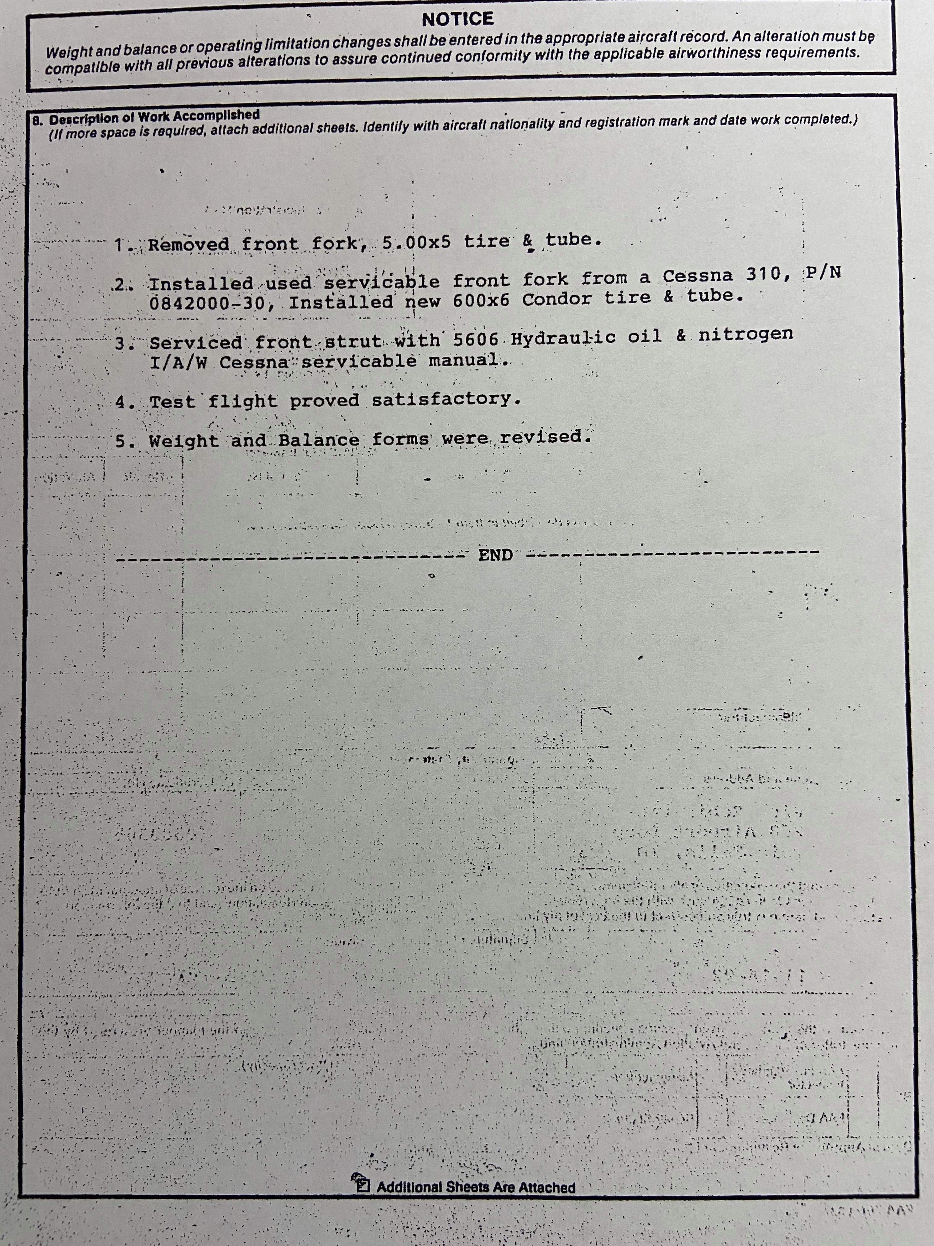

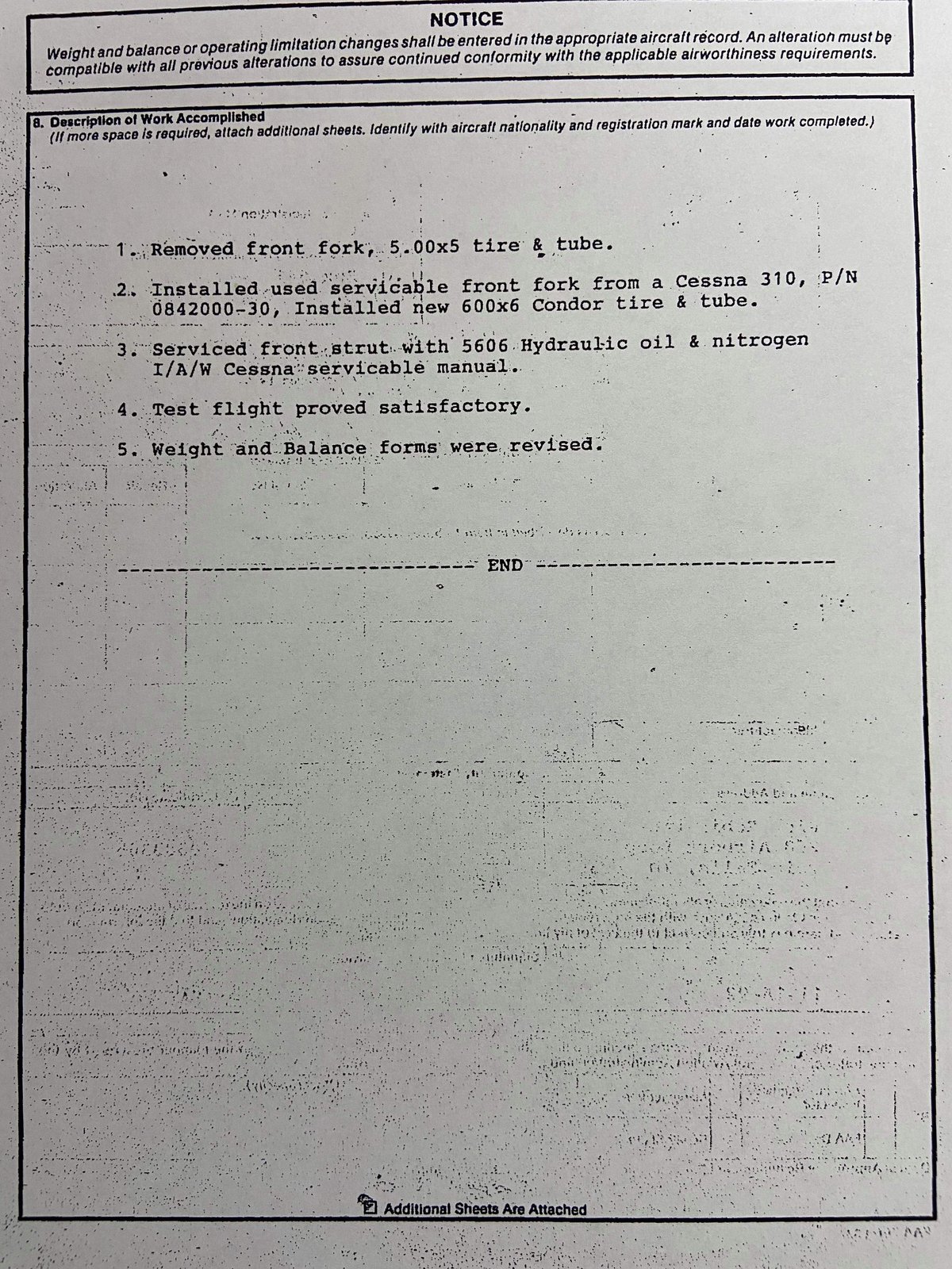

Do you have a picture of the back of that form? Where it lists out what was done? Thank You, Ken

Back side attached
