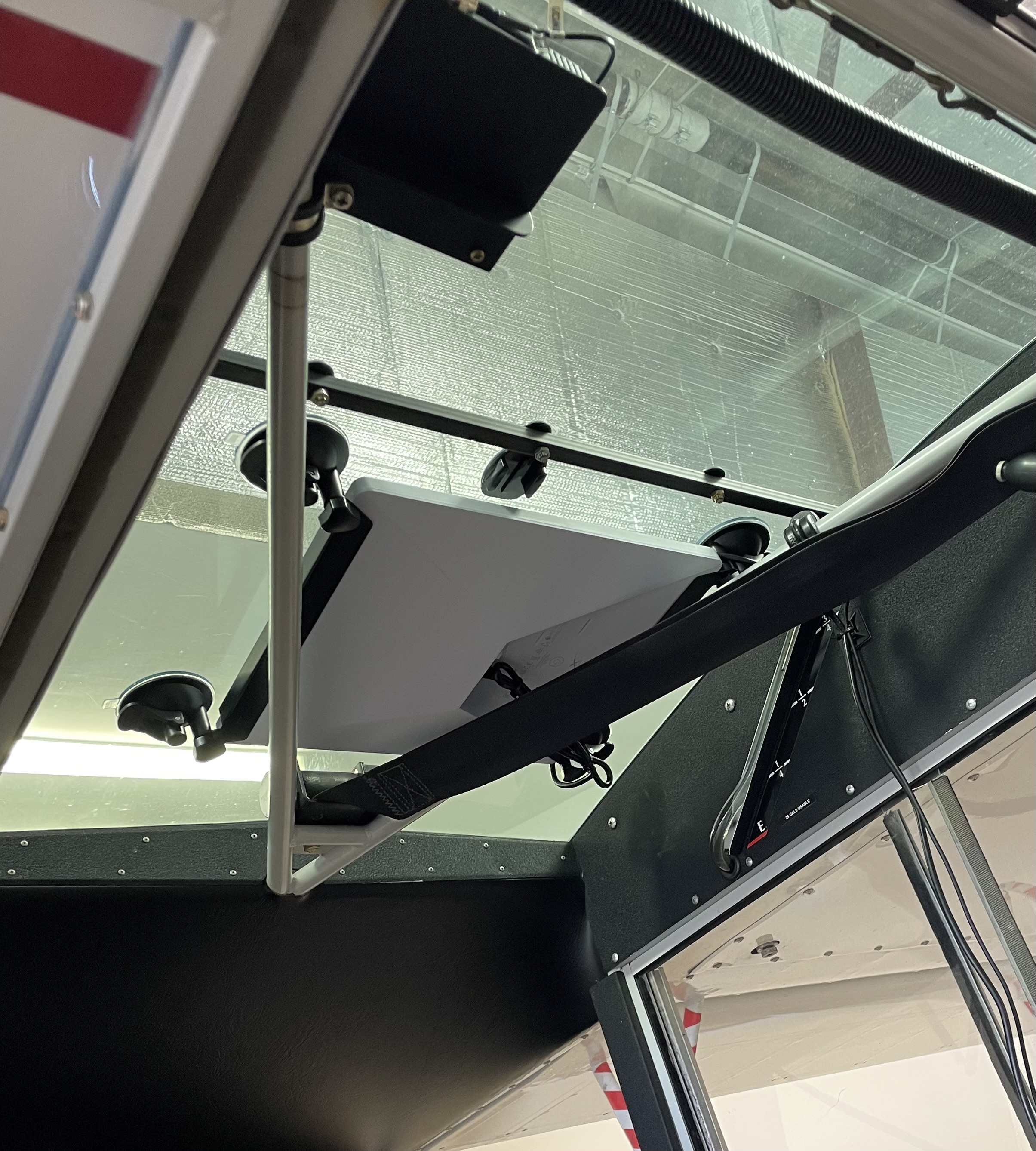

The big game changer for me is the Starlink mini. I was able to mount it cleanly in my Husky and can get crazy fast Internet speeds just about anywhere. Not only does that open up numerous options for displaying weather data, the available products are far, far more comprehensive than XM. Best of all, my Garmin portable can connect wi-fi and access Internet weather so I don’t have to fiddle with any other gadgets.
And it CAN be relatively cheap. The high speed monthly rate is about the same as XM but when you put the service on standby at $7/month CDN you still get 500 kbps bandwidth up and down. That’s enough to feed weather data to my Garmin or Foreflight, and plenty to support a voice calls on my iPhone. That’s 1/10th what XM costs me, so I’d call that good value.
Long story short, seems like a great safety enhancement when I’m camped on some remote lake shore north of north.

Excellent information on the Starlink Mini. How obtrusive to visibility is mounting of the antenna? Even if you were to simply use it on the ground, at that price, it'd be a great device for backcountry camping.

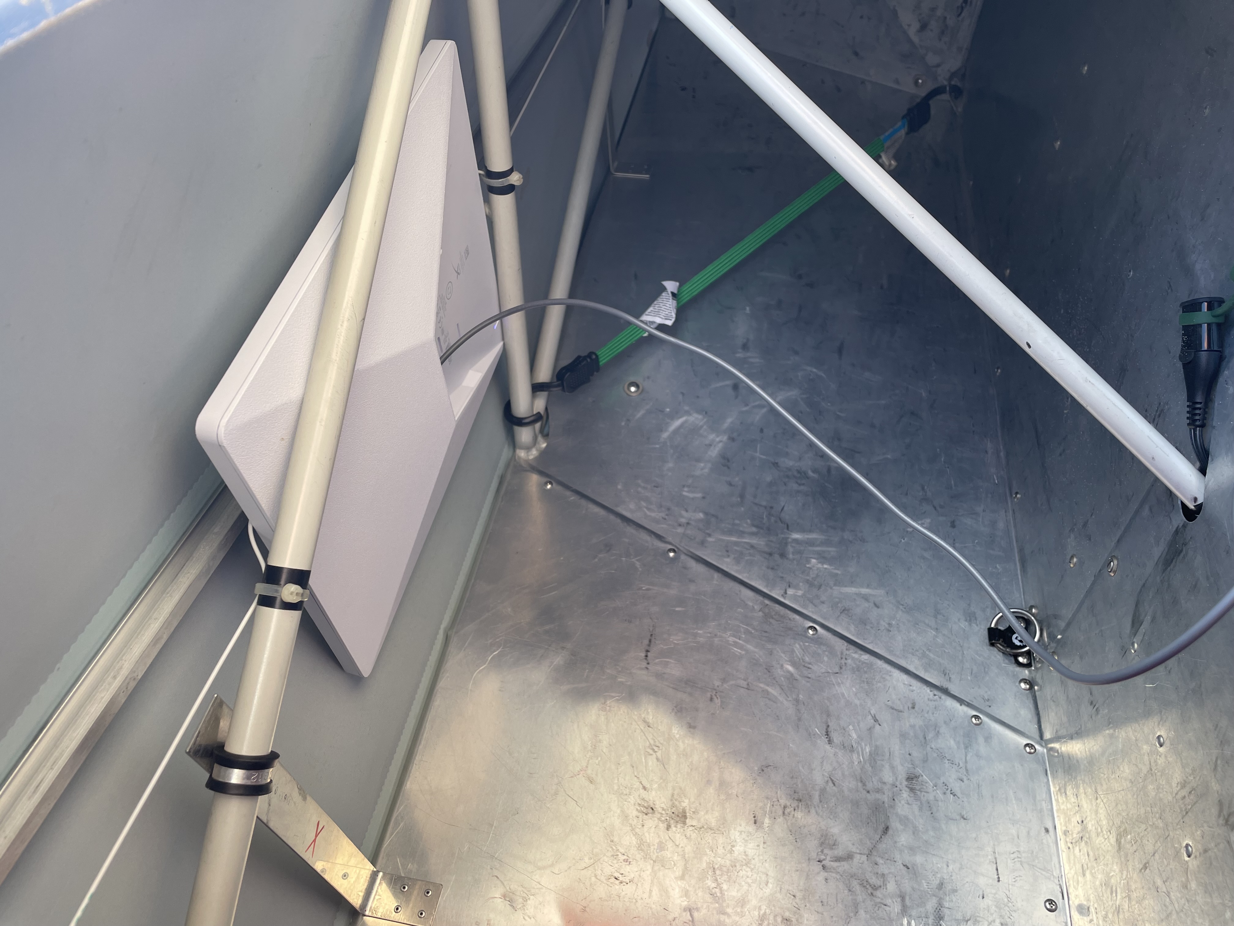

Not obtrusive at all. I have as far aft under the skylight as possible and my passenger never notices it there. In the next few weeks I’ll be moving it to the rear baggage area. I’ve tested it through the fabric and it has no noticeable impact on performance. It requires a 110 degree view of the sky so maneuvering in canyons or low in valleys I’m sure it would cut out, but that’s the last place I’d be fiddling with anything so not really an issue.
If a person intended to use it on the ground for more than a few minutes you’d probably want to bring an alternate power supply. It draws about 3 amps for a minute or so on boot up, then about 2 amps continually so if you thought you were going to watch Netflix while camped beside your airplane you’d likely be hand-propping the next morning. But for 5-10 minutes to view some weather data or make a phone call I’m sure it would be fine.
