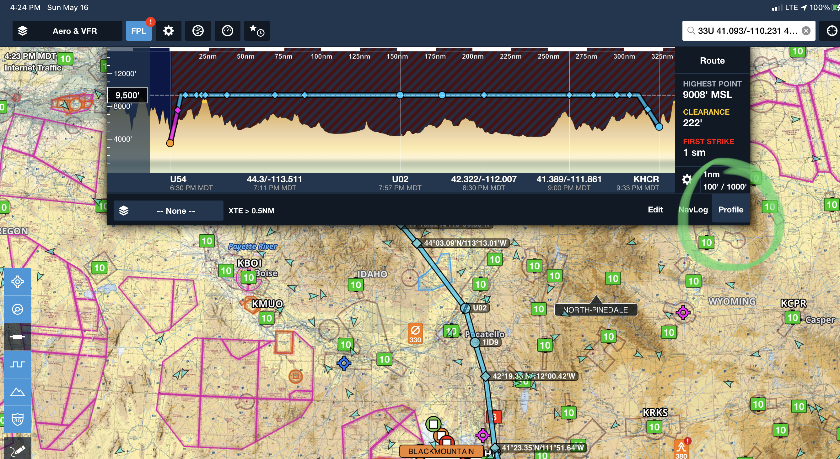

I live in the mountains of Utah and make flight plans all the time using FF and the “Profile” function in the flight plan area. I assume if you have the most basic subscription of FF that does not exist. My take, if you are going to fly in the mountains the $99 per year is worth that aspect of FF alone.
Personally I would not trust someone else to flight plan for me through mountains.
Takes me about 5 minutes max to make a plan from KHCR to anywhere in the Church with the use of profile.

Here is a good example
